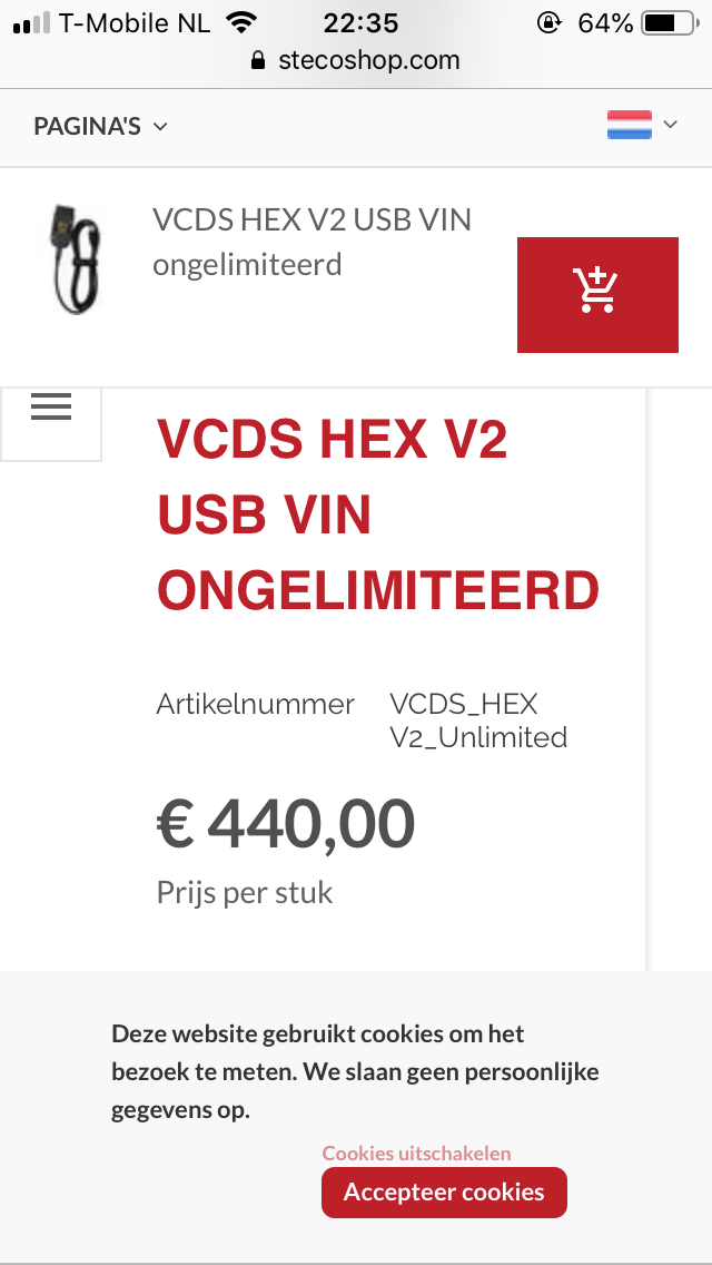

I guess so. A new hex-v2 unlimited vin costs €440. I know its cheaper at rosstech. But than custom fees apply. Also i am now cableless and a bit impatient.
I just use it to play with my car and love tinkering with it. Love some of the mods i’ve done. I know about VCP. But now that i am used to vcds i decided to stick with it and cough up the extra euro’s needed.
