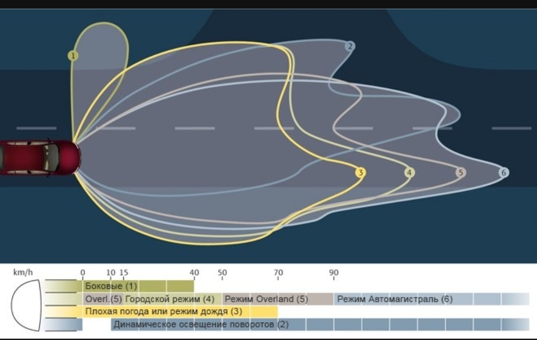

Left headlight (lhd car) dips a little more after certain speed and goes back and perfect level with right headlight at very sloow speed.
I get it,is for safety resons I guess but is there any coding for not doing that?
this is how the afs system works, outside the city everything shines well

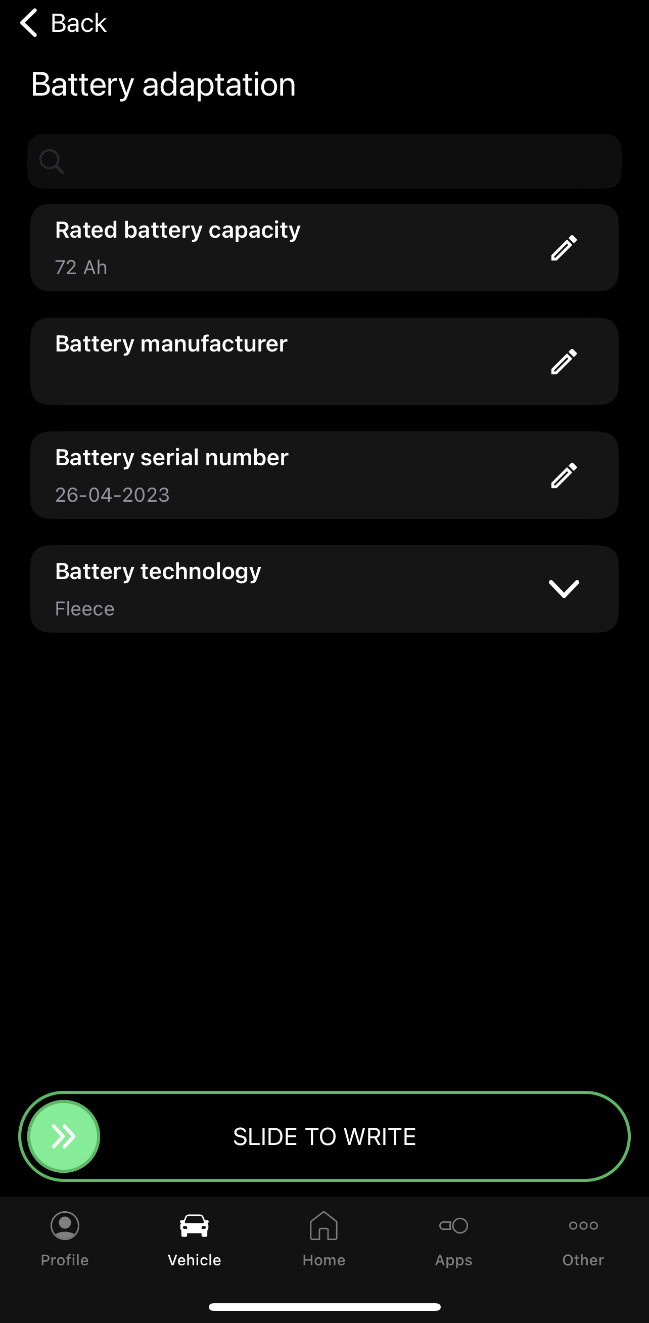

They told me that they did battery adaptation. In OBDEleven I see it like picture I attached. Is it correct ?
Installed battery is Exide EK720 72 Ah 760 A
Battery replacement was 26.04.23 and OBD tells me that battery charge condition is 75% and usable battery charge 50 Ah
That looks correct.
The battery state of charge usually hovers around the 80% mark if it's healthy.

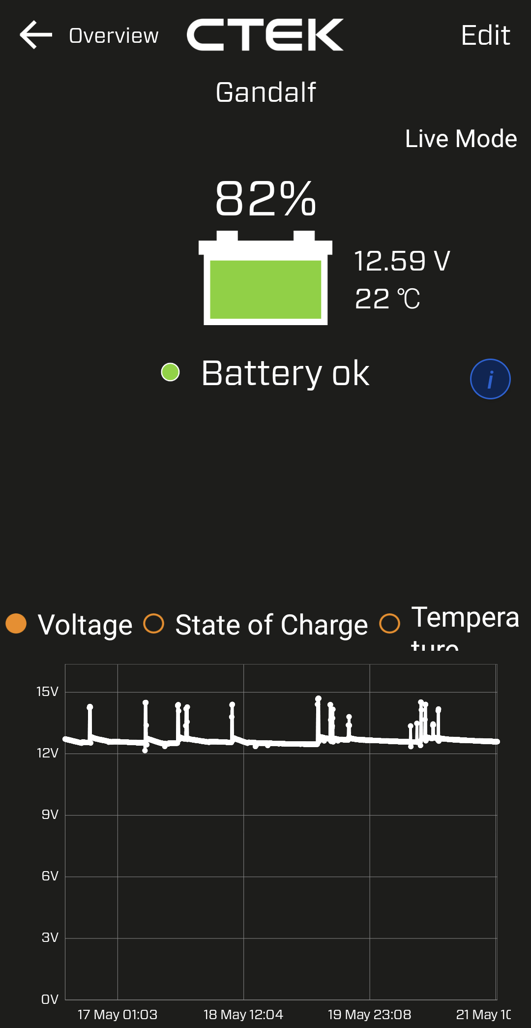

This is my almost 3 yrs old battery, showing state of charge, voltage (engine off) and battery temp.
