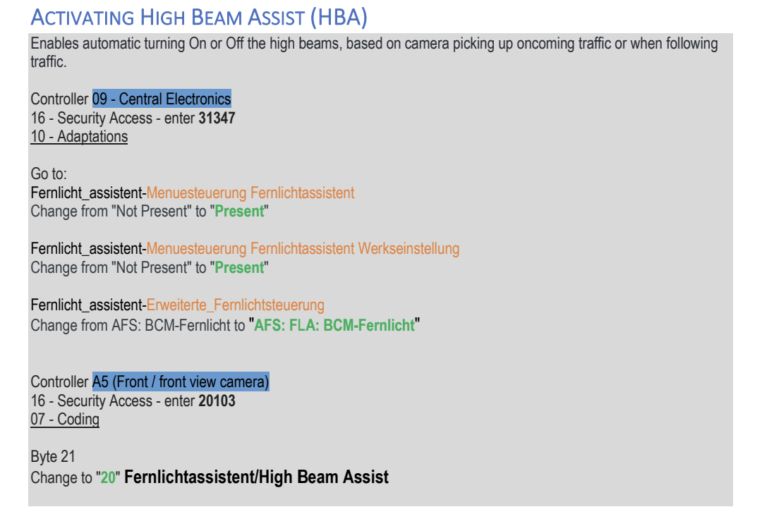

U can activate it using the instructions below, provided u have the correct A5 camera.....

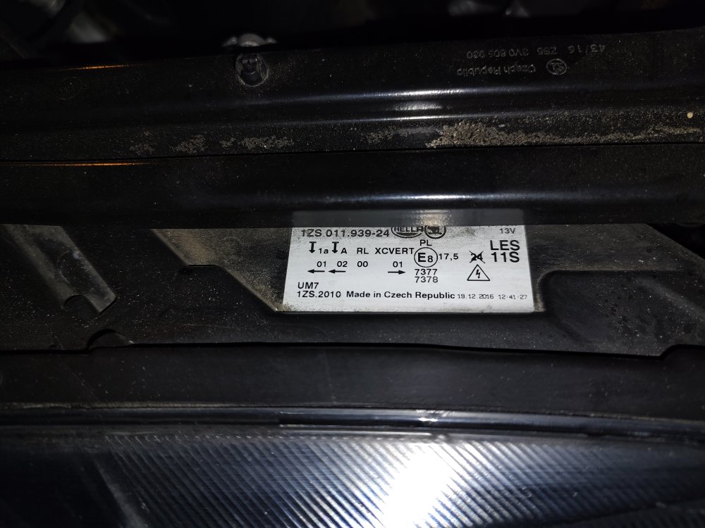

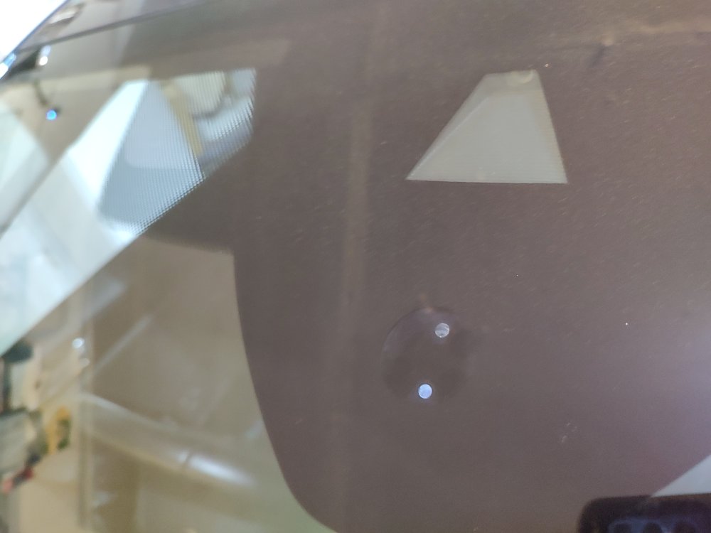

Hi,

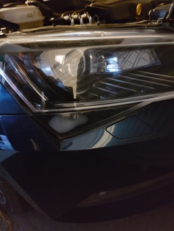

I want to turn HBA and eyelashes on if I can are you able to tell by looking at the pics if I have the camera/ lights to be able to do this?

Unfortunately no part number awarded.

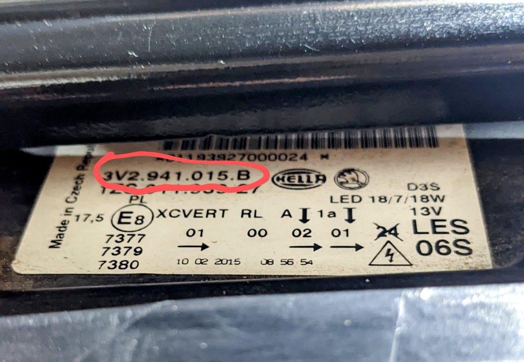

Part number must end with B, then DLA should be installed. So are the eyelashes.
Just turn on the low beam, the eyelashes light up as standard.

Ur camera looks right.
Headlights, as mentioned by @Lutz_91, we can't see the actual part number.
It should look like this.....
1858339398_Screenshot_20230305-1152242.thumb.png.caca4e3bc364822efbf11c1be948da0e.png

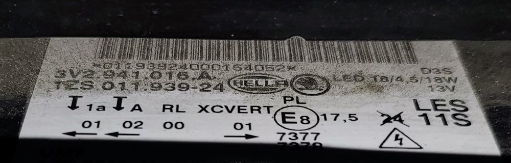

Mine ends in A so I'm guessing it's bad news
With "A" you have no DLA and also no eyelashes.

6 hours ago, Baggins said:
That's a shame, it's an L&K and does the light dance at start-up.
At least I know now, thanks.
That's a standard AFS thing for all Bi-Xenon headlights - up down left right calibration checking, at each startup, of the headlight motors.
If u had version B headlights (by the way, Skoda calls it SLA, not DLA), in addition to startup dance, it tests the rollers and makes a U-shape. See video....

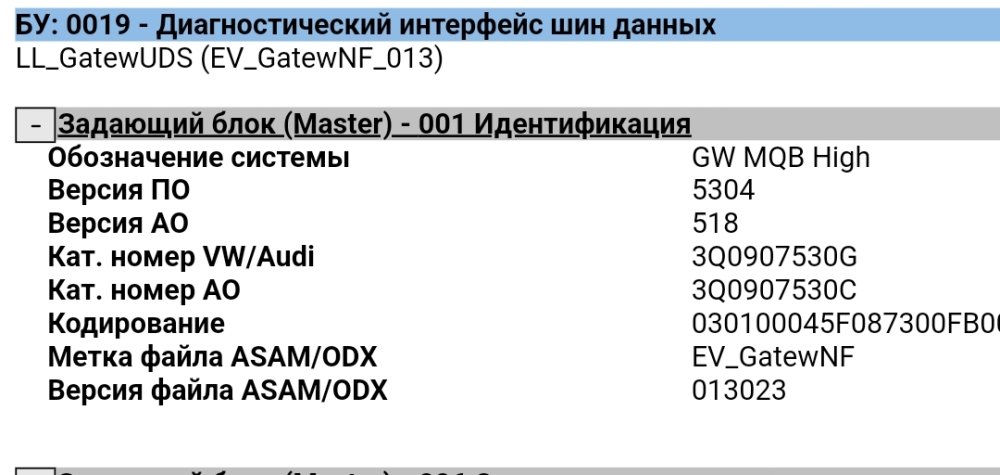

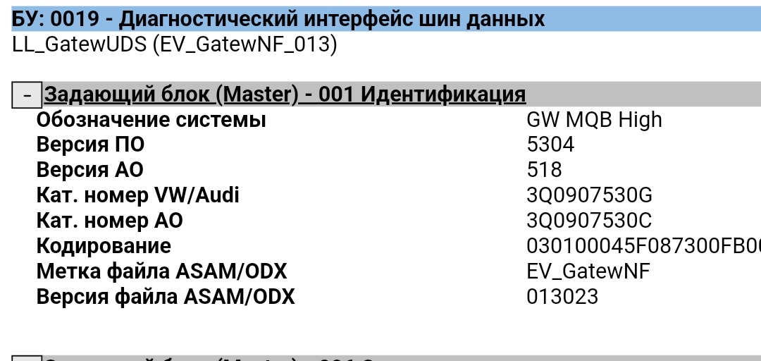

5 hours ago, langers2k said:
It's probably that your CAN gateway software is too old...
Unfortunately for me, you're right! My SW version is 3Q0 907 530 G (even older than you original version).
As I don't know how I could flash it, I'll bring everything back to original settings.

1 hour ago, Bap33 said:
@игрозан Можете ли вы просто сказать мне, что такое MY вашего Mk3?
Действительно, как@langers2k сказал, что мой может быть слишком стар, чтобы этот мод работал нормально...  🤔

14 hours ago, Bap33 said:
@igrozan Can you just tell me what is the MY of your Mk3?
Indeed, as @langers2k said, mine may be too old to get this mod working fine... 🤔
My Octavia is a MY18 with J as the 10th digit.
It had 10 colours from factory with these modules installed:
Address 09: Cent. Elect. (J519)       Labels:. 5Q0-937-08X-V2.clb
   Part No SW: 5Q0 937 084 CQ    HW: 5Q0 937 084 CG
   Component: BCM MQBAB H   H36 0253
Address 19: CAN Gateway (J533)       Labels:| 3Q0-907-530-V1.clb
   Part No SW: 3Q0 907 530 L    HW: 3Q0 907 530 C
   Component: GW MQB High   436 4326
This was not enough for automatic mode, I had to flash and parameterise the CAN gateway to become:
   Part No SW: 3Q0 907 530 Q    HW: 3Q0 907 530 C
   Component: GW MQB High   436 4344
It's been fine since :)

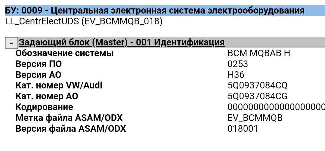

мои блоки
5 hours ago, Bap33 said:
Мой Mk3 был построен в октябре. 2017 и является MY2018. 10-я цифра VIN на самом деле J.
Но@langers2k сказал, что мне может понадобиться обновление ПО, чтобы мод работал нормально. Или, может быть, я пропускаю шаг в режиме. Попробую еще раз или хотя бы посмотрю.
automatic mode appeared?
