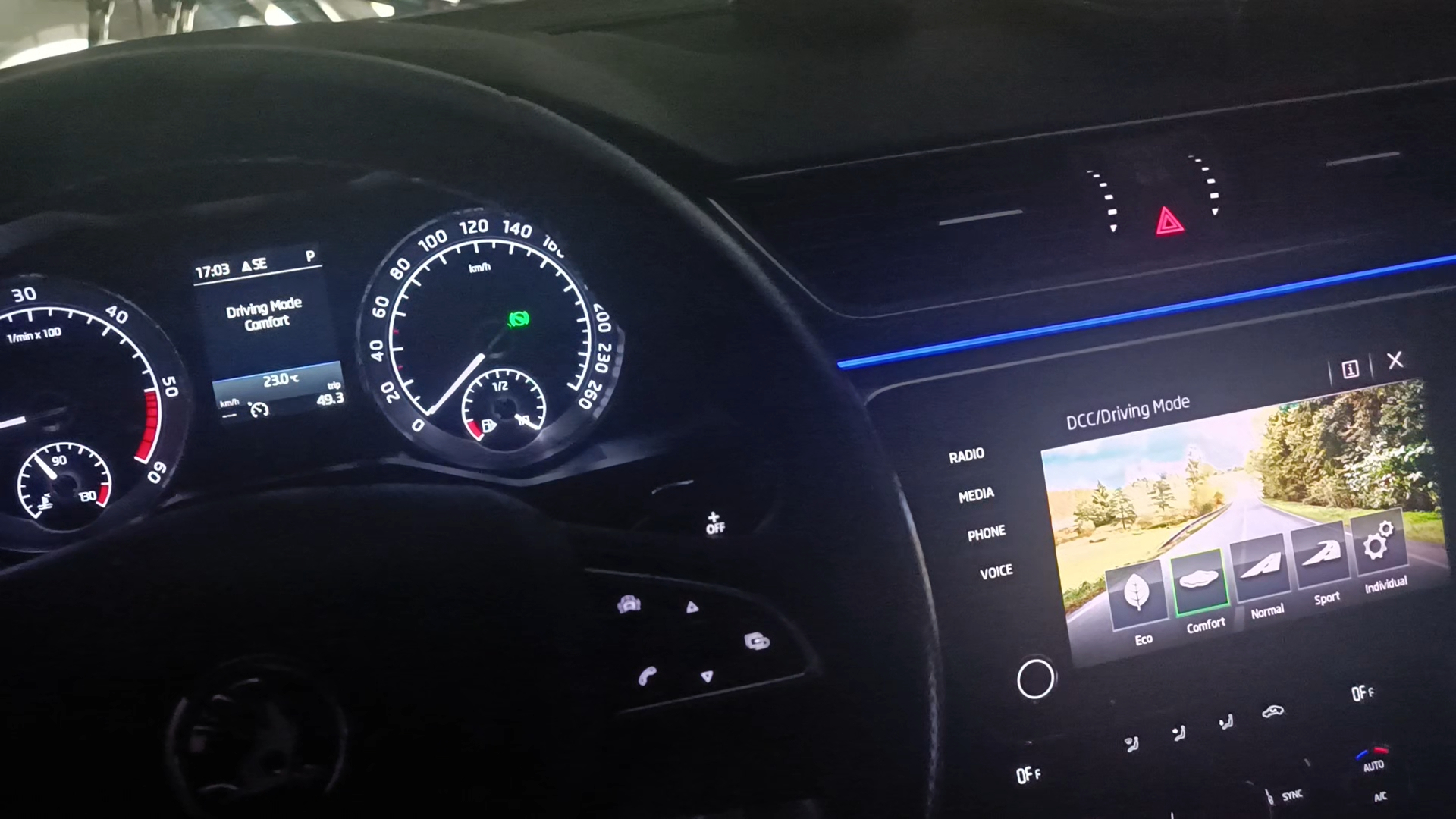

Hello,
I activated the change of the ambient lighting in the different driving modes. I want to ask how can I change the profile color to "Normal" from the menu.

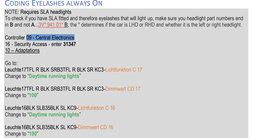

Hello,
Please for your help I enabled the following coding for DRL's & Eyelashes, but not without success.

1 hour ago, plamen_333 said:
Hello,
2113151656_Screenshot_20220427-1824002.thumb.png.f609ed594c57f5c57b330f2cb1c5aa44.png
U need to have version B headlights, otherwise the eyelash coding won't work.
Have u checked this physically?
Those r instructions I created, and I've clearly stated that u need Version B.
@JR RS I can send you mines if you want to compile them. I have some more:
- Enable Ambient lights coupled with DCC Driving mode
- Enable Easy Entry
- Enable rain drops wiping on both front a rear wipers
- Activate Emergency Brake lights flashing (on brake bulbs)
- Activate Emergency Brake lights flashing (on direction bulbs)
- Activate fan blowing speed in AUTO mode
- Activate Off Road mode on Columbus
- Disable DRLs upon hand brake activation
- Adjust Autohold brake release (Early / Normal / Late)
- Adjust Corner lights deactivation speed.
