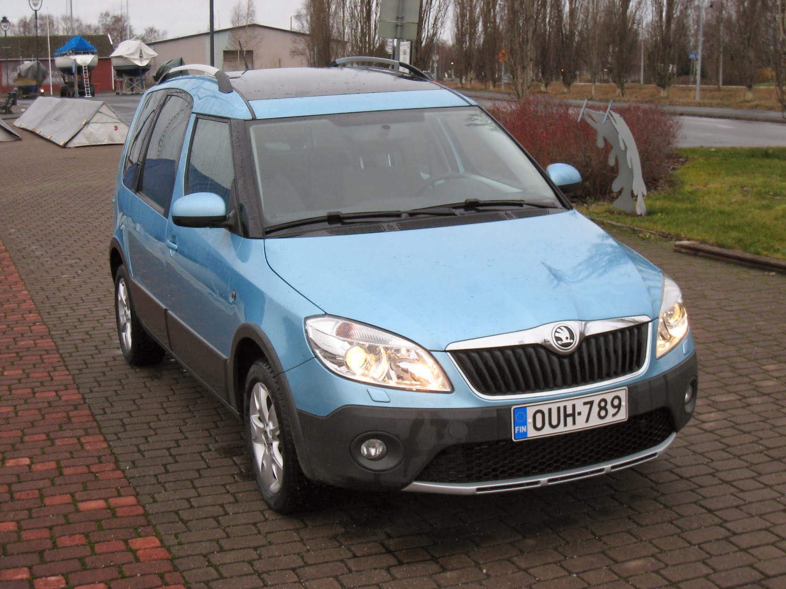

Projector style headlamps are with two H7 bulbs.
They do look like this:
They were optional in Finland and as I heard, they're not available with right hand steering.
I don't have tested standard lights but these are kinda decent.
