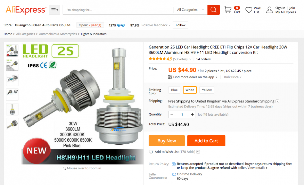

Your link is now directed to this bulb. Is that still ok before I order?
http://www.aliexpress.com/item/Generation-2S-LED-Car-Headlight-CREE-ETI-Flip-Chips-12V-Car-Headlight-30W-3600LM-Aluminum-H8/32280572818.html
Thanks, Phil.
Yes Phil they still look like the same bulbs.

These fog replacement bulbs arrived from AliExpress.

My AliExpress fogs arrived today. Managed to fit the offside one but I simply can't get the grill off for the nearside to get access to unscrew the fog lamp. I was pulling it pretty hard, it was actually moving the car. I'm booked in to dealers for a recall next week so they can struggle with it!
Gizmo68, the fitting instructions that came with the bulbs I didn't really get it. It looked like it was saying to take off the plastic connector from the bulb, then remove the little white rubber washer from the bulb, then fit some odd thing over the bulb (probably from car fog assembly) then put back plastic connector (and washer? this wasn't clear!) but basically it seemed to just fit into the housing with a push and twist - nothing needing to be removed from the bulb assembly. How did you get on with yours?
Yep mine arrives today too l4wrence.
I haven't got a car to put them in but any fitting advice would be much appreciated.

Thanks Martin for the link. Any fitting tips?
I think the instructions are for a different fitting to the H8’s, like you I fitted them without removing anything.
For fitting they really are straight forward, just be aware that the N/S cable will touch the washer bottle, my grills ‘just’ pulled off.

The AliExpress LED fogs don't fit in a 280 because the nearside has an intercooler that is in the way. PM me if anyone wants to buy them off me.
Need to find shorter fog LEDs for 280 with similar colour and light output to the AliExpress ones Gizmo posted that are reasonably priced. Anyone got any suggestions? Preferably by someone who has upgraded 280 fogs and can confirm they fit.
Anyone have any thoughts on the lights in the link below as a suitable fog light replacement in a 280? I still need to ckeck there is 2" gap available so it wont hit the intercooler but it looks similar in spec to the AliExpress 2S ETI Flip Chip bulbs (which are too deep at 65mm for 280PS passenger side fitment). It says it's canbus ready but OE fogs are 35W, these are 40W. Should that cause any problems?
