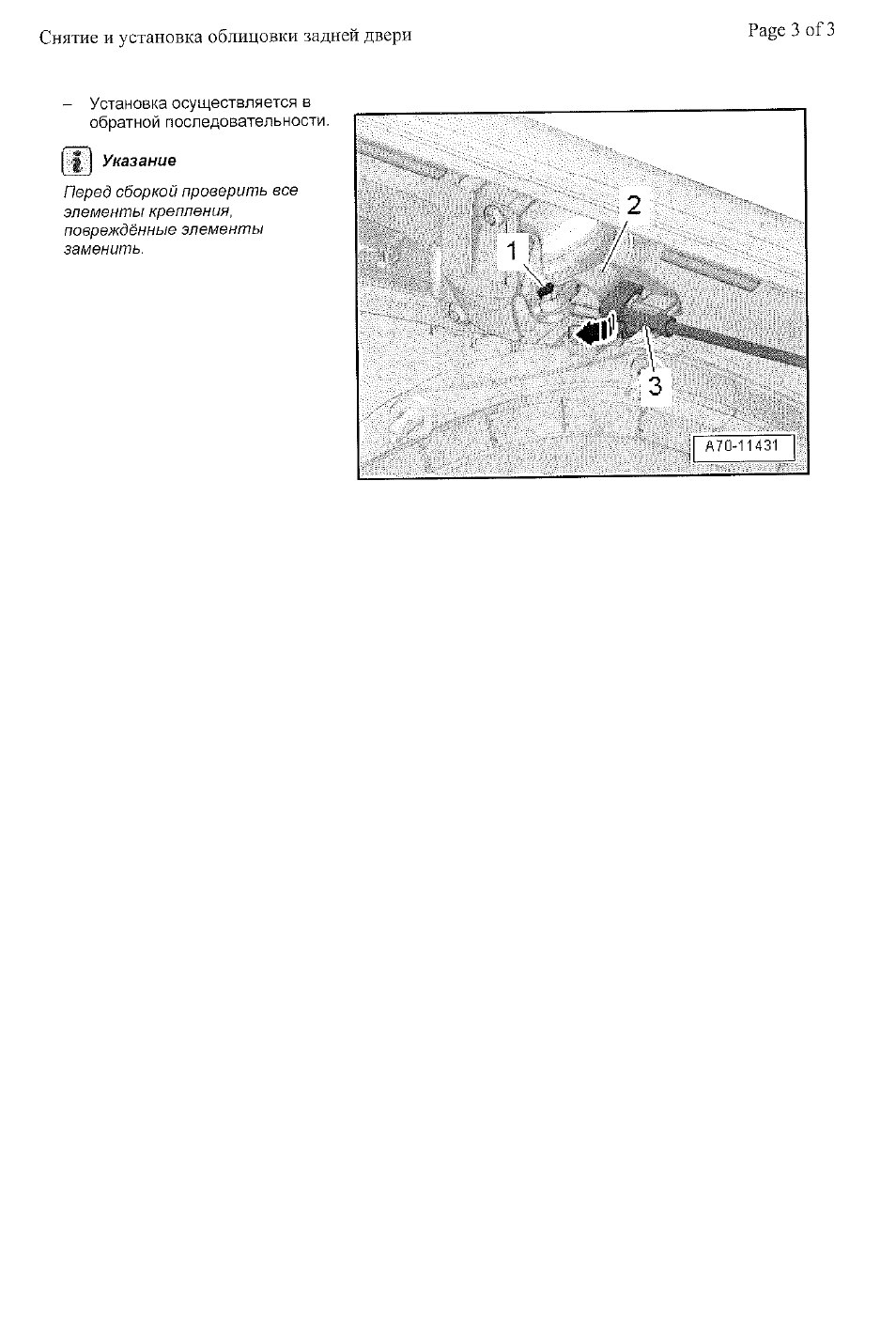

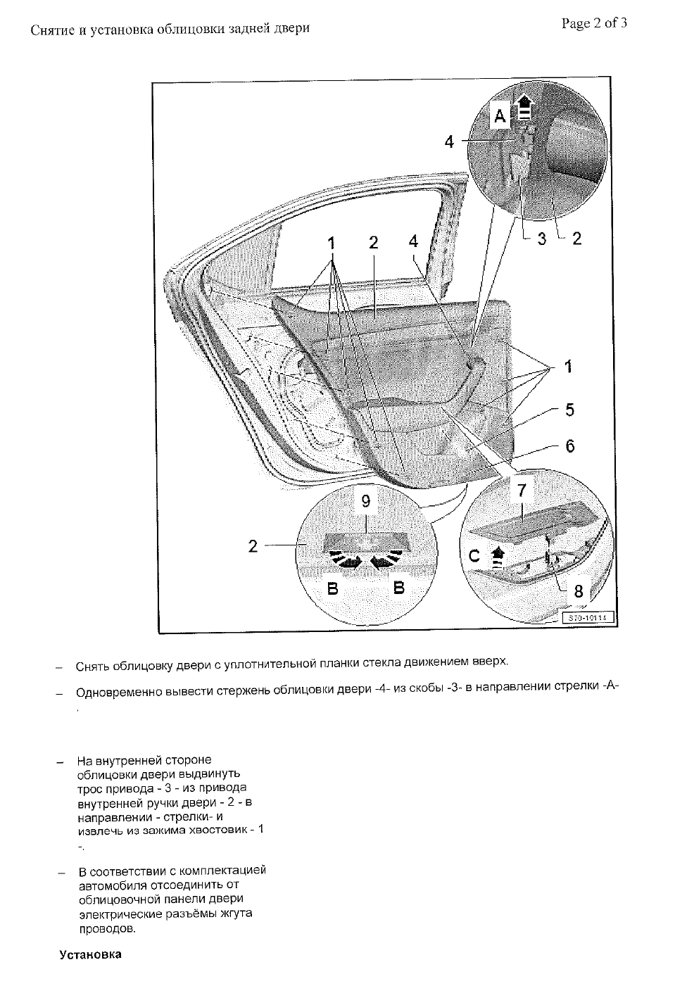

1. 3 pics

Thanks for the guide. I was able to remove the panel. Socket is located on the top left side of the rear door, under the window, close to the door lock.There are only 2 empty pins in the socket. I connected the wires there. The wires from this set fits perfectly:
