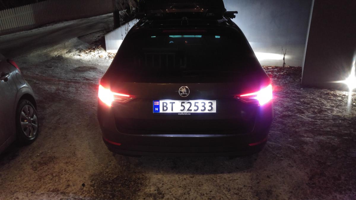

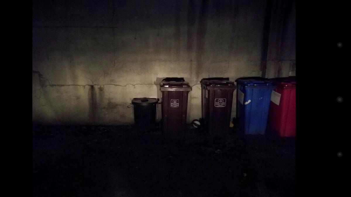

I received these from aliexpress, they were really crap so I thought it had something to do with the cap limiting the flood of light:
https://www.aliexpress.com/item/2pcs-360-degrees-100W-2000LM-1156-S25-P21W-BA15S-LED-Backup-Light-Car-Reverse-Bulb-Lamp/32775136384.html
OK, I switched back to stock bulb on the left hand side (seen from behind).
Maybe not so visible in these photos...:
post-144978-0-82906600-1485018203_thumb.jpgpost-144978-0-97531900-1485018204_thumb.jpg
...but take a look at this video, and especially at the end where I reversed up against my garage door.
As you can see, the stock bulb gives a light that is definitely stronger than the red glow from the rear running lights, however on the right side (driver side for you in UK, passenger side for us on the mainland...) the LED light is not much brighter than the red light and in sum it just becomes a red/white/pink light.
I will order the LEDs recommended by @Gizmo68 and try to do a three-way comparison!

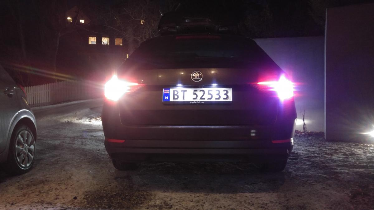

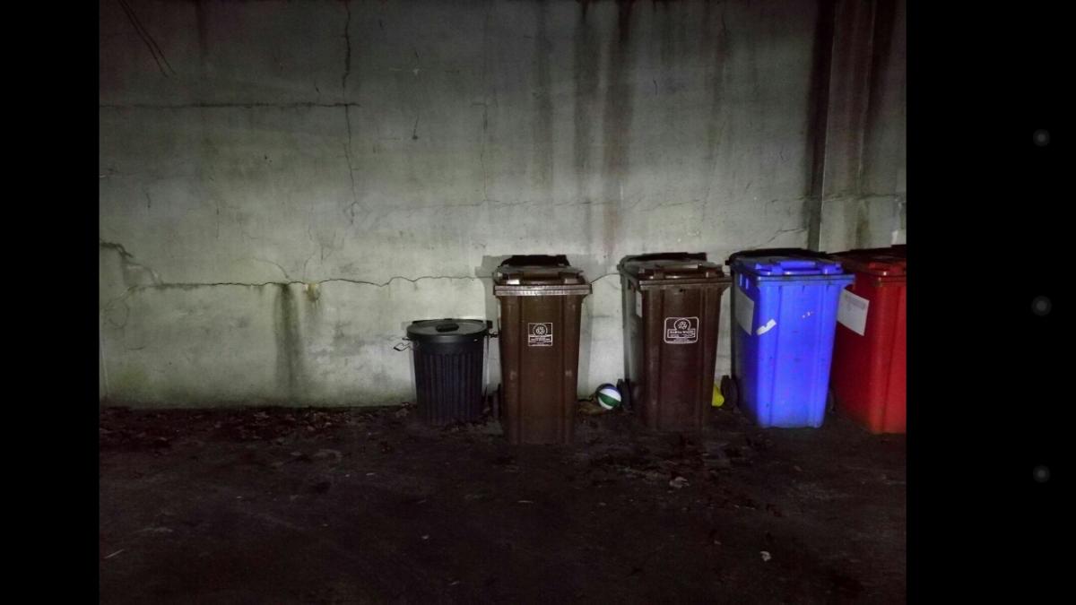

I followed Gizmo68's recommendation and the following pictures show the difference with the reversing lights. I installed the 80W 1156 S25 P21W BA15S CREE bulbs. I also swapped the indicator lights for philips PY21W LED but to be honest I notice fcek all difference with it.
