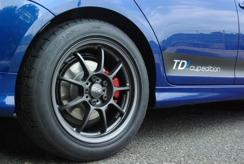

Thanks for the input. Sorely tempted by some Oz Alleggerita at the moment, just not sure how the titanium tech color looks in the flesh.

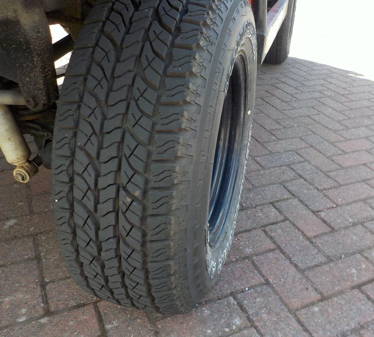

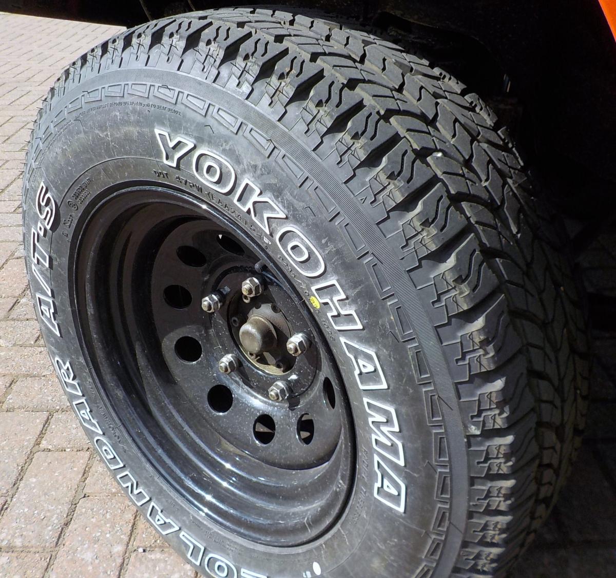

Just put my Summer AT Tyres on my Suzuki.
Fat at 235/70 R 15.
(This is what they have on the Ariel Nomad for Road use so i thought i would try them and see what like
in wet or snow, they are fine in the dry.)
The white lettering does not need to show, the black sidewall can be on the outside.
