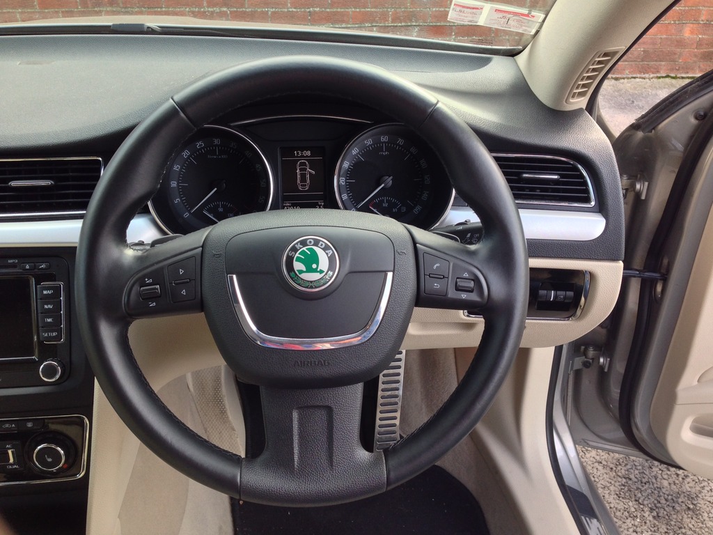

Someone who knows more about the wheel setup than me would have to answer (I only know about swapping on a 20 year old 7 Series I used to own!) - but if it helps, here is a straight on view of the wheel and the buttons (no fancy DSG flappy paddles like WaveyDavey - mine is a manual 6sp box)..
