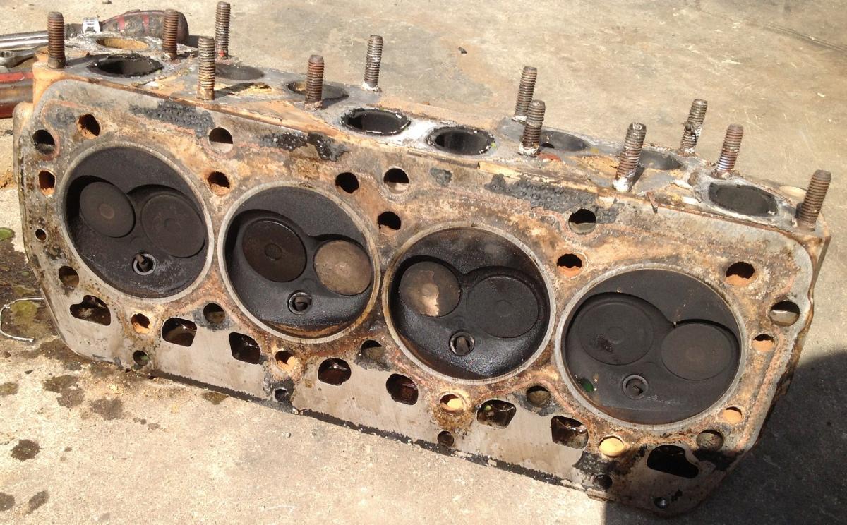

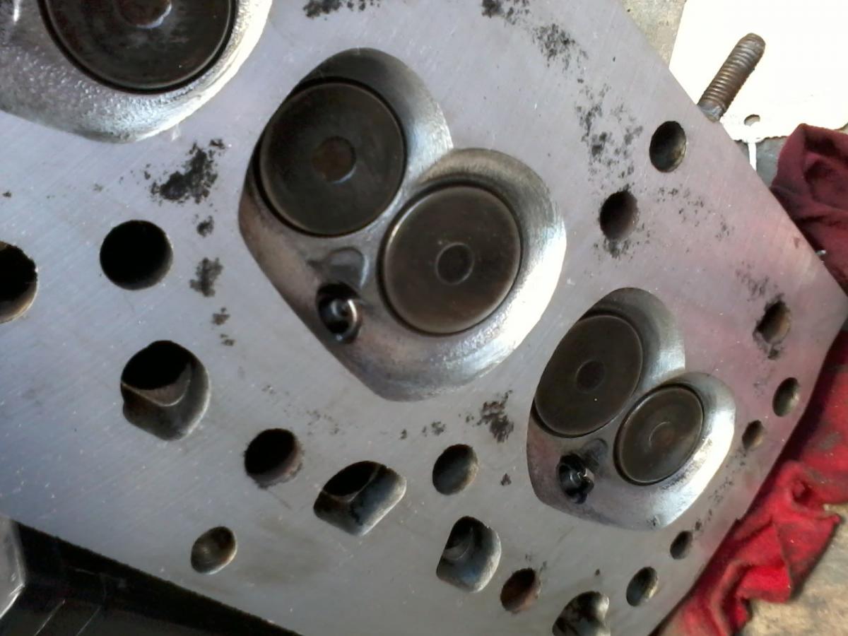

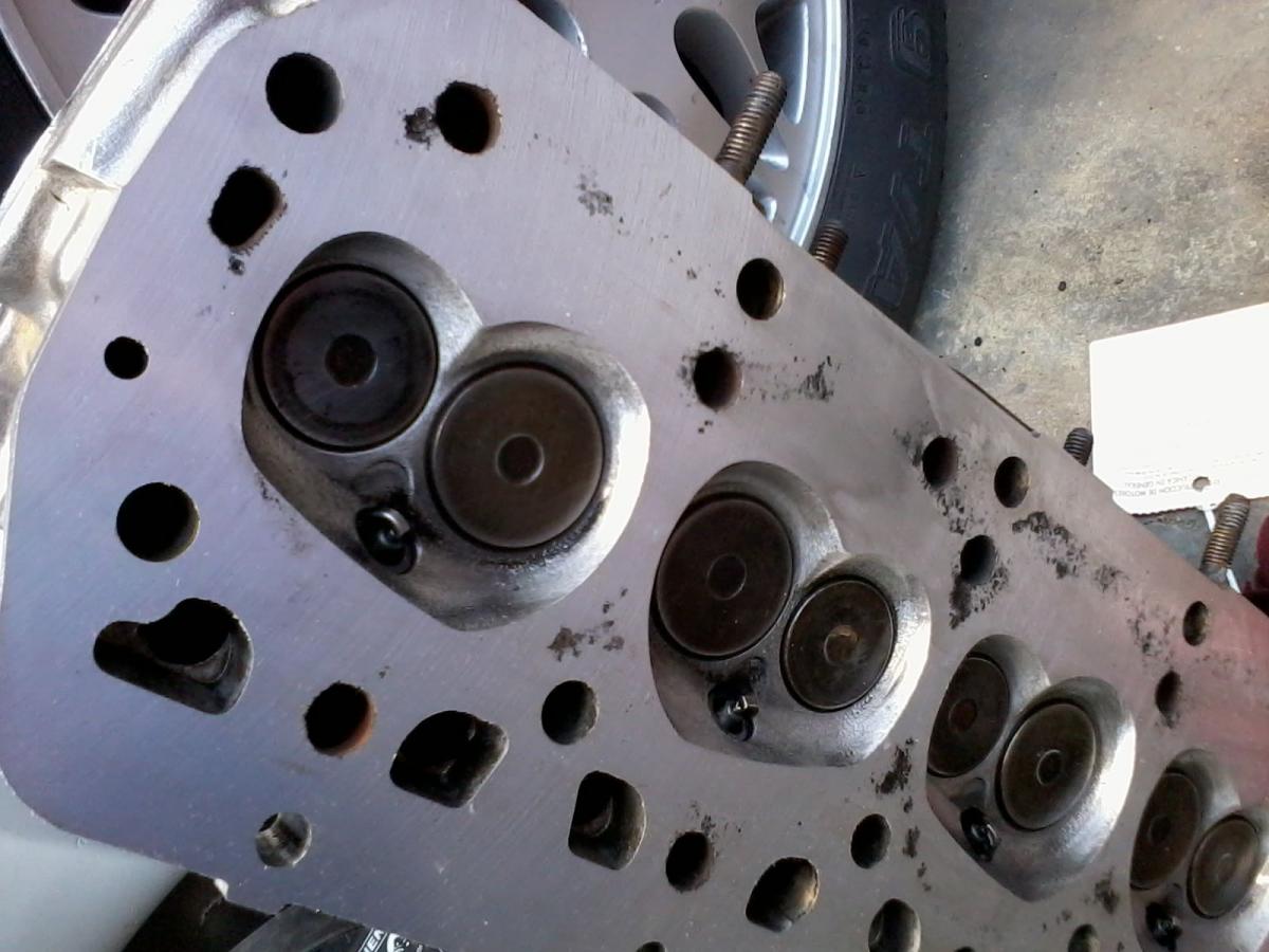

This is my nightmare: some month ago I had a blown head gasket. It was due to a leak. Took it to the mechanic. They took the cylinder head to have it machined flat. The result was as I show in the pictures.

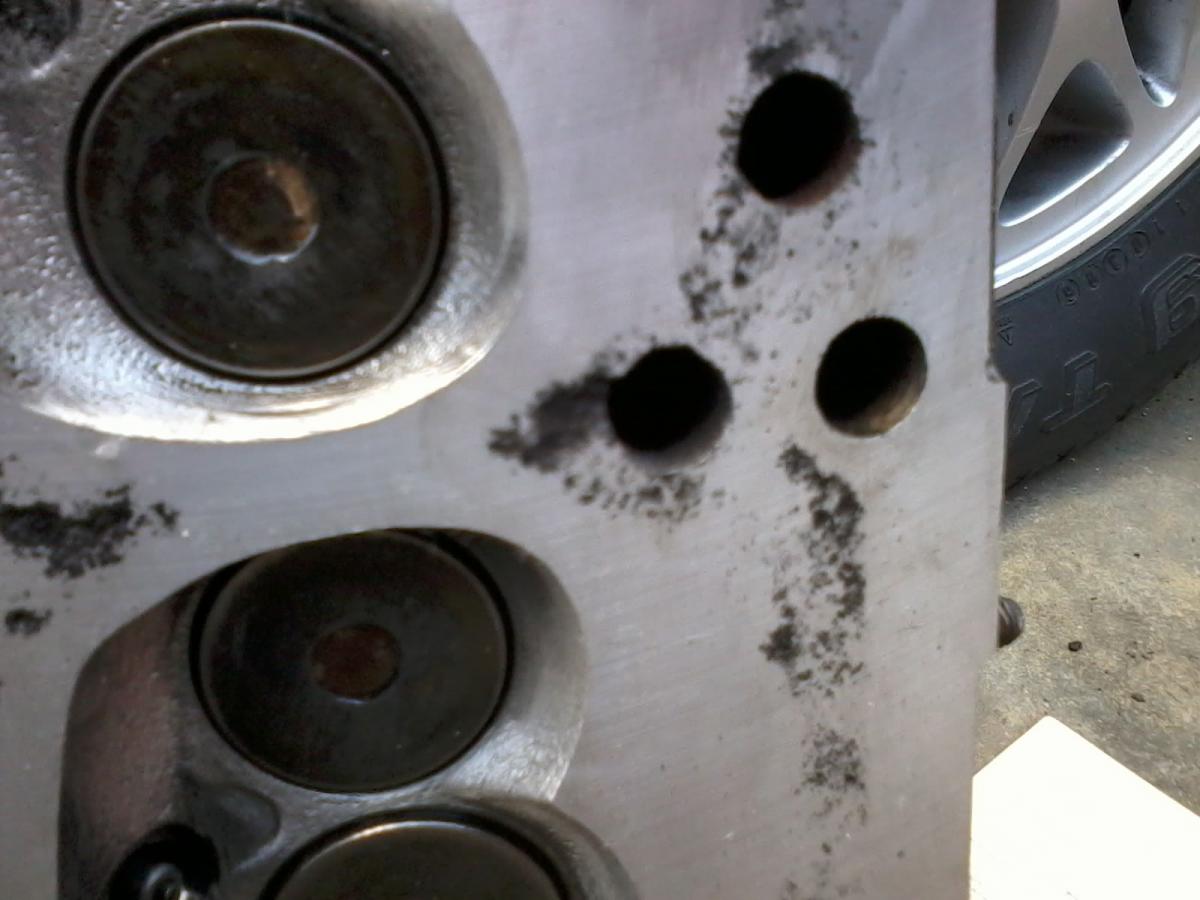

My question: looking at the pictures I posted, was the flattening work on the head properly done? I still see some holes, kind of deep. I suspect the head needs more work or maybe it was wrong assembled, or bad head gasket. The engine did not reach an extreme heat level this time, but why the head/ head gasket failed to manage such temperature level? By the way, the heating problem came up after replacing the spark plugs and cables. I got the cables wrong installed a few times, the car refused to start, but later I finally put the cables in the right order and the engine started fine. However like three days later the heating problem develops.

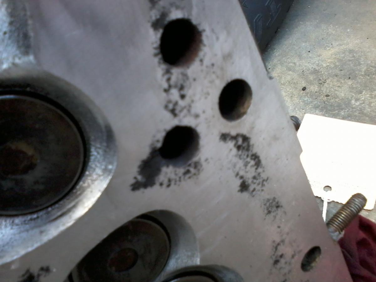

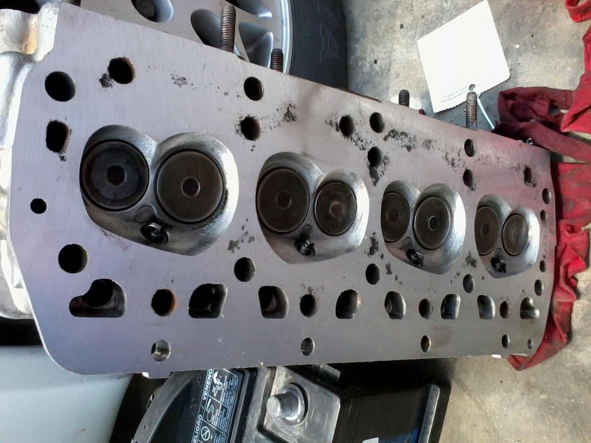

Adding two more pictures.
the cylinder head is not machined all the way flat it still has spots where its uneven and let coolant pass. it must be a mirror finish

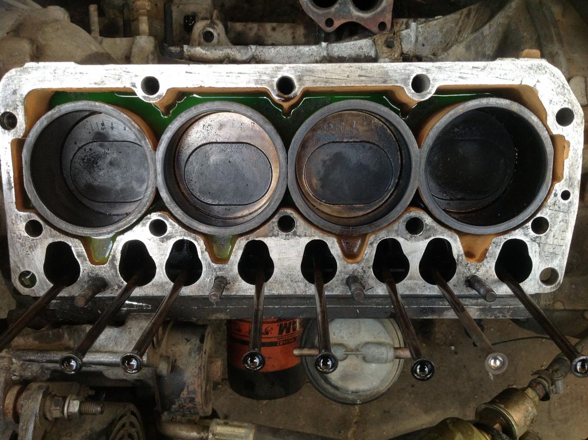

Now, about the head or head gasket failure.It is not very clear when the last two photos were taken. Was it after the first HG failure? All I can tell for now is pistons 2 and 3 had been cleaned by steam. That suggests coolant leaks in those cylinders.

A mechanic can find the truth by "reading" the failed HG. Do you still have it? Post high resolution photos of both sides. Now about the quality of head resurfacing. It is not mandatory the surface of machined head has a mirror finish. It is more important there are no faults around oil and coolant passages. If you look again at first six photos, you'll understand where are the weak spots.

About the HG: the last two pictures were taken after the first HG failure.

Ref #1, all that pitting in the head should have been removed, but that leaves me wondering whether doing so might have planed the head below its limit, which causes problems with compression ratio, and possibly with valve gear geometry and hence timing on a "cam in block" engine.
It's already past the max skim depth as the indicator is gone.. (small indent in the face manifold side in halfway along.)
Possibly be OK as it's carb so can retard the ignition to stop it pinking. Only other "fix" is filling the holes with something before skimming in chemical metals or weld.
At a guess there is not enough support around the middle cylinders as there looks to be fairly deep pitting there still. Oil on the hg wouldn't help either though.

You got numerous good answers so far. But all are too expensive for you because the initial corrosion was too deep. You can't do much with a cylinder head still badly pitted around middle coolant passages after such deep resurfacing. I don't think anyone can guarantee for success after using any type of miraculous epoxy. You are on virgin territory. In my opinion the cheapest solution is to buy a new head now. Everything else will be just a temporary fix and you'll end up where you are now but with even less money in your pocket.
