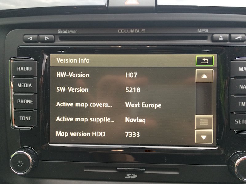

I don't seem to have the POI option for new destinations....it's there on the list but not active for selection.  Address, Map and GPS options are all active.

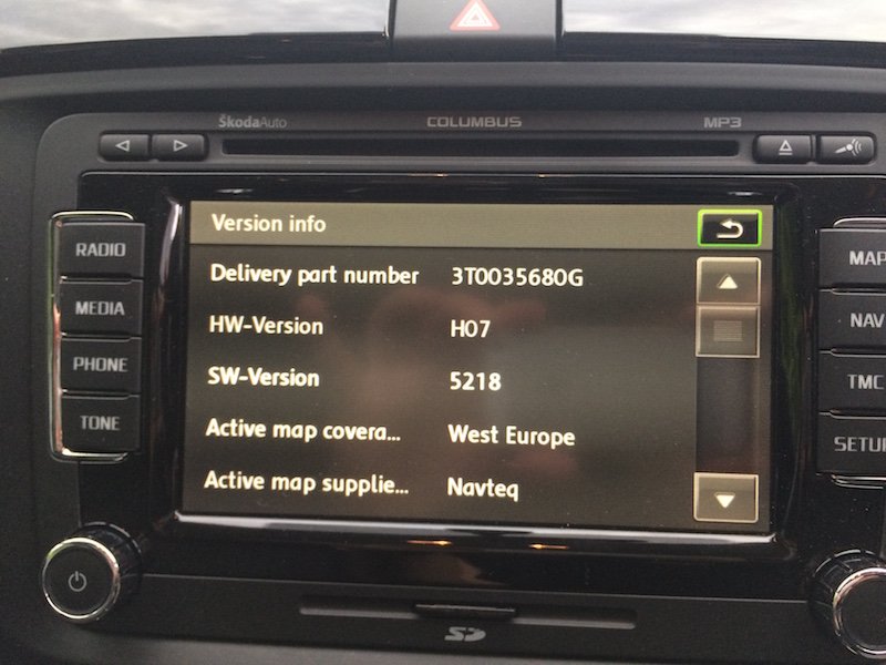

Having looked through the forum it seems that some info about the unit may be useful, so I took a couple of images of the Version Info (thanks to the forum I was able to get to that screen :-) )
Should I be able to get POI's on the system?  If so, how?  Is it a dealer thing?

Your software on the unit is capable of showing POI, but your maps version doesn't have the required POI on it to display. You should update your maps version, latest being V13 (8348) while yours are 7333.

V13 has been available since back end of last year. However, it looks as though they've possibly updated the software of the unit and not the maps. I'm not sure though as I don't know what software your unit came with. It'll be on the data label on the top of the unit mind, if you fancy pulling it out and having a look. As a guide, I have a 2012 unit here which was SW 3984, while yours shows 5238.
