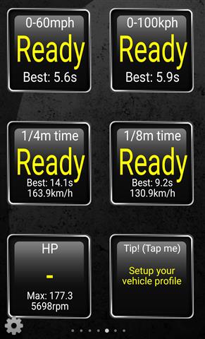

G'day Stefan
Glad to see you are enjoying your Fabia. Here are the Torque App results from my stage 2 CAVE during a 1000m runway event last year. In general I do think the car could good a bit faster then this if 2 simple things changed. Firstly the road was a rural airway which had almost no grip and we could not do burn outs to warm up the tyres. Secondly after running 235/40R17 tyres for over a year now I think the extra rotating mass weight is slowing me do at the top end. The 235/40R17's are 2kg each heavier then my old 215/40R17's. So going back to 215/40R17's for next set on the 17x8 wheels.
For your speed runs I suggest using traction control for your launch and then turn it off after you get off the line so that it doesn't cut the power when you are shifting into 2nd and 3rd.

Your figures are amazing, can't imagine how fast that feel. How much horsepowers do you have with an APR-stage 2 tune? I see your wheel horsepowers shown at 177,3 HP, which should be around 208 HP at the flywheel with 15% drivetrain loss, am I correct? So If you say you have around 220 hp, that means the drivetrain loss are around 20%. That means that my Fab mk2 vRS put's 191 HP on the flywheel.

I have had my CAVE on a dyno once before and It was putting out 132kw (178hp) at the wheels. So I think the Torque App figure is not too far off on its estimate. At the flywheel I am guessing about 220hp. However the general view from most people /posts on the forums is that the CTHE motor puts out more power then the CAVE's stock. So from what I have seen 191hp at the flywheel for a CTHE is about right. As there is not much info about tuned CTHE's from anywhere in the world I would say for now that a tuned CAVE and tuned CTHE put out similar power.
