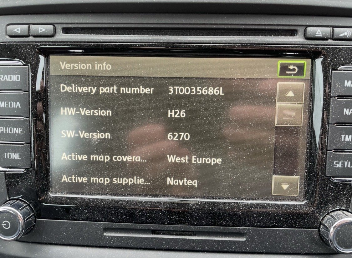

I have a 2014 Superb with a Columbus DAB RNS510 3T0035686L HW H26 and SW 6270. I’m wanting to add Apple CarPlay to the car, what are my options?
Read this topic?
