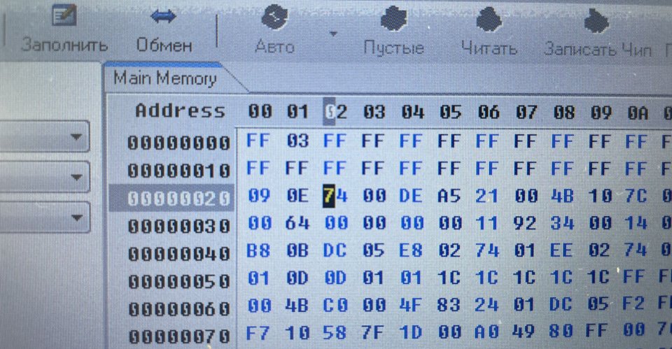

Hi, did any of you fixed this?
Just got mine. Works great except the clock and my OCD is killing me.
I read that lots of VAG cars started to hav ethe issue like if after 10 years something goes wrong.
It is necessary to change in EEPROM - 0017 dashboard.
In fact, it is necessary to change the date in full. The date consists of 3 bytes. Address 0x22. The current value should be replaced with 00. When 0x20 exceeds 5F, the state stops understanding the date and time.
Edited by John1976
Thank you for the very clear explanation with pictures.
Can this be done with vagcom or OBDeleven? Or do I need a more skilled software?
You need to get a programmer that can read 24c32 or 24c64 eeprom, maybe a ch341a.
vcds and eleven can't do it.
Oh hell… it looks complex. I may have to live with it since normally I have CarPlay there. Maybe doesn’t worth it on a daily car.
But so far is great that you are posting the solution here and might help others with a clear explanation.
That is very much appreciated.
Edited by Santisilver
Google Docs
No image preview
24C32-24C64
It's not as complicated as it seems. Or find someone who understands it and has a programmer.

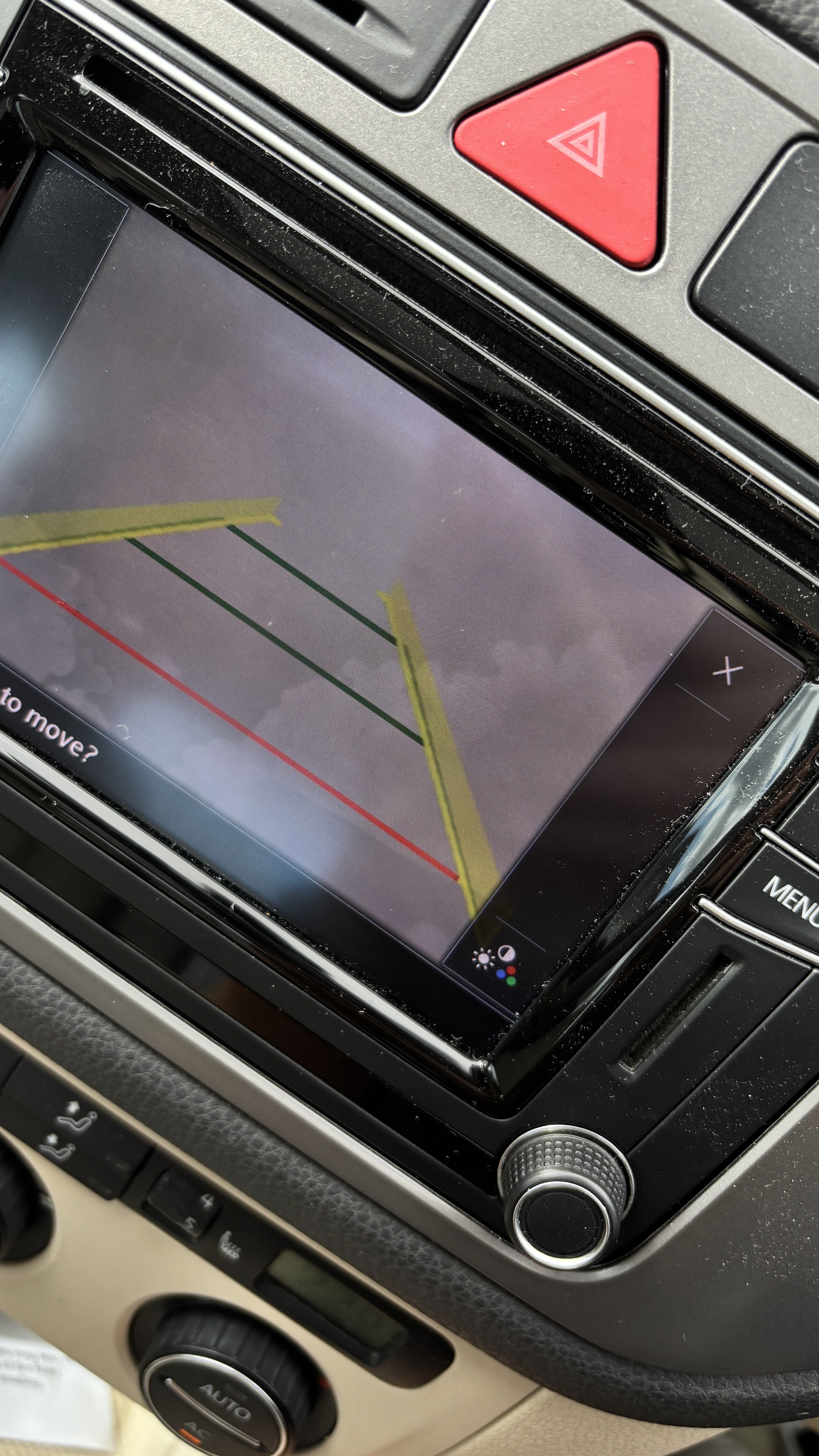

Hi @pab567 , I have a 6.5” Discover Media MIB Std2 PQ in my 2009 Volkswagen Tiguan, but I am purchasing a 2010 Skoda superb and want to move this unit across into the superb. The display needs some fixing (I think glue is separating in the corner) and I want to change the skin to be Skoda and the buttons/LED’s to be green. Is this something you can help me with?
  1. part number of your MIB STD2 PQ unit?
  2. buttons LEDs change is a hardware mod, 22 LEDS must be exchanged, I use OSRAM LG M67K-G1J2-24
Hi @pab567 ,
Part number is 5C0035680B. SW train: MST2_EU_VW_PQ_P0252T
This unit has been unlocked/CP removed from what I understand.
I have attached a photo showing the screen issue... is it the backlight or something?
I have found a 5L0035680A Skoda unit locally that I may purchase instead, which has DAB, but curious to know what sort of cost would be involved to change mine to the Skoda skin and to swap the LED's.
