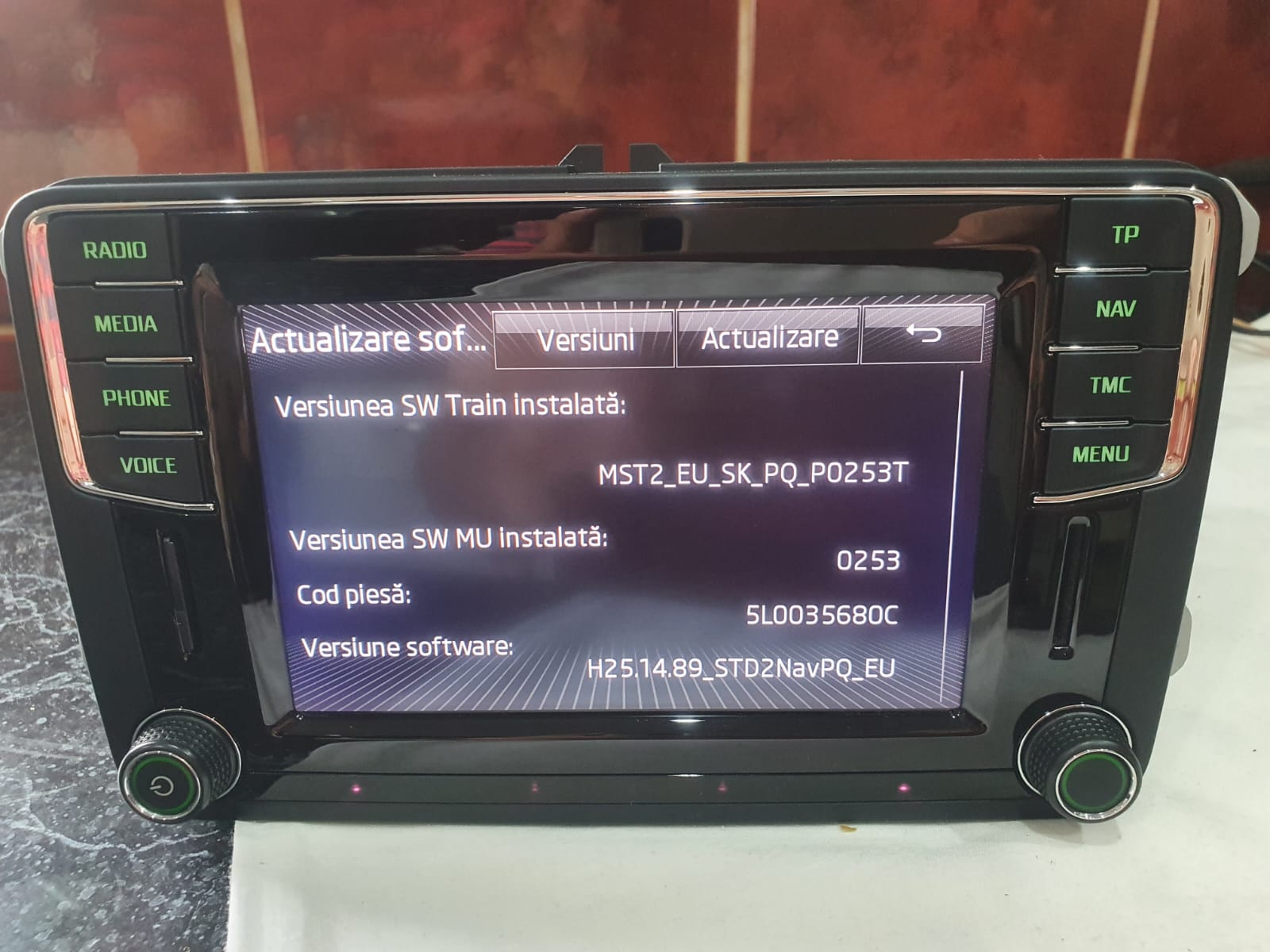

Press and hold down the Menu / Setup button for about 10 seconds to get the Software Train value.
Post back with this.
Thanks for the quick response!
It says:
Installed SW train ver.: MST2_EU_SK_ZR_P0471T
SW MU ver: 0471
Part Number: 5Q0035819C
SW Version H29.319.51_STD2_EU
Current Version: MST2_EU_SK_ZR_P0471T (0471)
Update: MST2_EU_SK_ZR_P0471T (0471-2)
It says:
SW MU ver: 0471

Hello! I have this unit, the firmware can be updated to 478? Can someone guide me?

I am from Spain. I have a VW 5C0035680B radio to which I installed MST2_EU_SK_PQ_P0253T and it has SWAP, CID and CP patched, but I have the problem that I cannot exit the phone menu on the maxidot. The only way is the one I read on this forum, which is by putting a route in the navigator. I have been using the radio for almost a year without any problem, without entering the phone menu. But for a few days now, every time I start the car, the phone menu appears. And it's quite annoying to have to do the navigator trick every time I start the car.
