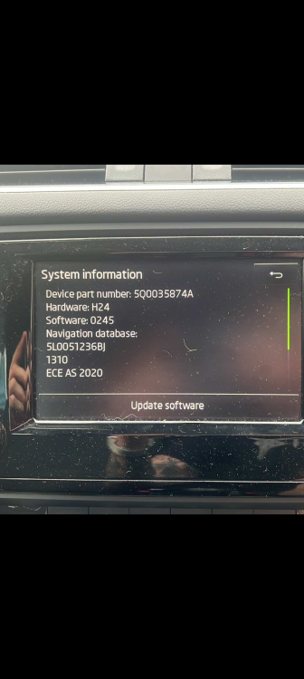

Hi guys, I have installed Amundsen in 2006 Octavia II. CP is off and everything works great except bluetooth, when I press wanna connect the phone only what I get is message "Bluetooth not available". Is there any solutions?
5L0035680B
SW was 0245, updated to 0253.
Anyone?
Have you disabled your old Bluetooth module in the car (if you had one)? Has Bluetooth been enabled on the new radio?
There was no bluetooth before in the car, Bluetooth has been enabled but when I press phone there is message "Phone not available".
Have you paired it with the car/radio? May sound like a daft question.
I can't remember if I paired mine using the MFD display or the radio itself.
Edited by Oli
Friend of mine was doing it, he installed dozens of these radios in VW and everything works great. He also installed another one in FL Octavia and there is the same problem HW and SW are the same...
Maybe post an autoscan from VCDS?
A 5L0035680E worked flawlessly in my old FL Octavia and I'm sure @pab567 has sold loads to various Octavia owners too.
This one is 5L0035680B. I will post autoscan tomorrow.
