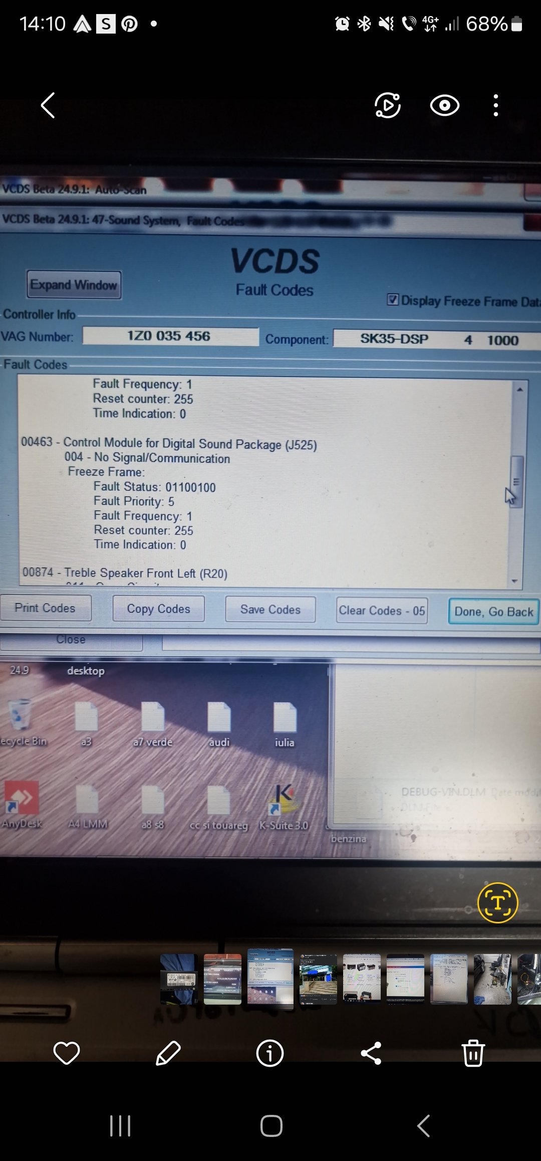

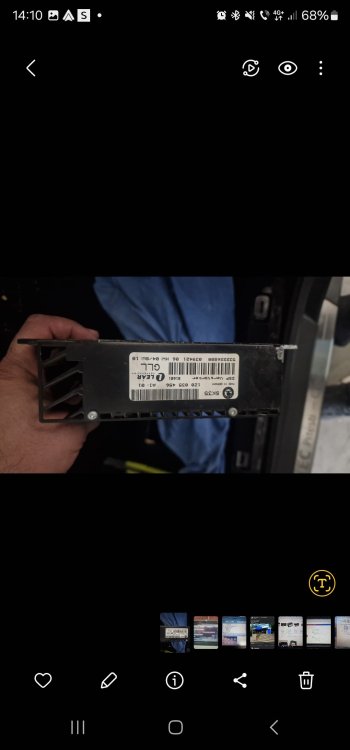

iI just installed the sound system and I don't have any sound, can someone help me with the coding
03130601FF00000011111205008800002F0000D60120010046
Edited by gabi2004
5F Byte 11: External Sound System Active
5F Adaptions: Car_Function_List_BAP_Gen2-amplifier -> Activated
Car_Function_List_BAP_Gen2-amplifier_msg_bus -> Databus Infotainment
Audio_Parameter = 1
Use VCDS head that supports UDS.
Screenshot_20241017_141007_Gallery.thumb.jpg.252e377ec4e191f6f00381ded5bbb5c9.jpgMy amp is first generation
you are the best guy ever seen in my life
