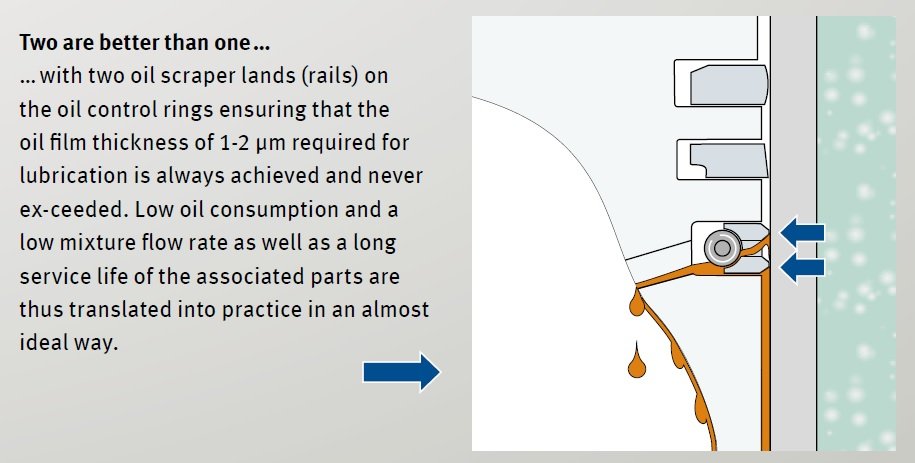

1litre per 400km, that is too bad already, accepted limit is only up to 0,5litre per 1000km, that means your are beyond this 5x with 0,5litre per 200km :sadsmile: ... Yes, clogged drainage holes at oil control rings is the root cause, no chance to clean them with anything ...

Yes, I see this as very likely option, same bad design of just drilled drainage holes at oil scraping rings still used in latest VAG engines ... Could work at MPI engines without EGR, but surrely not at FSI/TFSI/TSI and any other direct injection engines. Using EGR technics they lower the NOx values, but that means increase of PM particles. EU norm 5 did not control PM particles at petrol engines, EU 6 does, so therefore latest DI engines must have GPF / PPF / OPF filters, same as diesels have DPFs ... But PM particles do not only flow out from the exhaust, it make dirty the engine oil ...
!!!Piston Rings for Combustion Engines.pdf

Russians know that as "раскоксовка", see on YT, this can help a bit, but no chance to loose the tiny, just drilled (not slotted) drainage holes at oil control rings of 06H107065BS pistons ...

Unbelievable how any engine designer could even think a ring design like that would not cause problems!
Which pistons/rings to buy then? Can I buy pistons with a different design to the rings? If not then the problem would just arise again right? And what else normally gets changed? Need to start calculating.

Looking at those tiny holes, its obvious to me that you need
Clean oil - very low ash (saps), quality synthetic (stable not prone to sludge, oxidise, gum up), thin viscosity to keep flowing. So the very best and changed well before it gets heavily loaded with soot and varnishes.
