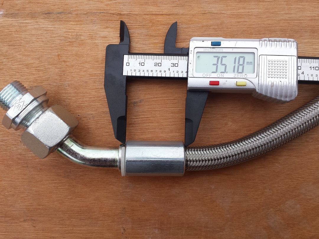

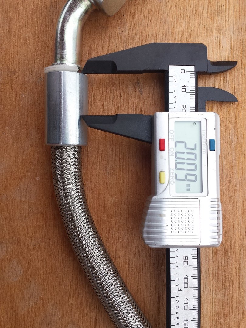

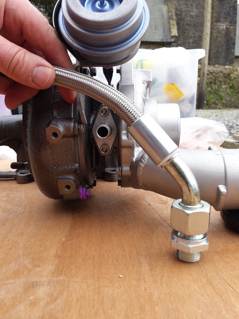

I had this made up at a hydraulic engineers on Friday. I wanted a bit of feedback on whether anyone thinks it will fit.
There is a 18mm to 1/2" BSP fitting that will thread into the block. The 1/2" hydraulic pipe is stainless steel braid and PTFE lined so it should be more than up to the oil/temperature environment. This is a snug fit over the barb on the turbo. The only thing I'm not sure about is does anyone think it is too big i.e. where the pipe fitting comes out of the block and goes upward towards the turbo.
The hydraulic engineer said he could reduce the length of the swage/crimp. So if it reduced from 35mm to 20mm this would give me another 15mm more to play with.
If anyone has the undertray off this week and has a GTB2260 fitted, would it be possible to get some dimensions i.e. from the threaded inlet to the block, up to the oil return flange on the turbo. It would be appreciated. There isn't any point in me doing any measuring, since I've still got the standard turbo fitted.
Cheers, me dears.

But got a feeling you might be better off with a 90 degree bend,but not 100% sure!
Lofty off here has a engine on a stand currently, so he should be able to give you a good idea,apart from the fact his is on a tubular manifold.
I've fiddled with this in the past on my old turbo (2260 on cast manifold also). To be perfectly honest, I think that it's going to be miles too long :(  I had to substantially cut down the connector from the block and the one off the turbo. Best solution was a 90 degree piece in the end.
Can't get to mine easy at the moment as there's half a car surrounding it, but I'm going AN10 angled fittings on the block and turbo drain with a short run of AN10 oil resistant pipe between, the fitting in the block you're right is an M18x 1.5 fitting so the possibilities are endless. I'll get pics of my one up in due course
+1
Looks far too long in my opinion. Mine is a really ugly sight, but is sealed and therefore does the job. Jubilee clamped rubber hose bodged together with the original oil return line. I have a 90 degree elbow made from some some hydraulic piping, originally I wanted an elbow with a braided line to mate with the sump, ended up just keeping the elbow and making do with some oil hose.
Good luck with finding one that matches up. It will be a real trial and error situation. Just make sure it is sealed and isn't leaking. Despite it not being under pressure, oil really does flow through it once the engine is running.
JRJG
A custom solid pipe would fit the best but it would be tricky to make.

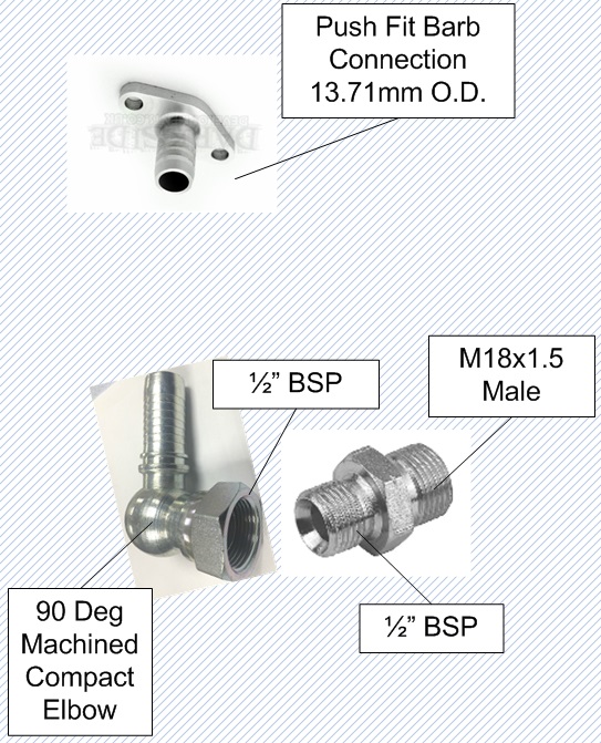

Thanks for the input. Next week I'm going back and trawling through the 3 bays of fittings he has and looking for a "compact elbow" I think its called. It will have a 90 degree bend, which mimics the way most people, including XMan, have done it. To keep the length to a minimum, if I crop the barb section down to 20mm (the width of a 20mm Mikalore clamp), this will probably give me another 40mm. I will then be able to fit a straight section of the teflon/stainless pipe. See picture.
That looks a lot better.
The only concern is you have zero movement to allow for minor discrepancies in the mating of the pipe to the sump. Hence why a short length of flexible pipe is a good option.
Hopefully it will match up for you though!
JRJG
That compact elbow does look the best idea I've seen :)
Cheers for that guys. I was trying to learn by other peoples issues. By my reckoning the elbow needs to point upwards at a distance of about 80mm out from the side of the engine block. Hopefully, it should then point almost directly at the turbo oil return flange. With both items mounted I should be able to measure the length between the barb connectors and cut the oil pipe to length.
