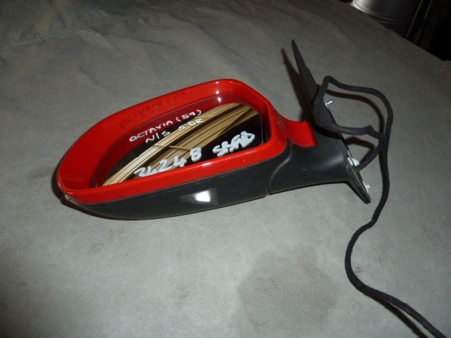

Passenger Mirror with puddle lights

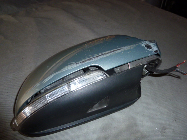

Broken drivers mirror to scavenge the puddle light

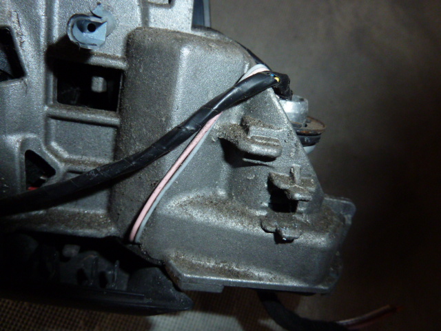

On stripping down the broken mirror I found this
It's got the motor for electric folding!! I checked the passenger one and that is electric folding as well :)  As for the drivers one I will be able to salvage the parts and rebuild with the original one off of the car so that's another retro fit to add to the list - Folding mirrors!!

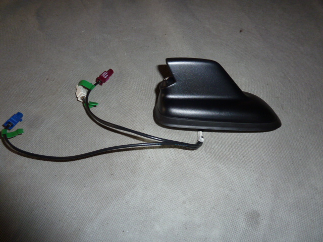

GPS etc aerial
You know that aerial hasn't got DAB, don't you?
Is it not? Oh Bu99er. Ah well it was cheap so not too worried
DAB ones have the black Fakra plug which isn't there on that one. Also, the actual antenna isn't there, it's just the base...

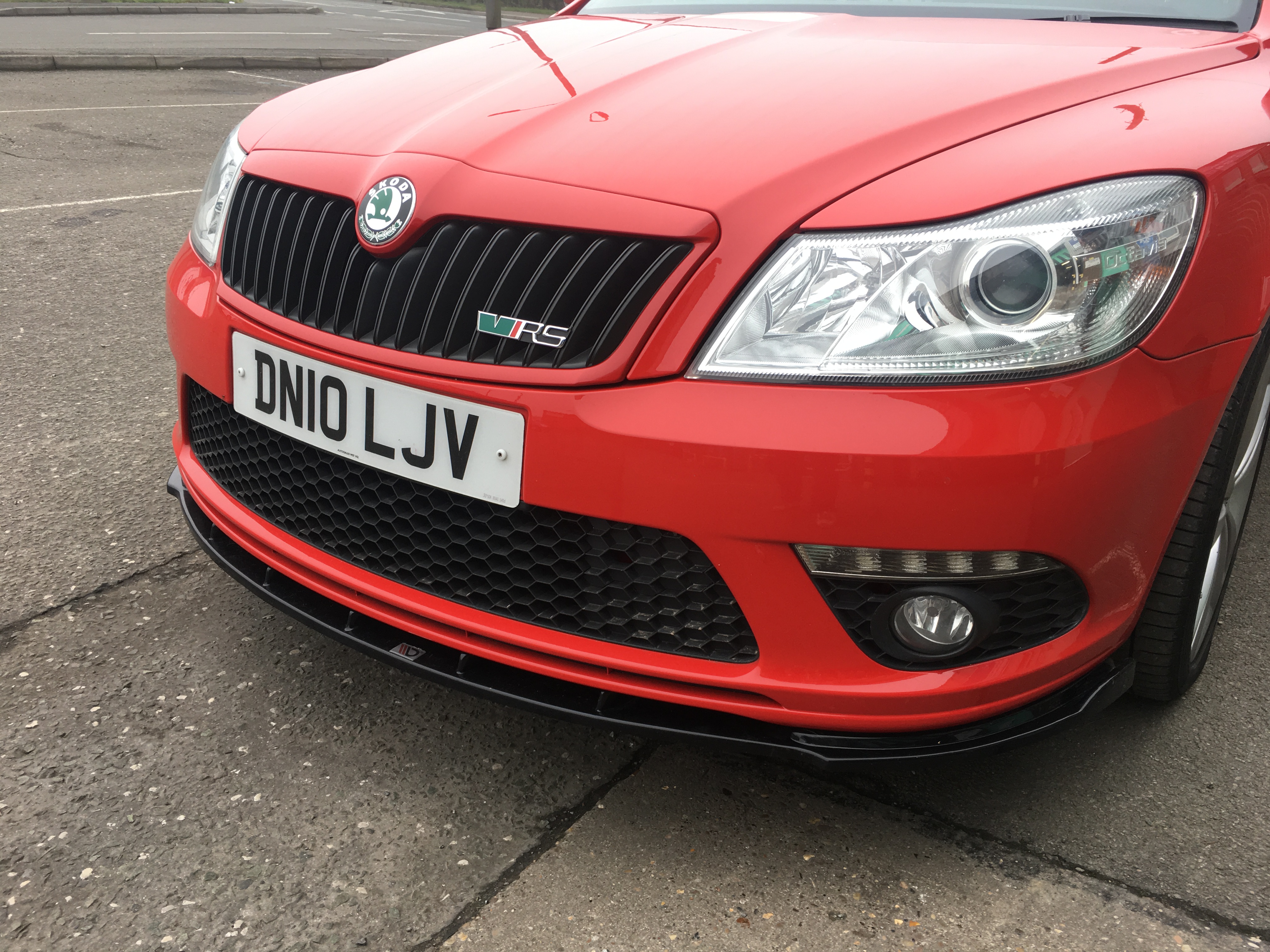

You gotta colour code the grill matey !!
Will the original antenna not fit?
That looks really smart and so does the splitter. Added to the list!
I don't think so. The one for that base is a short stubby antenna. Your original might fit but I dunno if it'll work, it'll certainly look odd.
I guess the stubby antenna on the car is not an original fit then?
The one on the pics you posted doesn't look like a stubby. Could be wrong though.

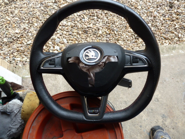

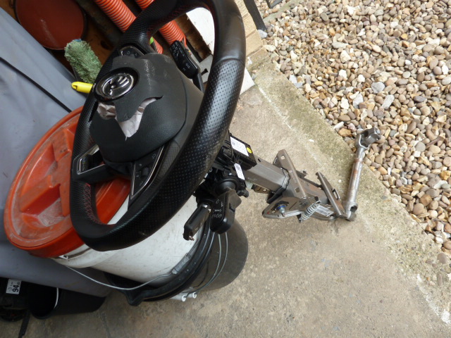

Had another delivery as well today - my bargain Octavia 3 VRS multifunction wheel As you can see it is a full column so have the stalks, look clock ring etc. I think it was a bargain at £95 delivered compared with bare steering wheels that are going for well over £200. Just need to source a new airbag for it.
The Octavia mk3 modules won't work on your car
If you want to fit that wheel you will need to change the buttons to superb facelift ones
Also you will need to have a maxidot to get the best from a mfsw
Correct. It is a genuine VW item though, from the Polo 6R.
looking forward to some mods and tweaks.
Thanks for that, Maxidot is on the list of wants
Do you know the reason why they don't work with the car? I would have thought that all of the buttons that shape have the same function.
Octavia 2 FL uses a slower CAN system than the Octavia 3
Protocol is different
Thanks for that

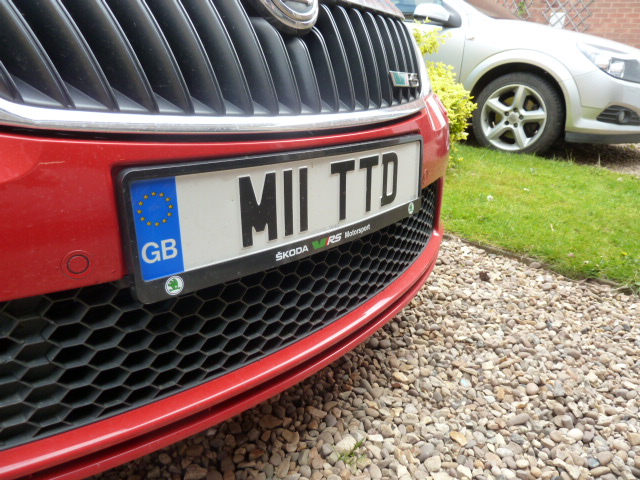

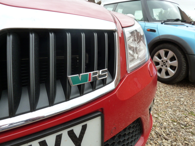

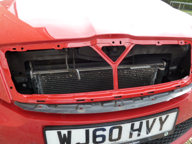

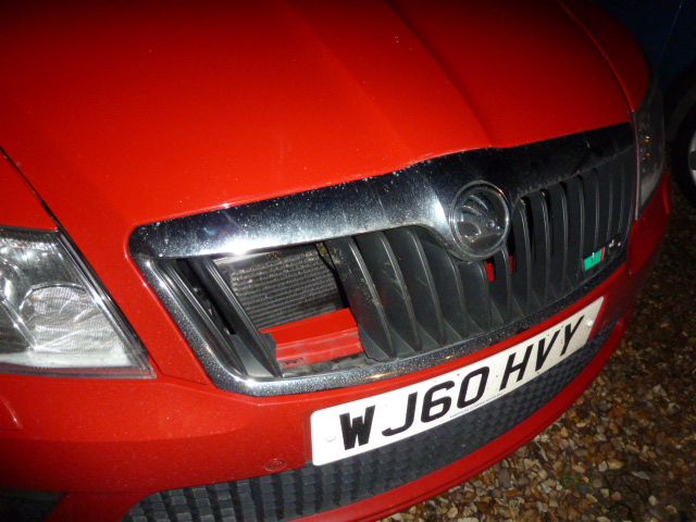

Anyway I haven't had the car a week yet and a suicidal pheasant decided the time was right as I drove on the way home with my daughter from her piano lesson. Result??? Luckily only a smashed grill (which was slightly cracked anyway so needed replacing) Could have been a lot worse if it was a couple of inches further to the right. Dread to think how much a new Xenon headlight would be
Been a while since I updated this so thought it was time to update...

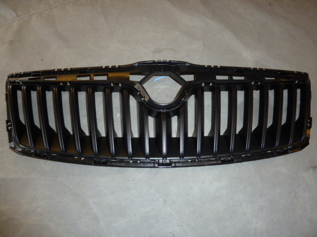

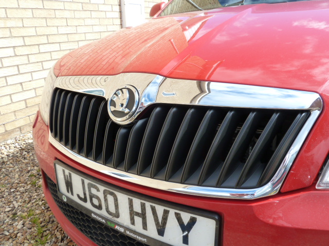

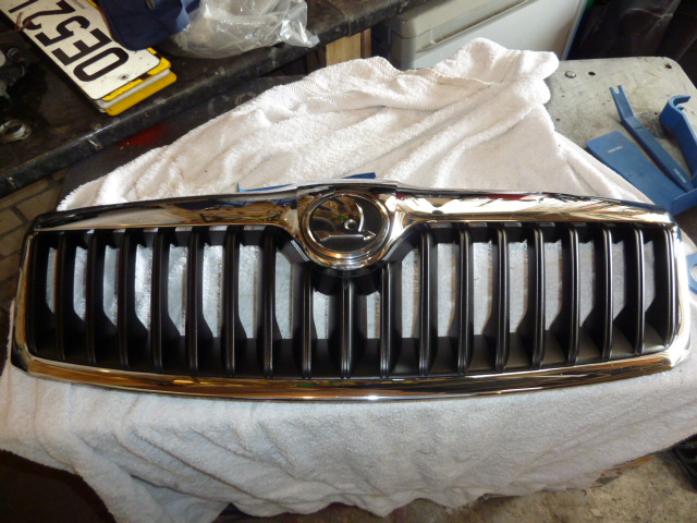

New grill centre arrived
All made up ready to fit
Gave the area of the bonnet behind the grill a quick clean
And all fitted
Just need a new VRS badge to finish it off (on it's way...) You can also see the new plate holders I have fitted after deciding I couldn't look at the wonky number plates any more.

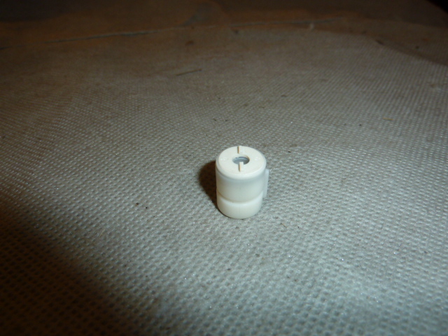

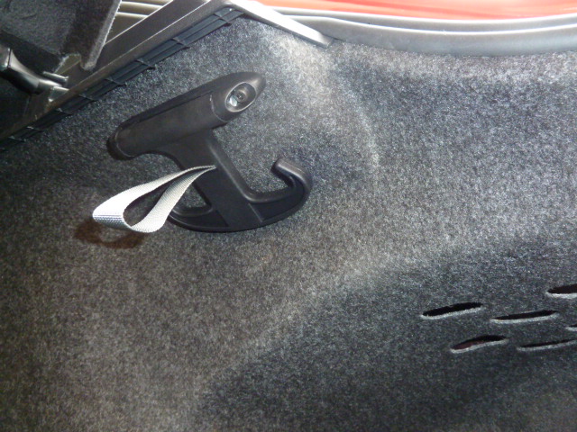

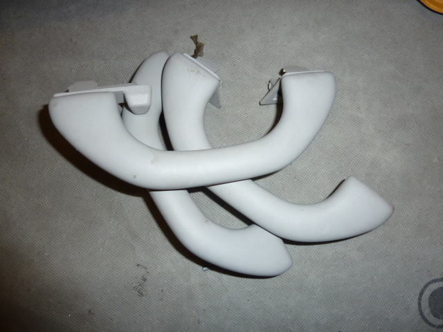

Also made my 1st retrofit upgrade. After owning a couple of VW's I noticed the lack of damping on the grab handles so a quick search on here found this thread
A Mk5 Golf in the local scrappy was relieved of these
Which I stripped down to get this part from them
Half an hour later and there is no more annoying thud when you release a grab handle :)

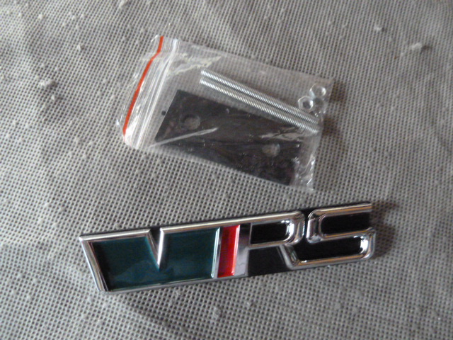

Time for a bit of an update. After fitting the replacement grill centre I just needed to fit a new badge. I bought a bolt on version from ebay
However once fitted it sat in the wrong place so ended up using the original and sticking it to the grill

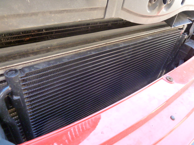

After noticing the air con wasn't blowing cold and having a low pressure fault on the VCDS scan I too the car for a regas only to be told that it wasn't low pressure, it was completely empty!! A leaking condenser was diagnosed so I replaced it. Forgot to take pics during but here it is all fitted
Back for a regas and test and all is cool in the air con department now :cool:

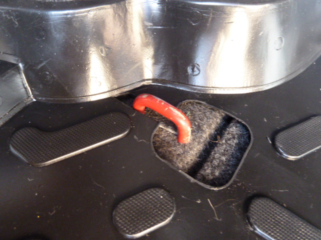

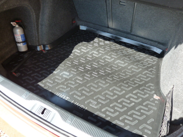

Bought a boot liner from ebay and fitted it
Sadly it is about 20mm too narrow so I had to cut some extra slots for the load lashing points

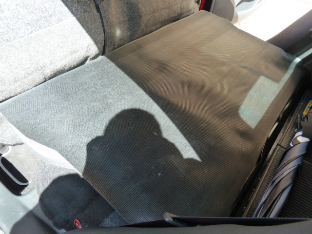

Still it's not bad for 16 quid and will protect the boot carpet. Decided to try and make a mat to cover the rear seat backs when they are folded so using some rubber sheeting I had in the garage I got cutting. Turned out OK

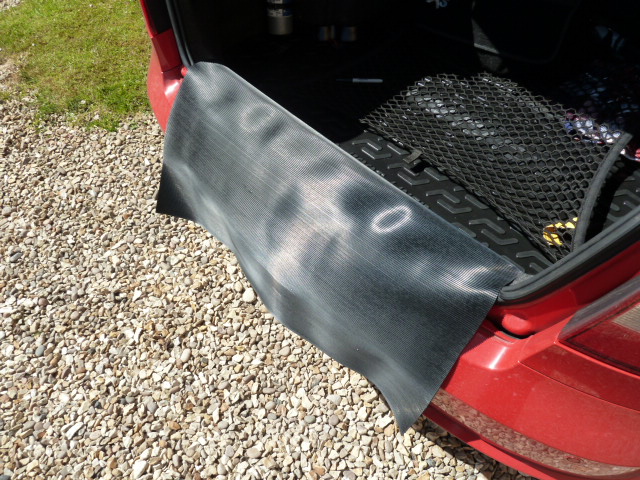

Also decided to cut a piece to save the rear bumper when loading and unloading the boot
