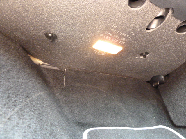

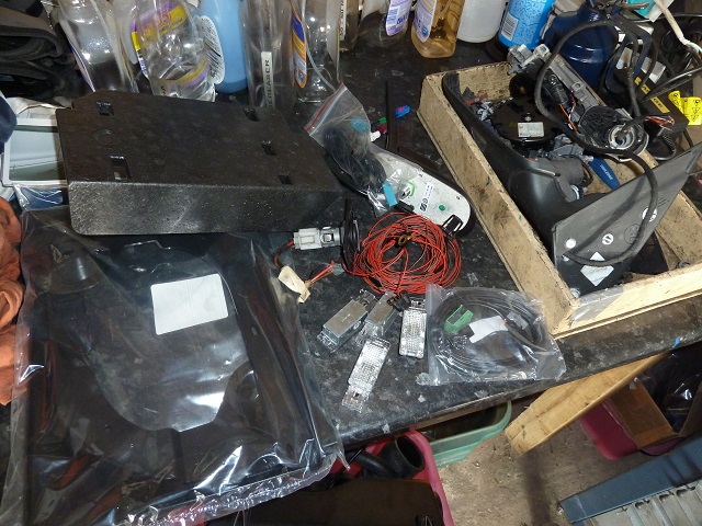

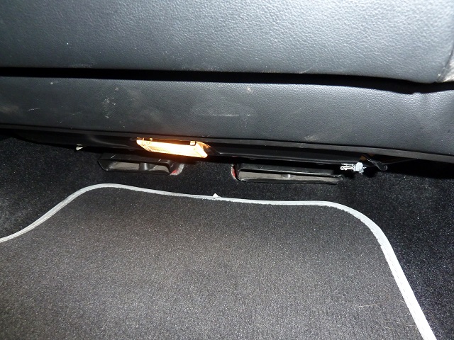

With the 'parts ready to fit to the Octavia' pile getting bigger in the garage I decided it was about time to start fitting them to the carP1040019.1.jpg.e6a6b8739f5fc94bb99e7fe92e44efbc.jpg

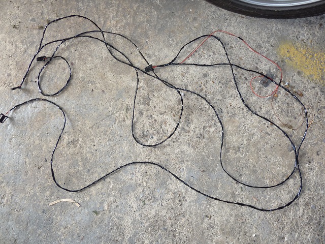

First off was the footwell lighting so I sorted out the loom and taped it up

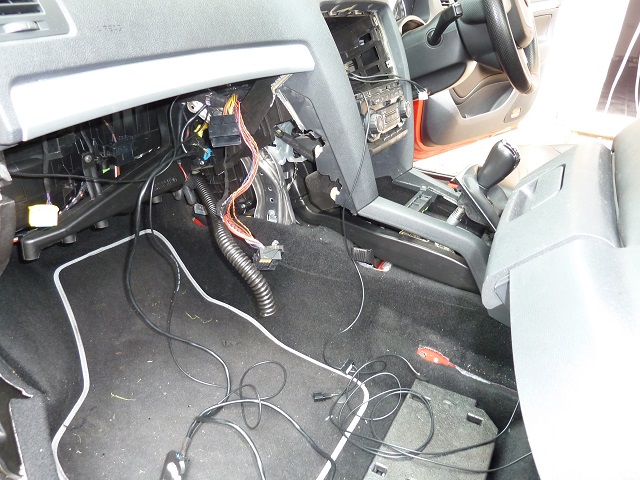

Then it was out with the glovebox and drivers side lower dash to help feeding the looms through. Plus I wanted to retrieve the Bluetooth box from behind the glovebox and fit in its correct position under the passenger seat
Seats were lifted up to help with the rear footwell lights going in. I think the previous owner must have had a party in the car as I keep finding little coloured stars everywhere
Also took the opportunity to remove this
and this
to replace with this
Got it all back together after hovering out all of the stars and finished up with

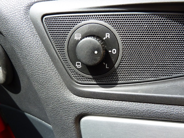

I also had a set of door mirrors with puddle lights & electric folding to fit. Passenger was a case of just swapping over but the drivers had been smashed so I used the parts to build my original to the uprated spec. Forgot to take pics of the during but they are on with the lights working
And with the correct switch fitted
Sadly my door controllers are not the right spec to support the folding function but this should be sorted when the postman arrives today.

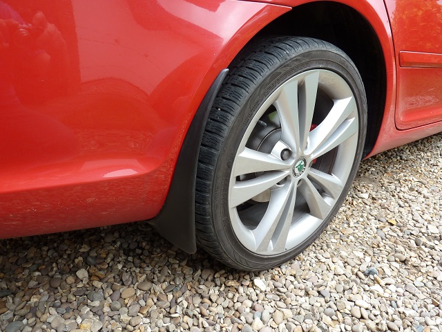

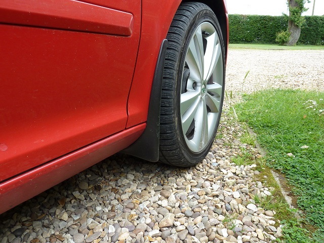

I fitted my mud flaps

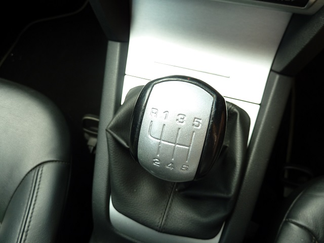

And after the chrome had stared to peel off of the gearknob insert I gave it a quick paint as a temporary measure until I get around to ordering a new one. Turned out OK so I may keep it like this if the paint lasts

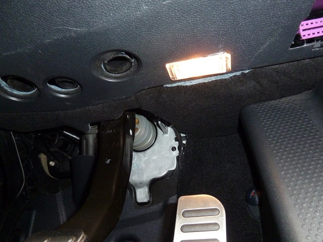

Have you got a pic of the front passenger footwell light fitted and was the puddle lights plug and play?
25 minutes ago, Baileydog said:
Looking good!
Thanks. Here's the pic of the passenger footwell
bar a bit of coding with VCDS they are pretty much plug and play. More details can be found in this thread

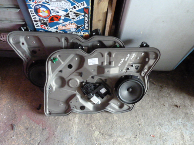

Postman delivered as promised this afternoon and I got a pair of complete front window regulators.
I was only interested in these parts though
It actually worked out cheaper buying the whole lot than getting just the modules. Got them swapped over and I am pleased to say the mirrors now fold on the switch and with a long press of the locking button.
And here's the mirrors in action :cool: Ignore the flies and bird poop, I'll wash it tomorrow

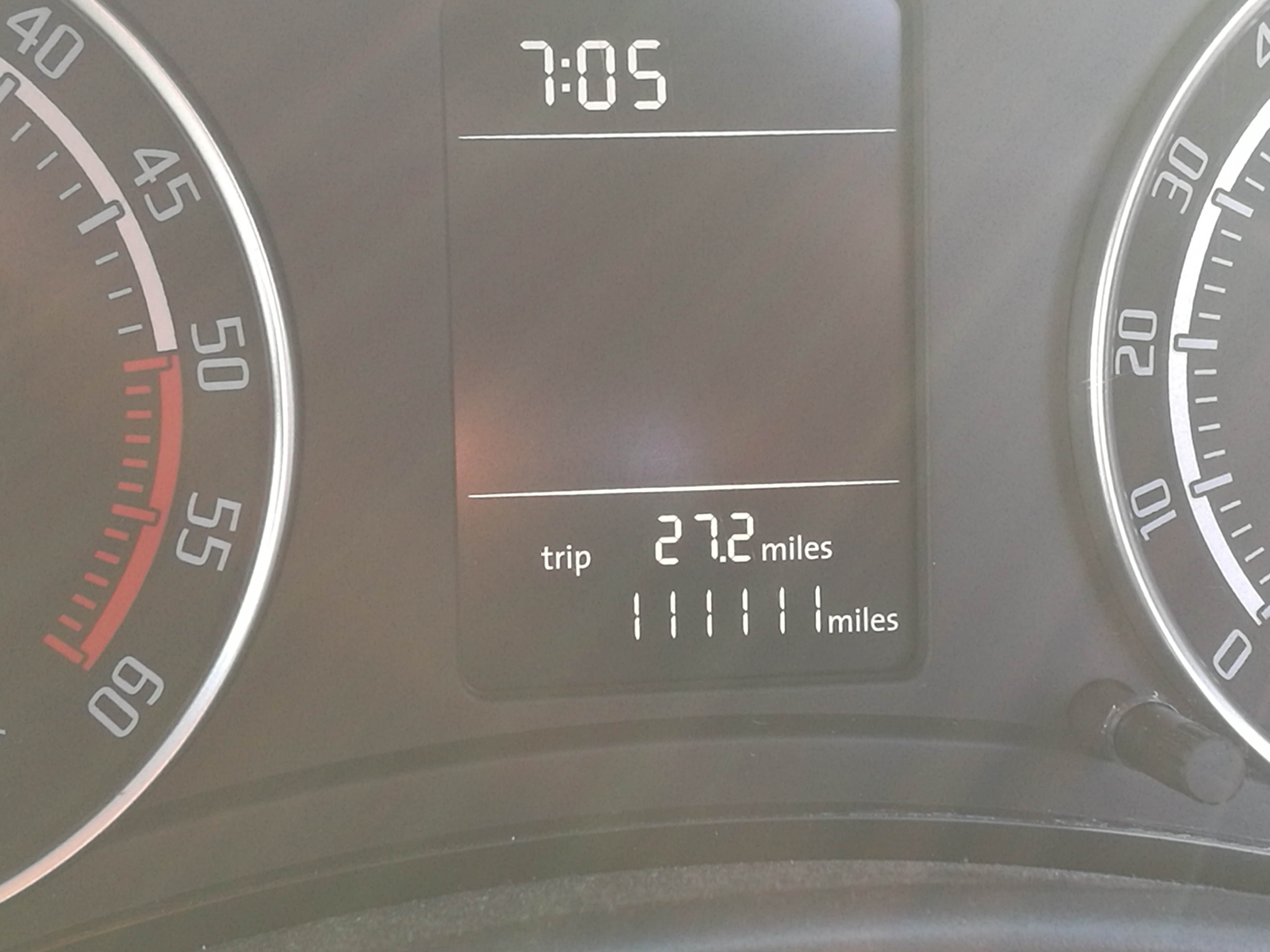

Hit all the 1's after arriving at work this morning

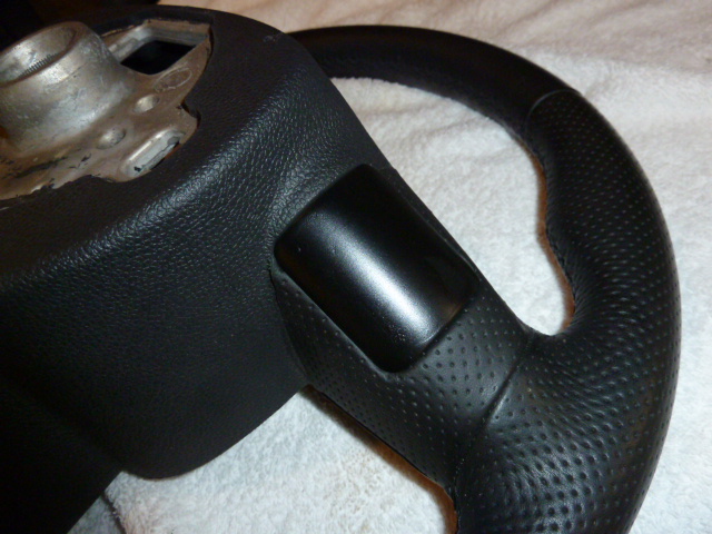

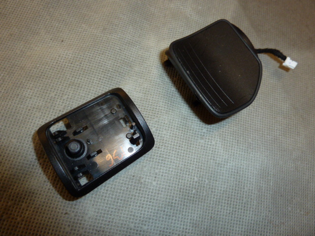

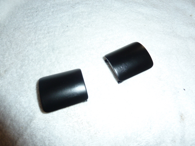

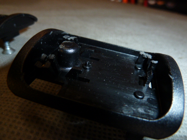

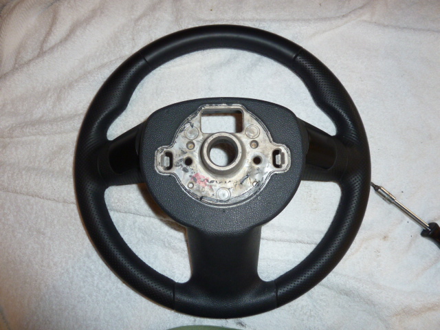

Decided not to go with the Mk3 steering wheel as it meant sourcing a new airbag plus switches as well as the controller so sold it on and bought a Multi-function wheel from a Mk2 FL. As these are only fitted to the DSG cars in the UK it came with paddles so needed sorting to go in my manual car.

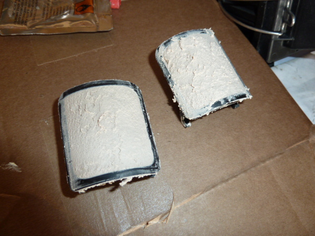

Paddles were removed (one of them it stripped down here)
A bit of trimming needed of the fittings
Then they were filled
Smoothed and painted
And fitted back to the wheel
P1040071.JPG.d57081a983dffec35da6d42e8a73e976.JPGP1040072.JPG.b9958bcfb0ca18ee18138803bfef8545.JPG
I was thinking of getting some perforated leather of carbon vinyl and covering them but I think they look ok painted.

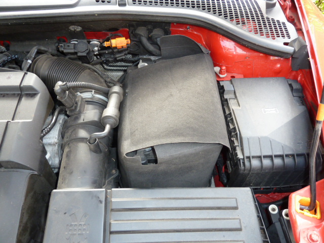

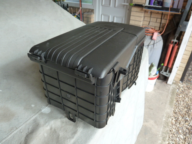

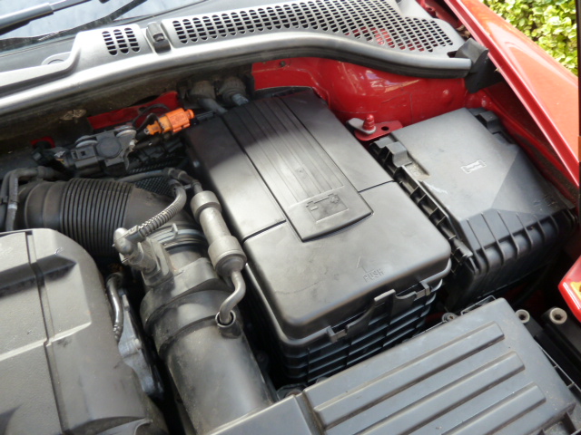

Under the bonnet I never liked the look of the flimsy battery cover, plus it never seemed to fit right
So I bought this on e-bay, brand new from china for about 12 quid delivered
And fitted it
Looks a lot better now :cool:

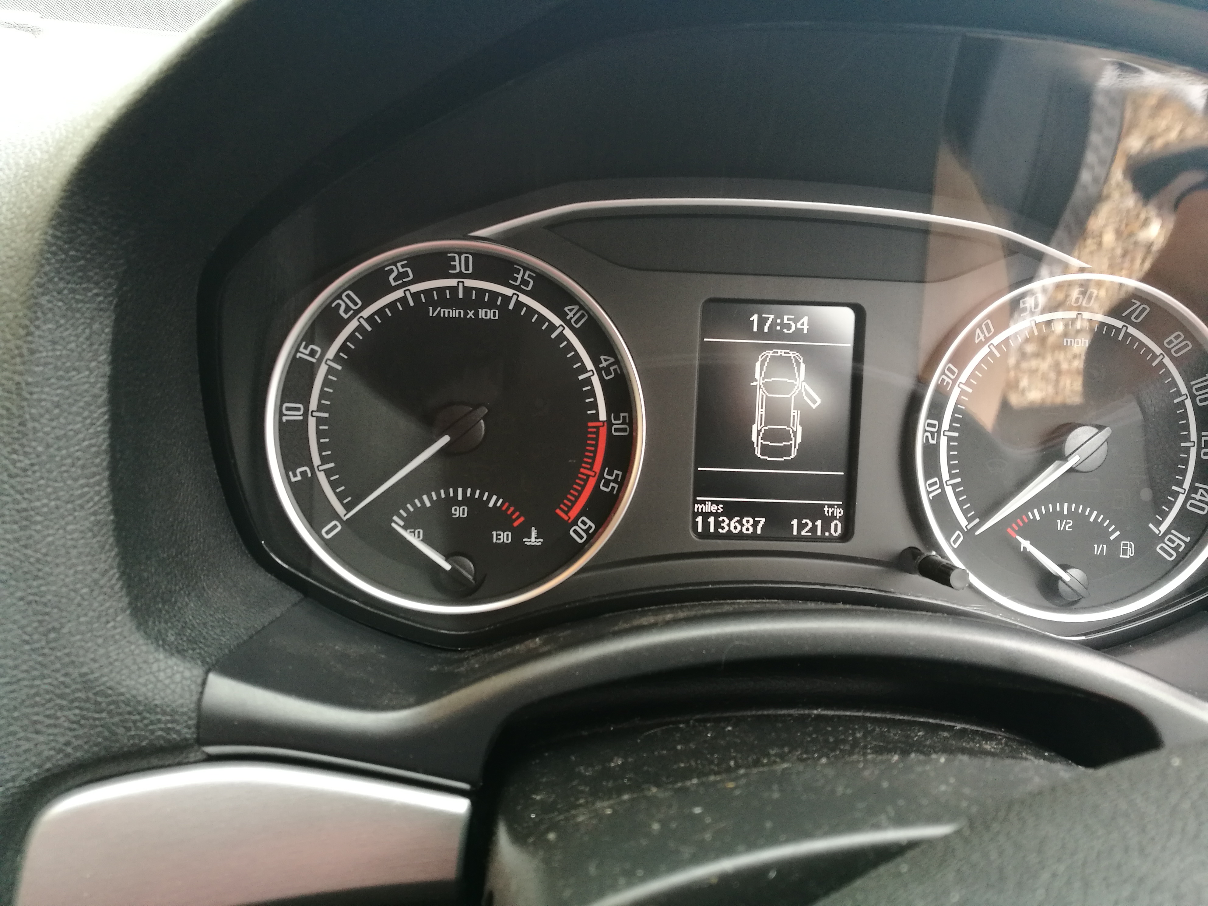

Next up hopefully is a colour coded grill surround and getting my Maxidot cluster fitted
Took a trip over to see Eddie-NL today and he worked his magic changing this
To this

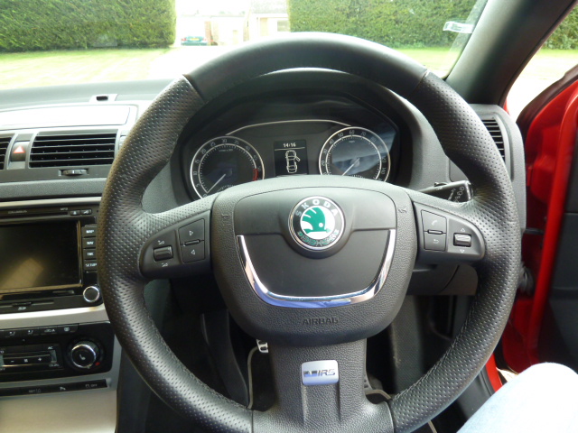

Finally had a bit of spare time today so I took the opportunity to fit the MFSW and as everyone likes pics, here it is!
Just need to source a new set of control stalks so I can loose the trip buttons on the right hand side

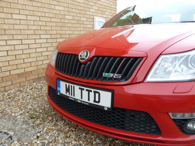

Colour coded grill was fitted along with some 'VRS' stripes
Looks so much better than the chrome grill. Why Skoda didn't do this as standard on the VRS I don't know

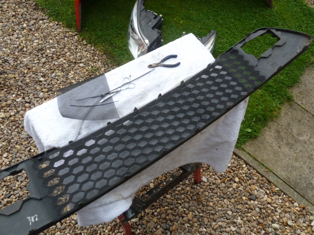

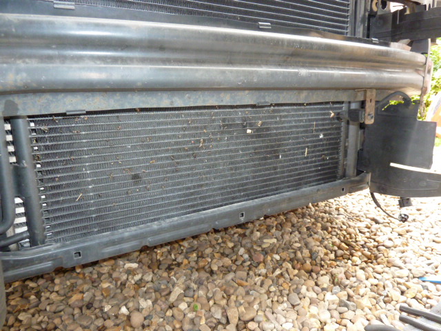

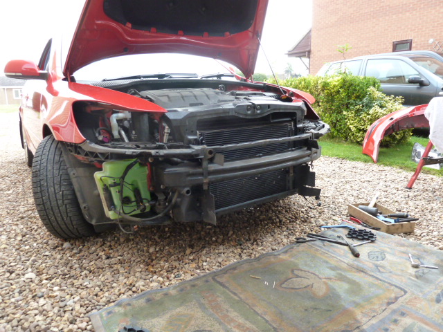

Latest 'upgrade' I have made to the car is more of a preventative one. When I replaced the condenser for the air con I noticed it was pretty battered at the bottom due to the fairly open grill on the VRS bumper. A bit of research threw up a couple of solutions to help with the problem so...
The bumper was removed
Condenser already showing some debris after a couple of months

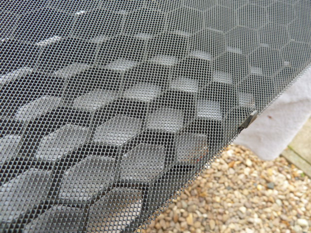

Lower grill was removed from the bumper so I could attach the mesh which was the solution I decided to go for. The mesh itself was a couple of quid delivered from ebay.
And a close up
Fitting was as the Haynes manual says simply the reverse of removal :D Once back on the car the lower grill looks a little darker then normal, otherwise you can hardly tell the mesh is fitted

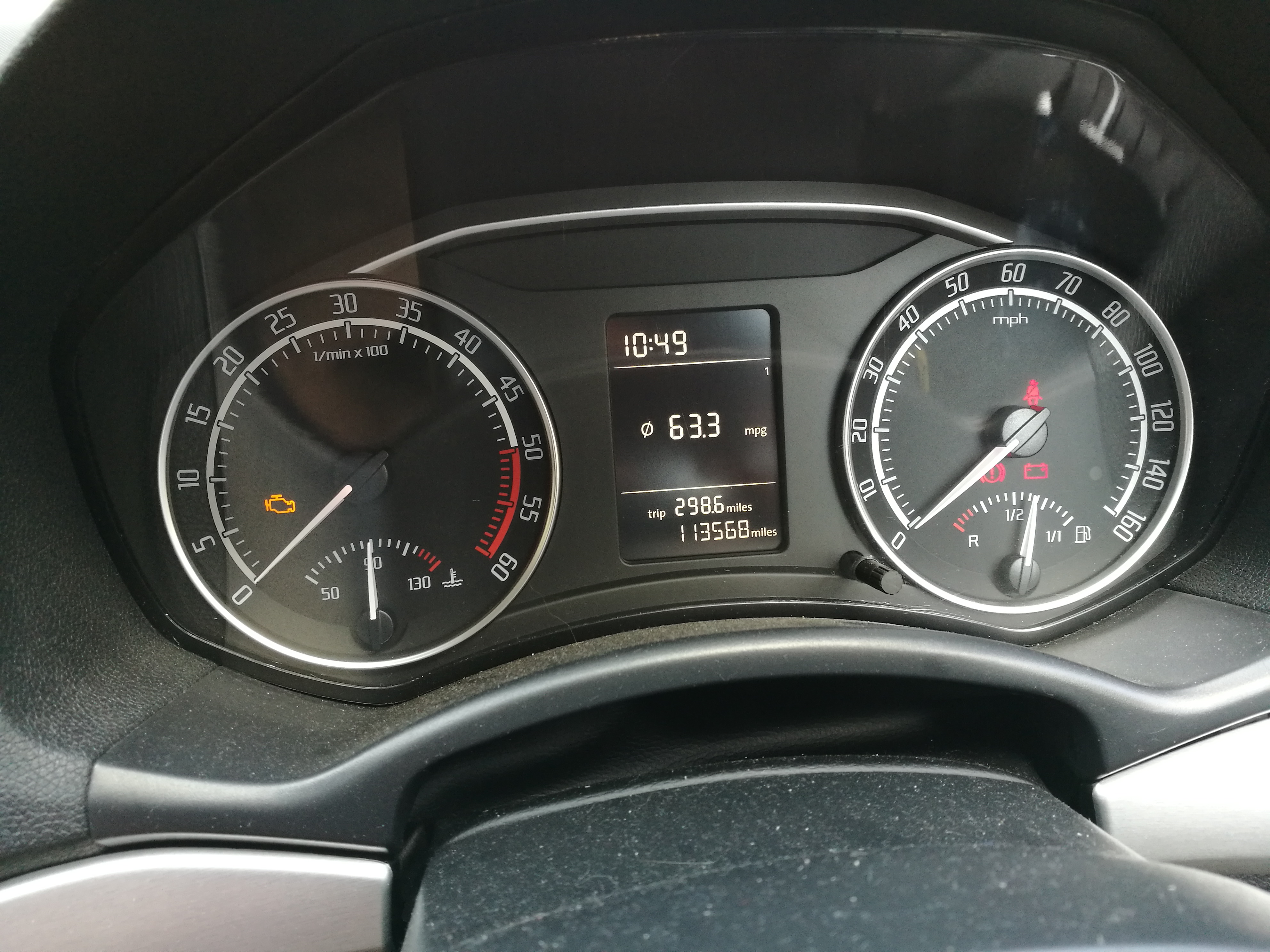

Due to the pretty rubbish weather we have been having recently I haven't really done much to the car apart from driving it and getting it really filthy (no pics as I am too embarrassed to display my laziness on this forum) Anyway before Xmas I noticed the temp gauge dropping when sat in traffic or when the heaters were on full. Looked like the thermostat was starting to get a bit tired in its operation. As it was coming up to it's next cambelt change (due at next service) I decided to get it all done in one go. Normally I would do something like this myself but as it's winter and cold and wet and generally horrible I booked it into my mates new garage to have the work done. Just before it was due to go in I noticed a rattling coming from the front suspension when going over bumps, a quick check revealed a broken drivers side spring so both fronts were dully replaced as well.

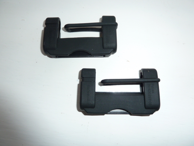

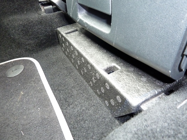

Anyway enough rambling... One thing that annoyed me with the car was the rattling of the passenger seatbelt on the B pillar when that belt wasn't being used. Boredom browsing on Aliexpress through up these rubber covers for the buckles. At £4.10 delivered I took a gamble and ordered them, delivery from China took just over a week.
Got them fitted
And despite a bit of resistance when pulling the seatbelt on they work really well in pretty much killing the sound of the buckle rattling against the B pillar.

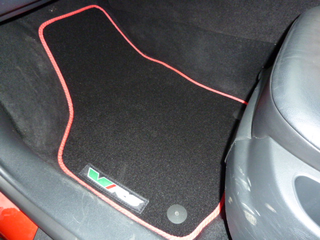

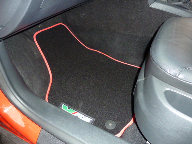

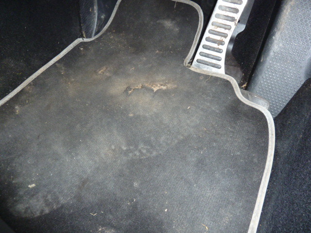

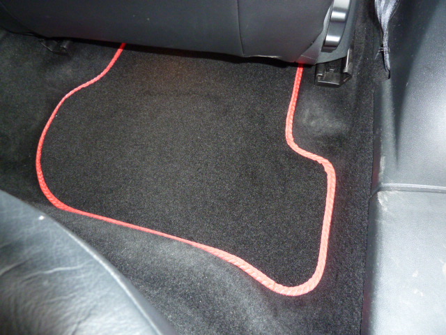

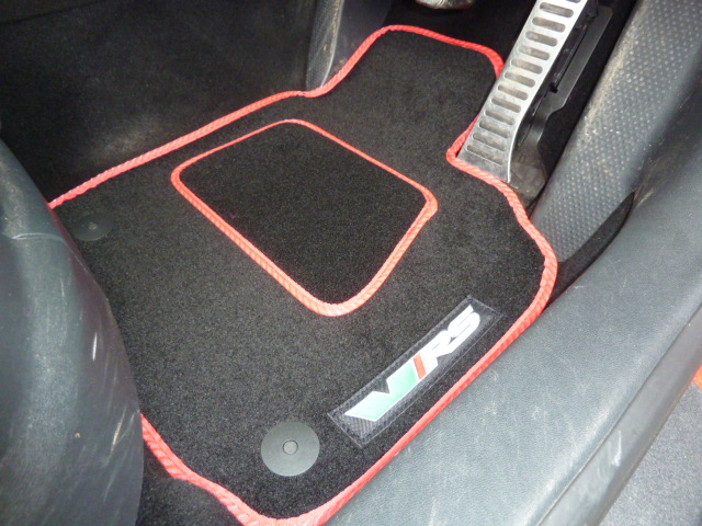

Made the most of the dry day and hovered the car out so I could fit my new mats. Excuse the rest of the marks and muck, a full valet will be done once the weather gets a bit warmer
Before
And after
Passenger front
Rear

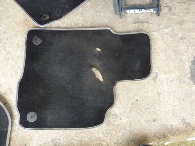

Once out the wear to the drivers mat was a lot more noticeable. Shame really as the other 3 are pretty much like brand new.

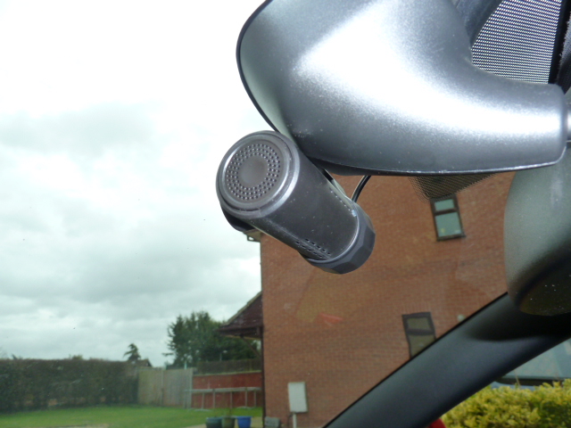

Suddenly remembered that I had made a couple of other additions that I hadn't recorded on here . 1st my dash cam. It's a cheap one from ebay but it fits nicely behind the mirror and the picture quality is OK. Currently it is powered from the 12v socket in the centre console, another warmer weather job is to hard wire it to the fuse box.

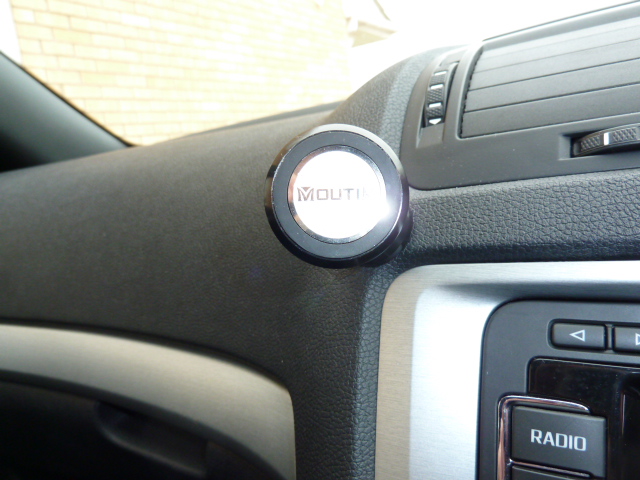

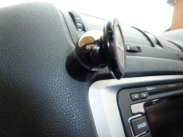

2nd addition is my phone holder
P1040161.JPG.e19ac9e024044b6c5f629b34500de3a5.JPGP1040162.JPG.f275139fdebefcd12544be27c239a6c0.JPG
It's a magnetic type and comes with a stick on 'plate' for the back of my phone. Been using it for 3 months or so with no problems to report so far.
