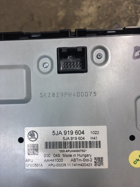

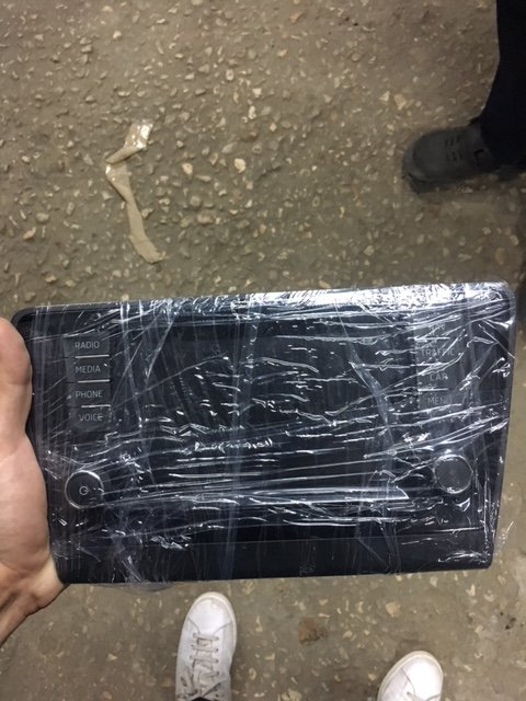

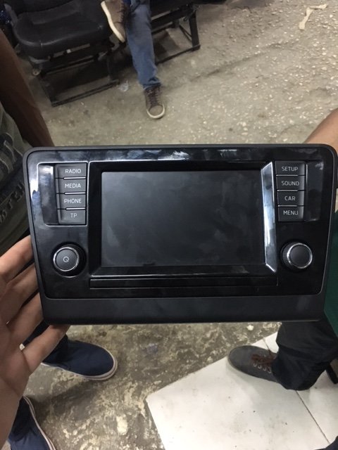

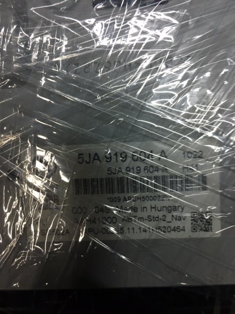

So i got my skoda rapid back in 2015 with the swing radio, i want to upgrade my system Columbus / Amundsen
I found 2 options used parts that i need help to confirm
1- can they be installed in my car
2- does this device have apple CarPlay
3- will everything be smooth with the upgrade
The 2 options are
1- 5JA919604  1022 - H41
APU AAH41000 ABTm-STD-2
or
2- 5JA919604  1022 - H41
APU AAH41000 ABTm-STd- 2_NAV
Images below
Much appreciated
I am also looking to upgrade from the Swing radio in a MY14 Rapid, so keen to hear some advice for Ayoussef
Component Protection will likely scupper your efforts. The control boxes are tied to the car they were originally fitted to, and putting them in another vehicle will lock them and make them unusable. Main dealers may be able to carry out an upgrade and register a new unit for your car, but one which has been registered in another vehicle will be very tricky, and main dealers will unlikely be able to help.
