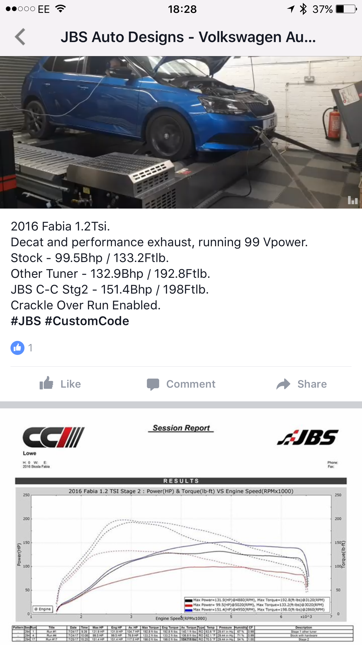

My mate Adam has just gone stage 2 on his Fabia 1.2 TSi
Like McDonald's, he's loving it!

Wicked! That must of cost a few bob!
What crackle over run btw
What costs is a De-cat on a modern petrol car and your insurance not paying out to you if there was an accident & a loss adjuster is checking out your car,
that is not paying out to the owner, but paying out to the 3rd parties & then go after the policy holder for that money because of an undeclared mod,
and a De-cat is very likely to be undeclared since it is illegal for using on the roads.
It's not got decat, it's got a Sports cat (at the minute anyway) so fully legal :thumbup:
He paid about £1200 for sports cat and system, but I can get it for £650 now if I wanted (from a different place)
Then he just bought pipercross panel filter (about £30) and remap about £350
JBS are developing hybrid turbo, which he will be getting when it's done and they want £1850 for that.
Then it's an uprated clutch to cope with the power.
After the hybrid turbo he should see 185-195bhp :)
@James777 Crackle over-run is when your exhaust makes a fast popping noise after you lift off the pedal... like a rally car
Edited by Damo
^^^ Is that an ar53 covering statement that your mate needs to have made?
Why do people online post their car mods saying "Decat and performance exhaust".  then when this is questioned it turns out it is a 'Sports cat' fitted.
So the 151.4 bhp was achieved when a Sports Cat was fitted!
Might be because the business removing a cat is as likely to get caught out if ever the officers of the law were checking out the vehicle so best not for customers cars showing as having a Decat.
No cover up involved.
He currently has the sports cat fitted (but he is on about having it removed imminently, hence why he stated that)
Personally for the extra 5-10hp it will give, I would rather stay legal... but you can't make others do as you would, even though they know the risks if caught out.
Those are some sick numbers... What was the stock tune? 90? Just asking because of the dyno numbers.
Going for 190HP range is quite a stretch for the 1.2TSI. The stock crankshaft is forged, so that will help to handle all the power. As for the rest of stock internals, I am not sure what to think. The conrods should hold aswell, unless the engine will be trashed at max power and WOTed on a daily basis. The pistons are made from die-cast aluminium, so they do dissipate extra heat a bit better, and the piston cooling oil jet does help, but heat management is an important factor to consider when going up to that power. Luckily also, the head gasket is a metal one, so should cope with the increased cylinder pressure without much problems.
All in all, the EA211 1.2 TSI is a very well build engine with some good features, and the stock 90 hp tune is almost a disgrace for such a cool machine. :) So going for 190HP with stock internals is ok as long as you keep extra heat in check.
On my 90HP stock tune, I am seeing EGT/Cat temps around 700-750°C under acceleration. Peaked at 800°C under longer higher load applications. The stock header (+integrated exhaust manifold) materials were made for temps up to 950°C max.
Btw, what are his plans for the gearbox? Keeping the stock one? Those are rated at 200Nm (MQ200-5/6F) and the DSG (DQ200-7F) aswell, tho they can both likely hold good up to 300Nm, but not sure about going 300+...
Edited by Recretos
Funny you should ask about his plans, as he is currently putting it all back to standard at the minute, and trading it in for an Audi.
Such a shame, as I would have loved to have seen how far these 1.2 TSi engines can safely go.
Agree with you, 90bhp is ridiculous from such a good base.
And yes, his was a 90 as standard.
Damn, too bad. I was looking forward myself. Tho 190bhp would be at the veeeery limit I would say. The problem would be the gearbox first I believe. High loads, high power, high temps, for a 200Nm rated box would likely be a slow kill when pushing 300 or above. Or a fast one if you would try to speed shift. 300Nm also isnt shaft breaking power, but it could be for a lower rated equipment, and the individual components in the gearbox. The gearbox is also made with weigth and cost reduction in mind, so unlike the engine, is not made for 100% power increase, but is designed to hold stock power. Stage 1 should be fine, but some advanced stuff above 250Nm might pose a risk on the longer term wear and tare.
You can find the same manual gearbox on the Golf 7. The 1.4TSI (90kw) has the same gearbox MF200 as the 1.2 TSI's.
But the 1.4TSI (103+kw) has a different manual gearbox, rated at 250Nm (MQ250-6F-02S). Funny enough tho, the DSG option on this engine is the same gearbox (DQ200-7F-0CW) as found on 1.2TSI's.
So looks like the DSG boxes are beefier, but manuals are not, so they designed a different box for the stronger engines (1.4TSI 103kw, 250Nm).
I’d expect abit more than that from a stage 2 my mate has a stage 1 apr run that took his from 90bhp to 148bhp with no mods bar the map.
