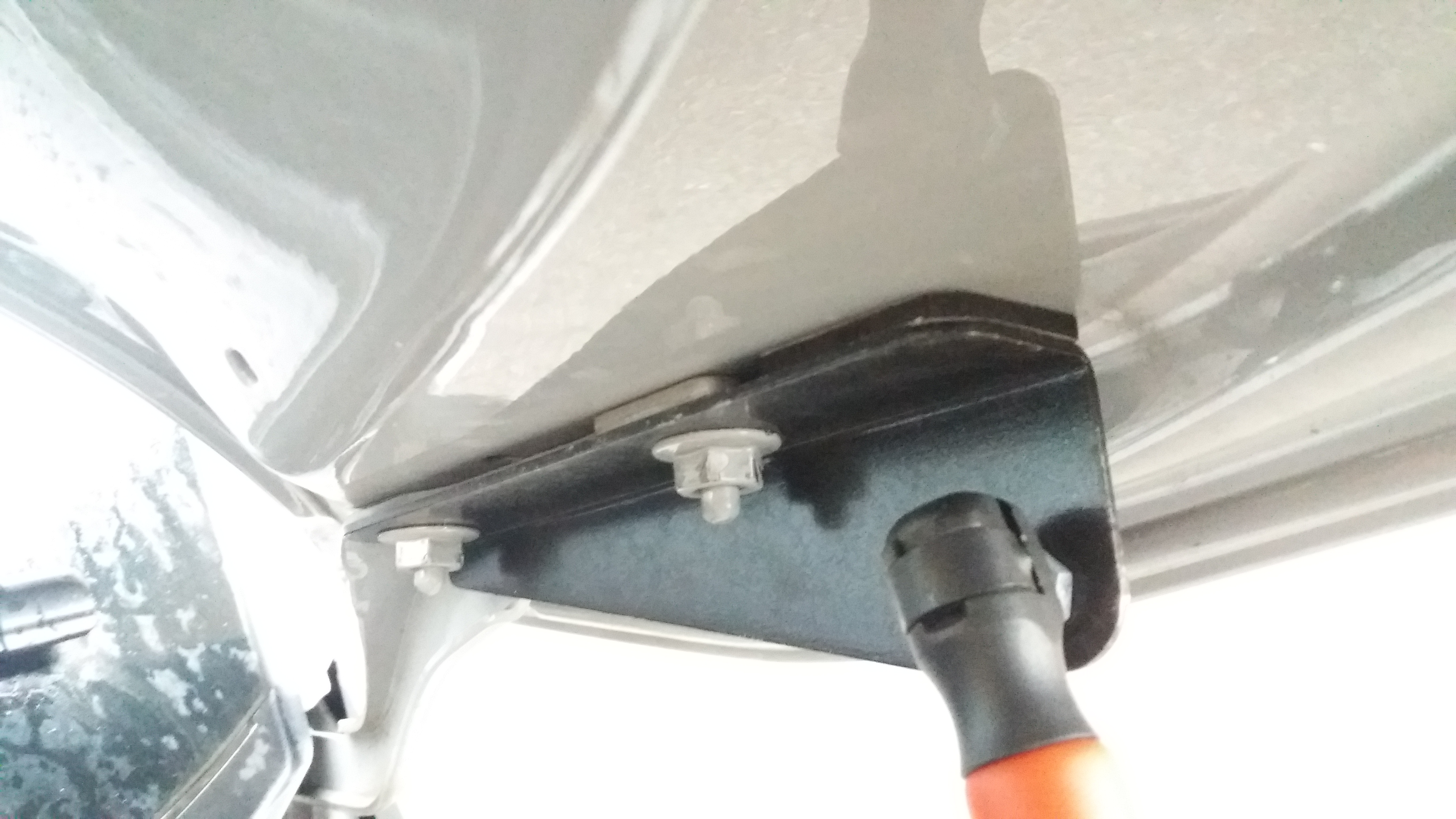

Has anyone else fitted the bonnet struts from superskoda?  I think they are well worth the price, i spent a little extra on resprayng them myself so they match my theme.
However they did put my insurance up as it is apparently classed as a body modification...
I bought Them, but have not yet installed them.
was there a guide with yours? Could you do it by yourself, or was it a two person job?

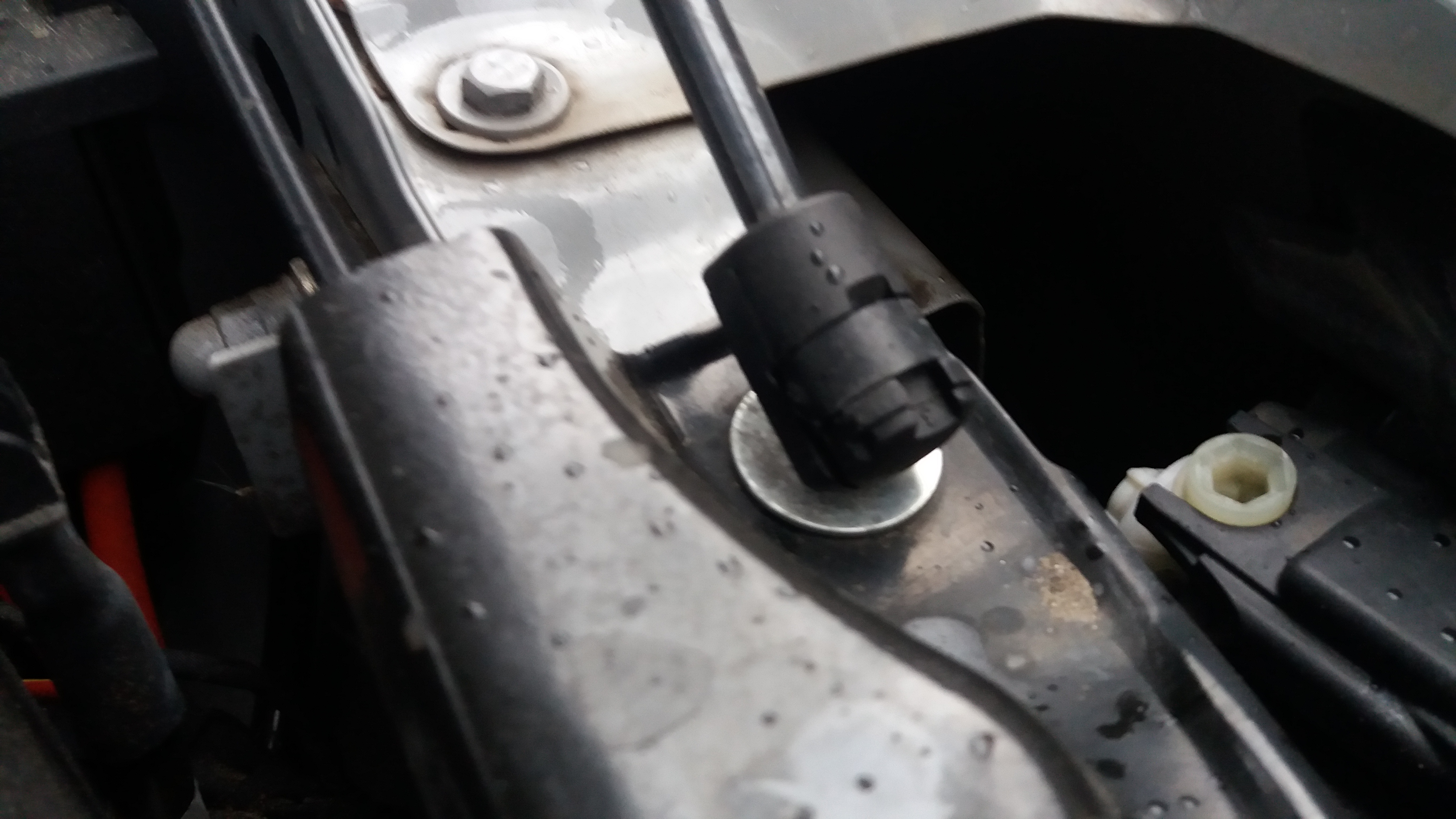

There was no guide, it can be done with out help just make sure everything you need is within reach once you start undoing bolts.
Once you have them on you will notice a bit of a gap under the front of the brackets, i had a bit of 3 or 4mm 3M foam that i cut and put in it to stop paint rubbing. Have fun!
Thanks
can you take a couple of close up fotos of the installment.?
You will also need a washer like in the second image
Edited by Nathanb93
Thank you so much.
And yes I need a washer, that was not included. so that put an end for the work today, since I didn’t have any laying around.

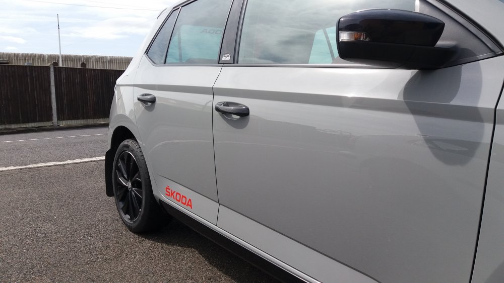

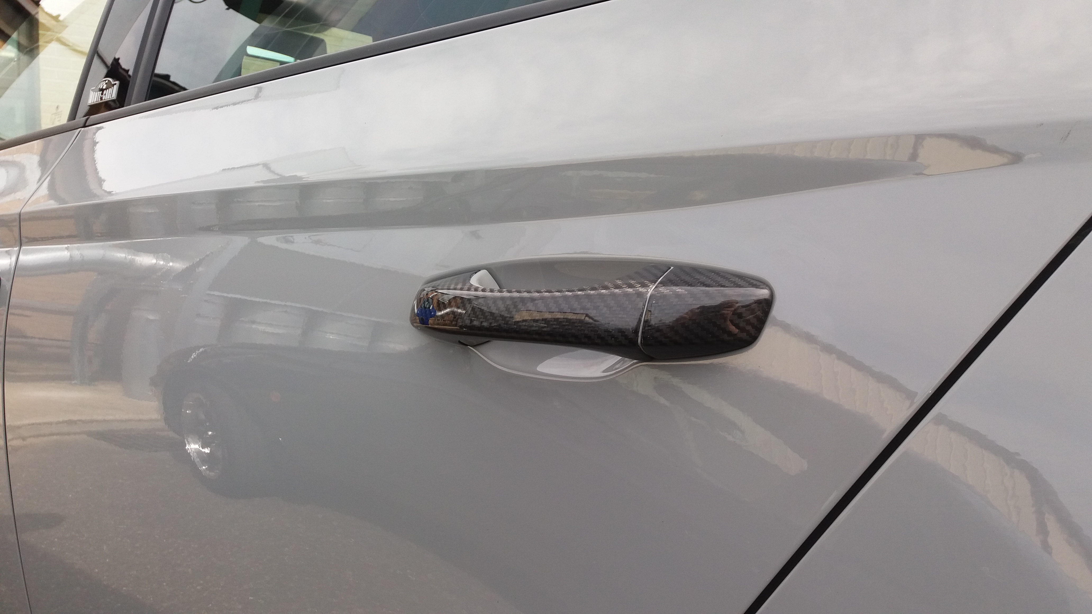

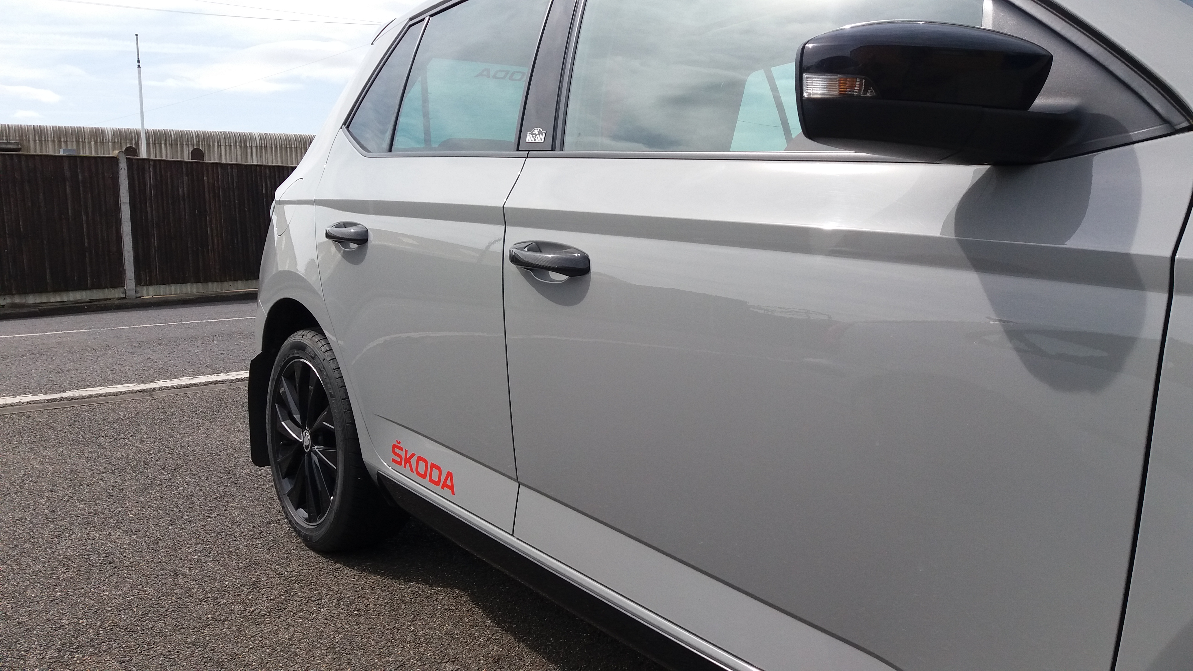

So I bought these carbon fibre door handle cover about a month ago from super skoda and finally got round to fitting them.
Turns out the supplied tape isnt too great and they were far too easy to remove, one was almost falling off on it own... so I have removed them while I search for a better way of fixing them.
Current thoughts are either sillicone or a non sillicone based alternative, body trim tape (dont really trust the tape) or some small stainless steel dome head allen bolts/self tappers on the underside.
Has anyone got any other ideas?
Some guys at work think that sillicone might be too strong and damage the paint on removal and would also be a pain to remove residual sillicone from the paintwork

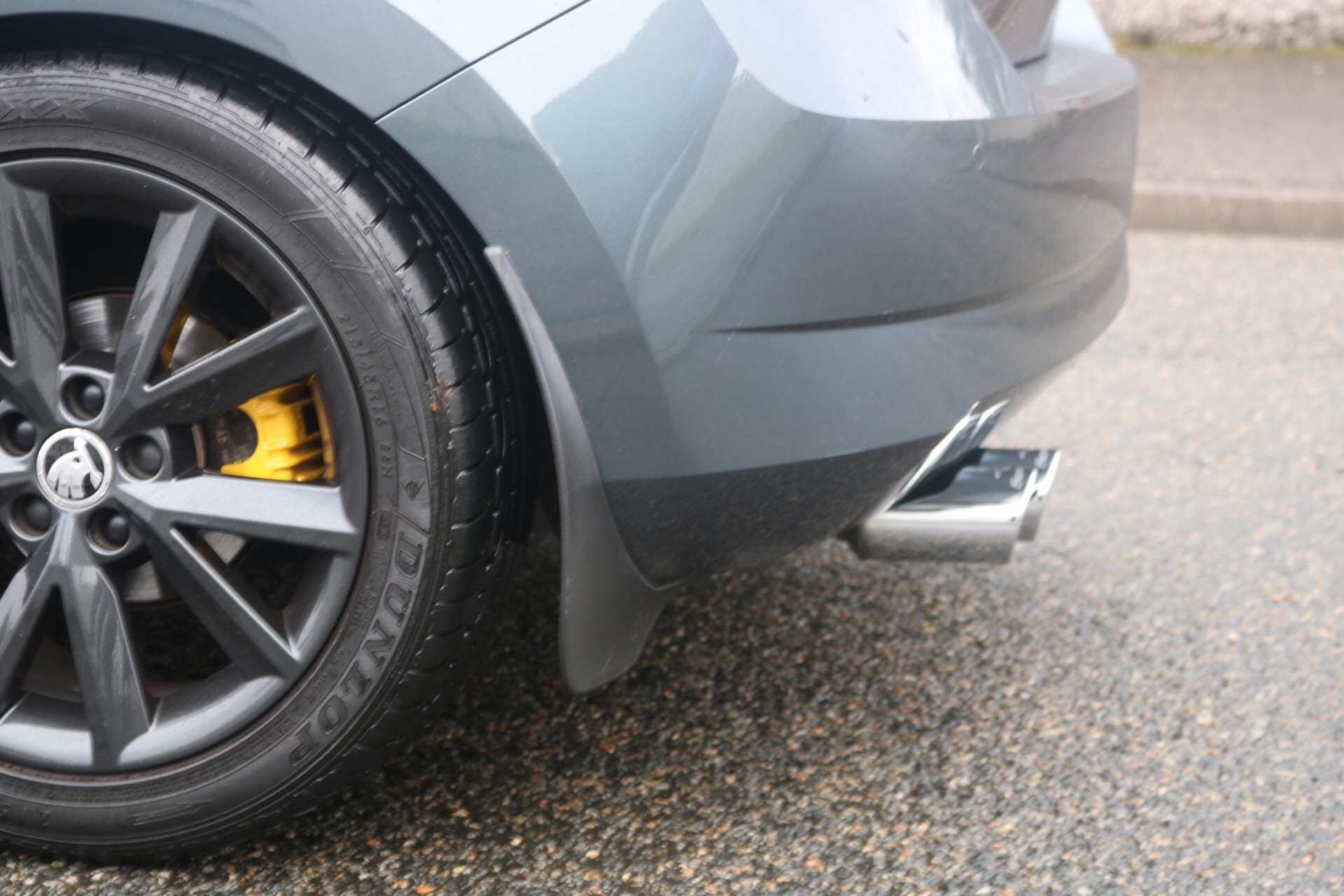

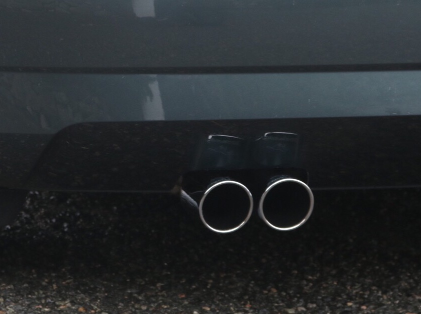

What’s the exhaust you are running?
Davy

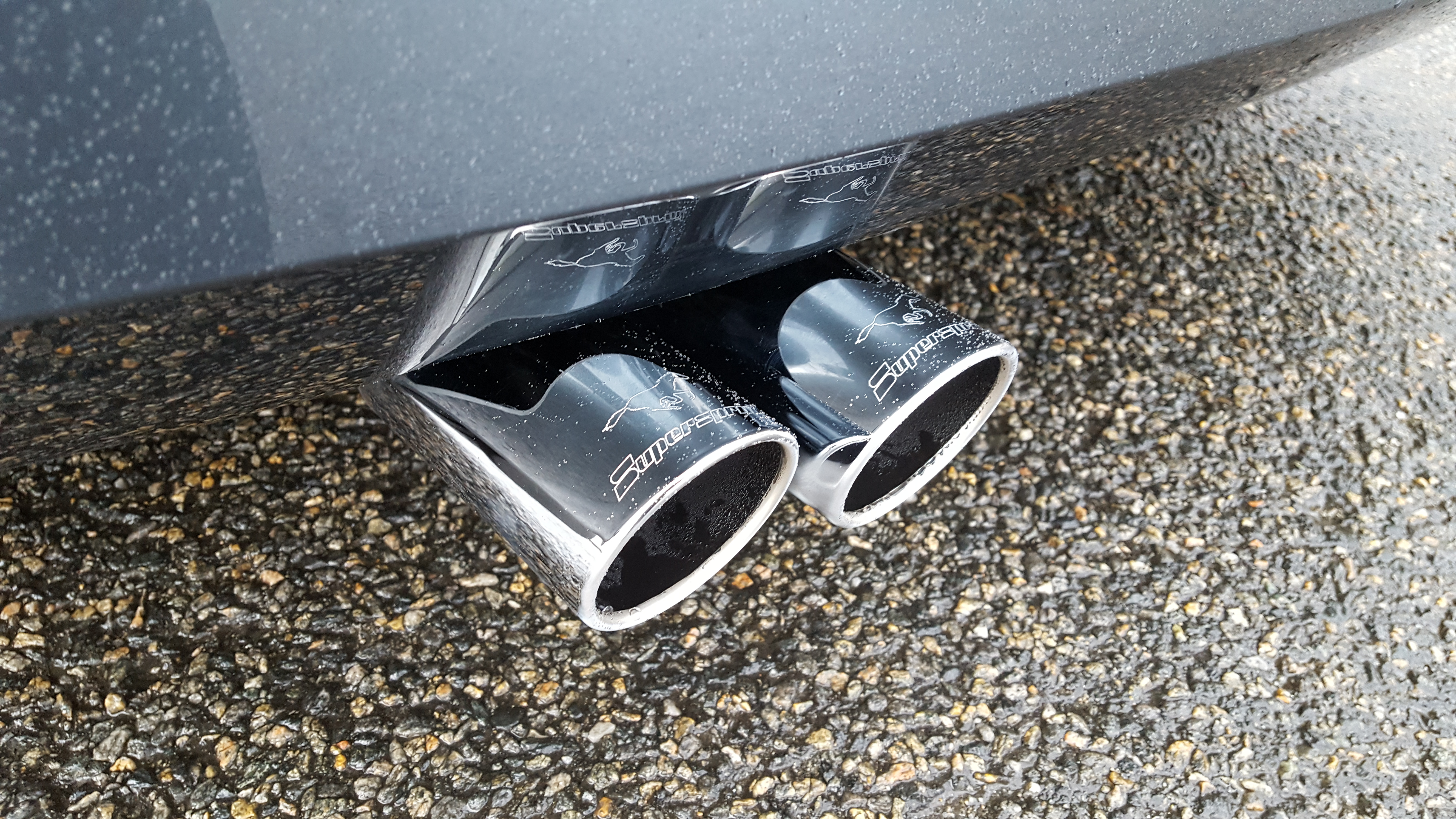

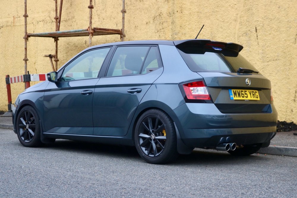

Supersprint exhaust from Italy. Excellent fit but had to cut rear valance. KW coilovers on bottom setting (rear) and mid setting (front) - dampers and springs far better than stock Fabia. Also has Forge Induction Kit and Forge Blow-off Valve.

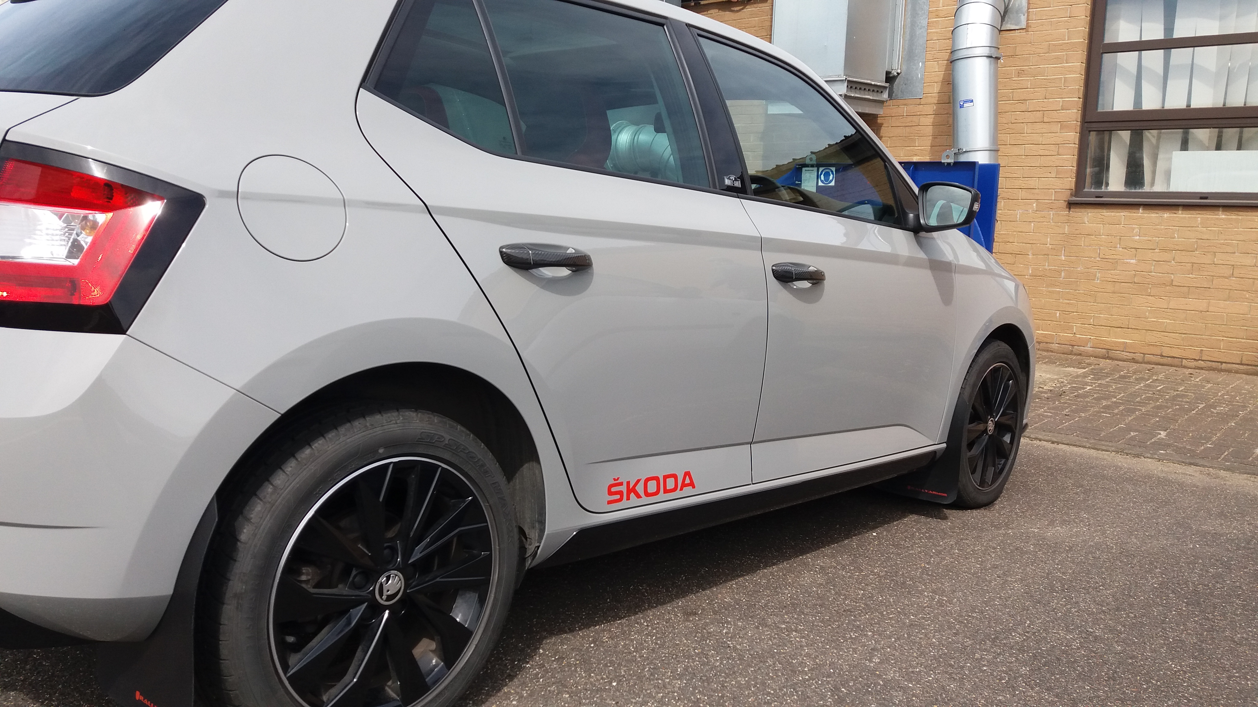

Just incase anyone was wondering, i used a product called CT1. Had loads at work and they also make a non aggressive solvent degreaser to remove it.
Just used a few blobs of clear CT1 and some masking tape to hold it all down while it cured.
Worked great! Ill let you know if it destroys my car when i remove them in future Ha!!

Looks good! Could you show a close up of the cut out For the exhaust?

Love to see a fellow Monte Carlo looking sharp! Have you got 17” alloys? I feel like they’re smaller but it looks awesome lowered. Did you do the exhaust cut out yourself too? I couldn’t bring myself to do it!
How much is it lowered by as well?
Davy
Lemto - not a Monte Carlo, no side skirts or rear diffuser, just a lightly modified SE L. 16” wheels and bodyshop cut the rear bumper.
Skodaboy1983 - hard to say exactly with coilovers but roughly 40mm.
That’s surprising to me, looks eerily similar to my monte! Looks nice either way. Good job mate :)
