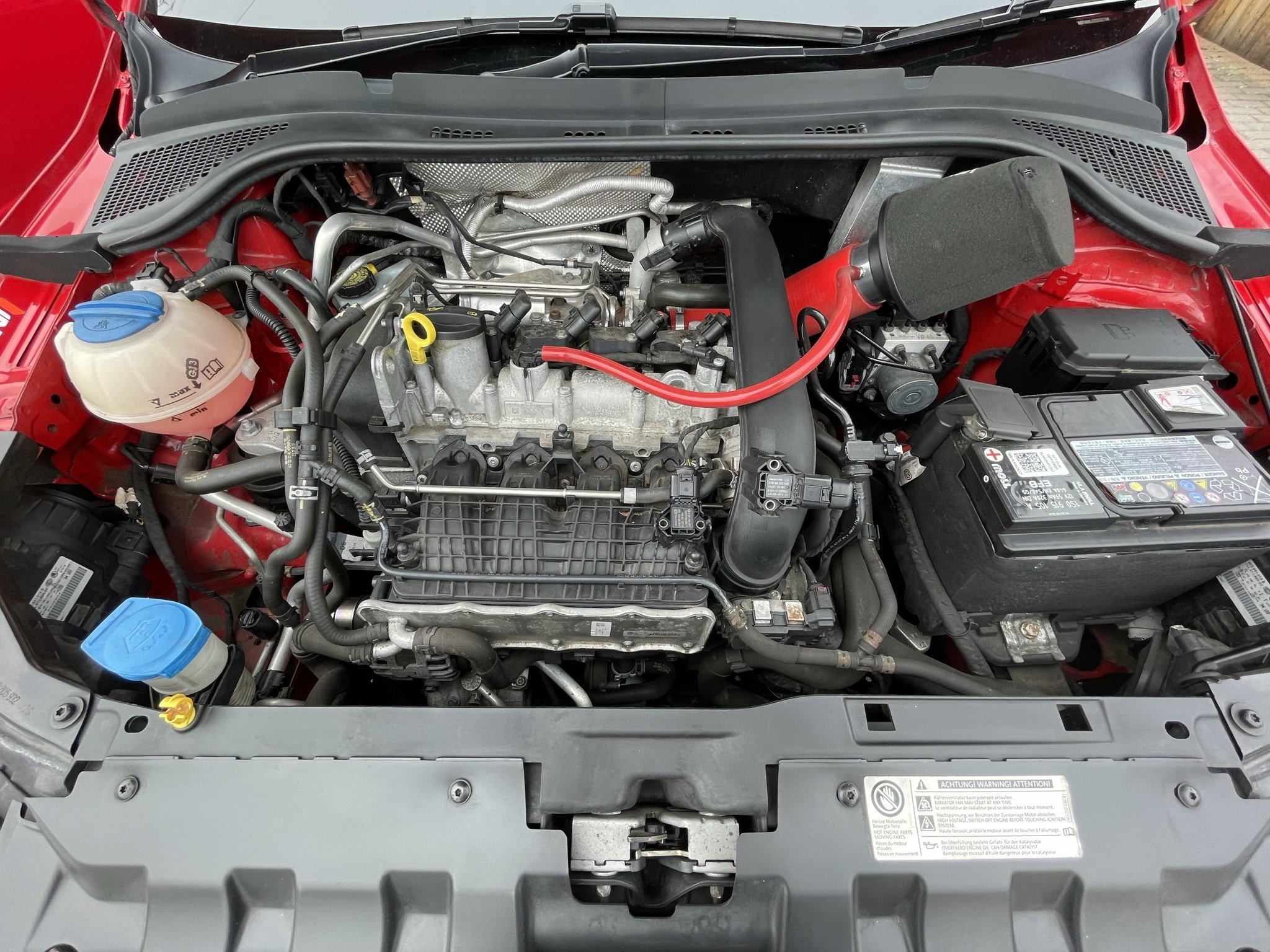

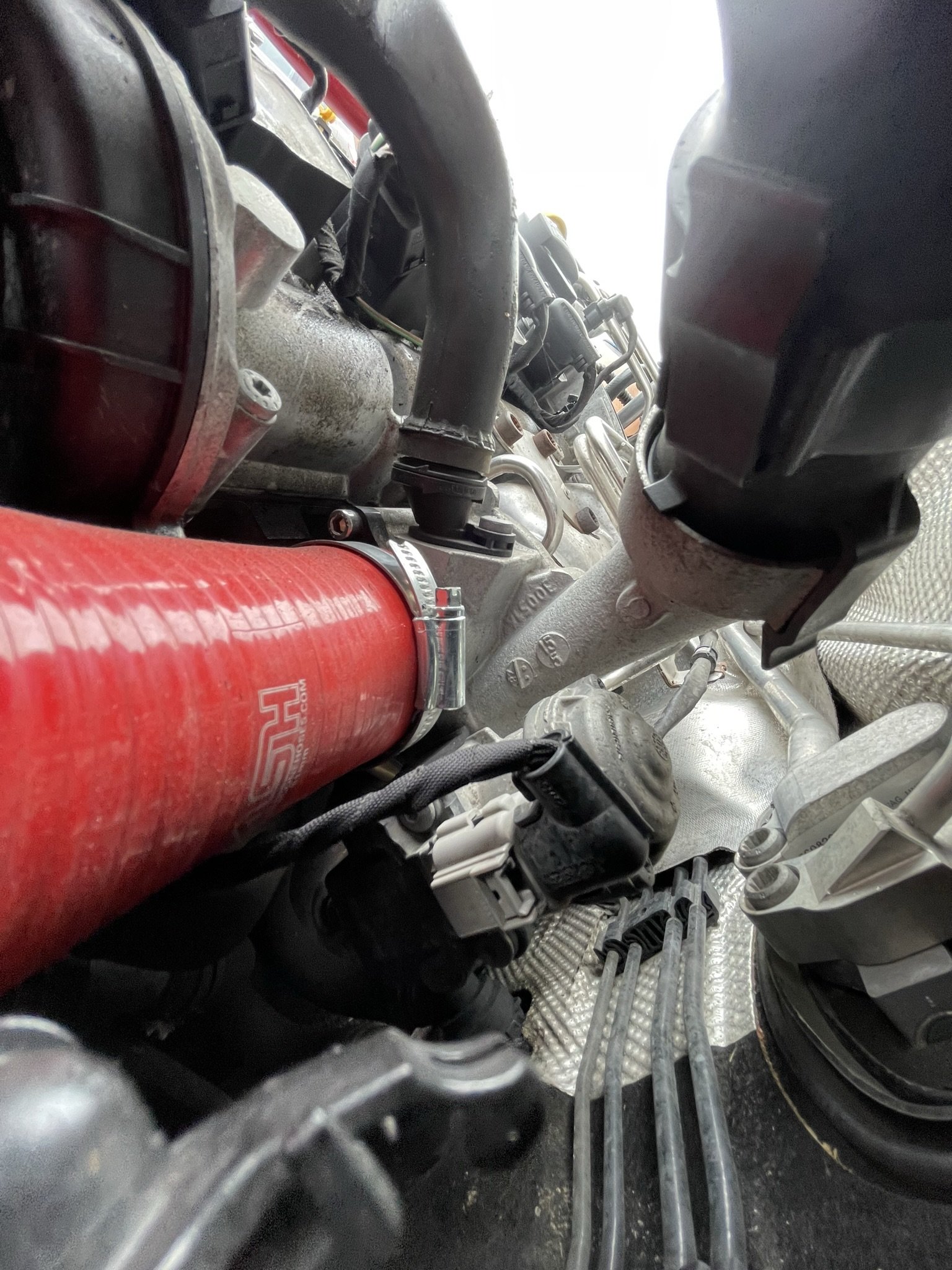

Installed the hoses and turbo inlet adapter. For a small turbo it makes quite a lot of noise now, I can hear baby whistle sounds under light acceleration and full on hissing with wide open throttle.

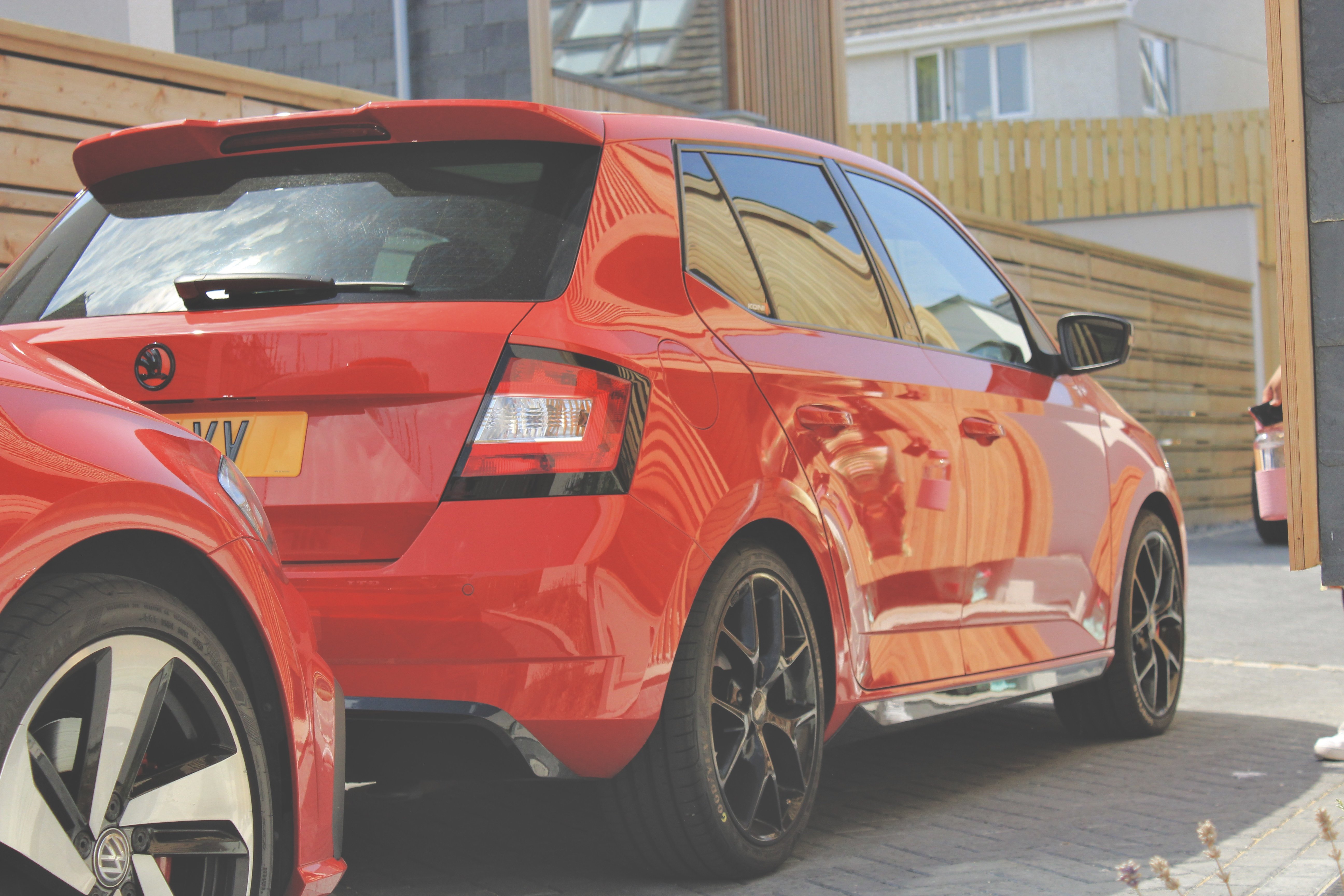

Downpipe (with cat delete) will make it louder somewhat in general, you'll gain maybe 5-10bhp over a stage 1 with a downpipe, with a little more noise but nothing major.
I've attached two pictures of my car running eibach pro-kit springs. Running standard shocks for now, but with shorter rear bump stops from the ibiza cupra r, as it was bottoming out a little too often with the standard bump stops.

It looks amazing!!!
Are the rims 16" or 17"?
Did you change the DP in your car?

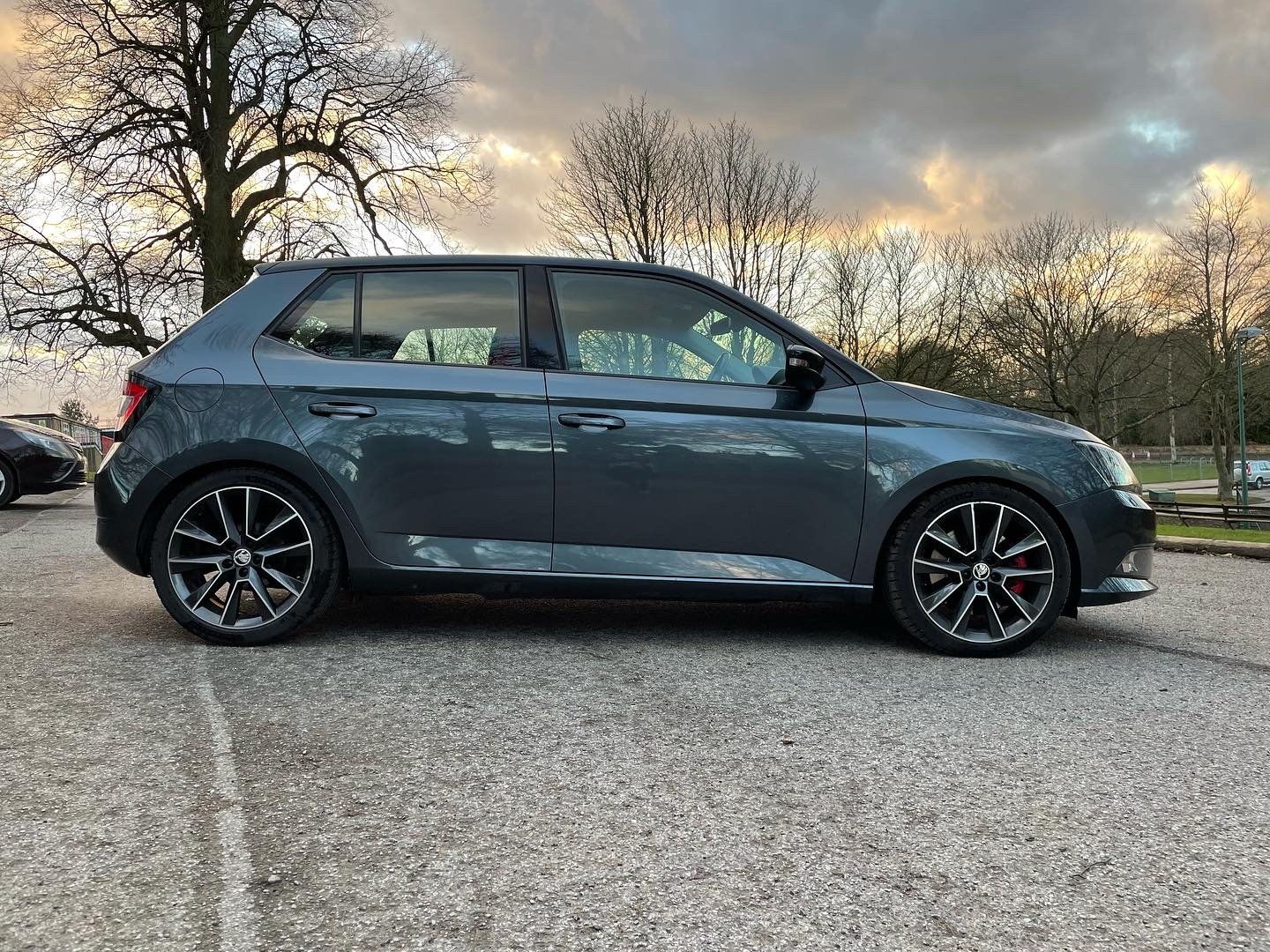

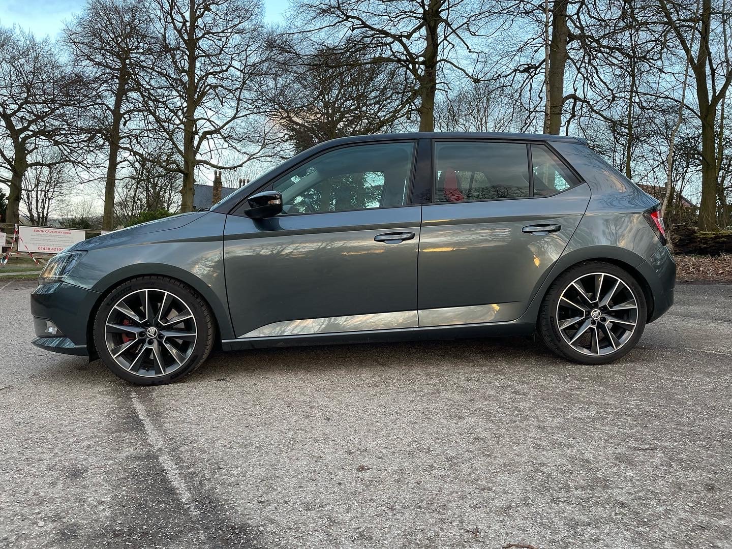

Are these 30mm front and 45mm rear? I'm running these and your has a lot less arch gap.
Yeah they're 30mm front 45mm rear.
I'm also running 7J ET46 wheels with 11mm spacers at front, and 16mm spacers at rear.
I'll hazard a slight guess and assume your aftermarket wheels are 7.5J, which will make the tyres look a little thinner, and it doesnt look like you're running spacers?
That's right, running 7.5j wheels and no spacers. I've been told that spacers are unsafe, but quite a lot of people are running them. I would like the wheels to stick out a little bit, just to make them flush with the arches. Your fitment looks great!
I could push mine out i think another 5mm, but i decided to err on the side of caution to avoid any rubbing.
I've never had any rubbing on mine as they are now, front or rear.
Are yours ET35?

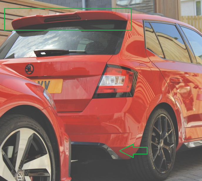

Hi Aviii!
Are the rear spoiler and diffuser OEM or Aftermarket? In case of the latter, where did you buy them?
13 minutes ago, gmontenegro said:
Hi Aviii!
These are standard parts on Monte Carlo trim cars. You can get the parts seperately from dealerships, they are quite expensive though, and usually require painting before fitting.
Thanks!
I'll check in my local dealer or aftermarket suppliers.
3 hours ago, gmontenegro said:
Thanks!
As FabiaGonzales said, they're standard for the Monte Carlos. You can try getting some from breakers, but you may need to separate them from the bumpers.
