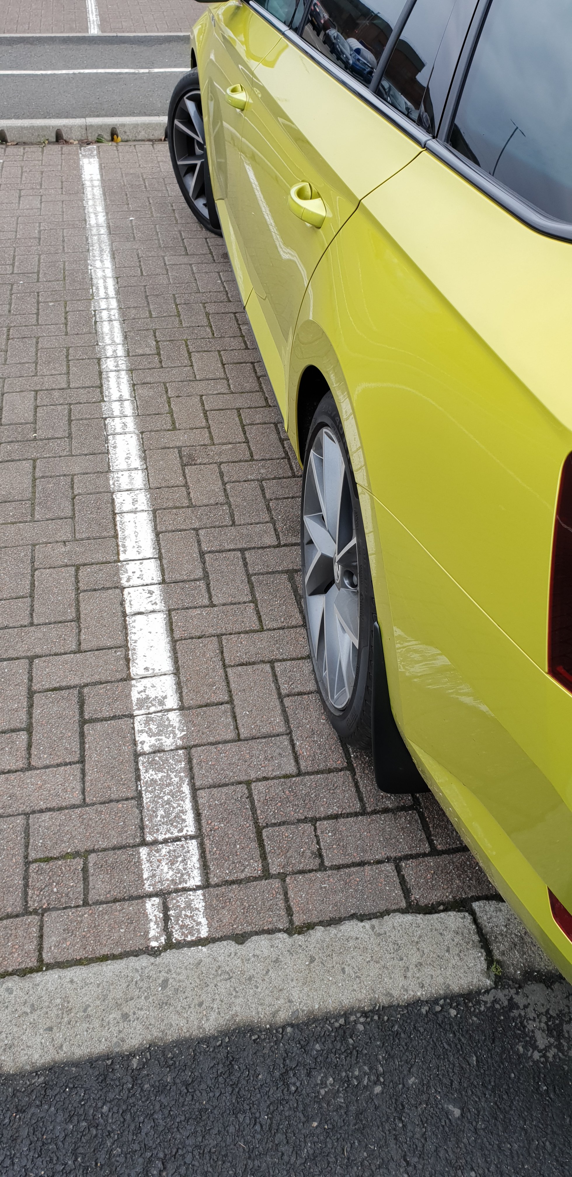

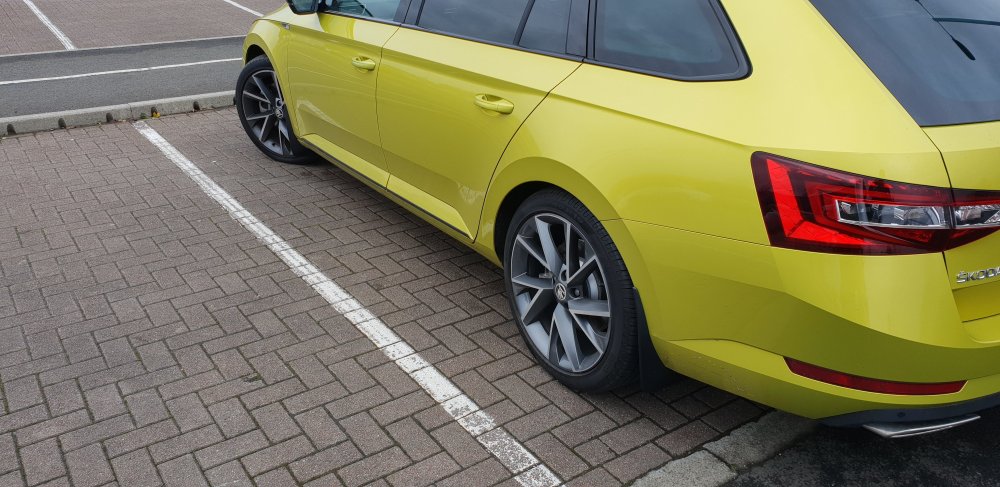

I fitted these to the estate:
3V0075111, 3V0075101
Stunning colour Dee...
Can I ask where you got them and how much?

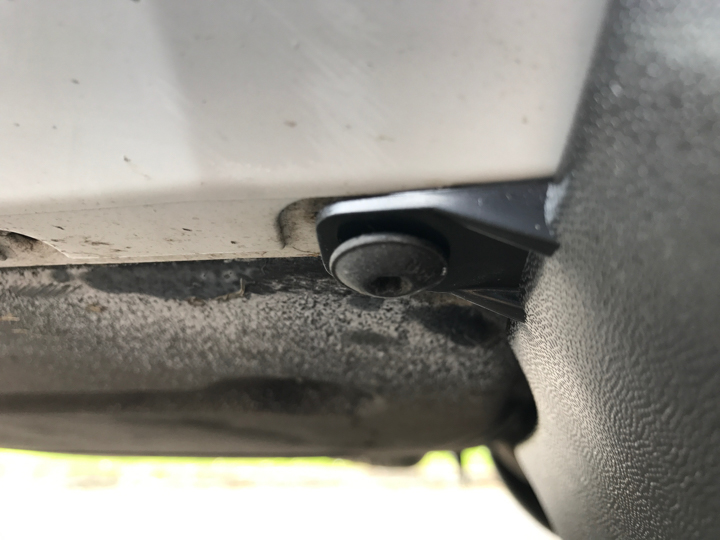

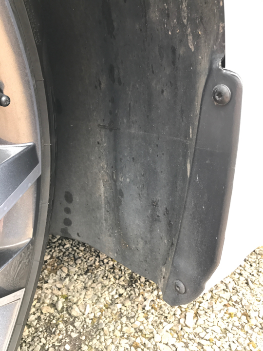

The good news is the quality seems good, time will tell. I fitted them by removing the original torx fittings and then refitting with the flap in place. They look OE and fit well. Fitted in minutes.

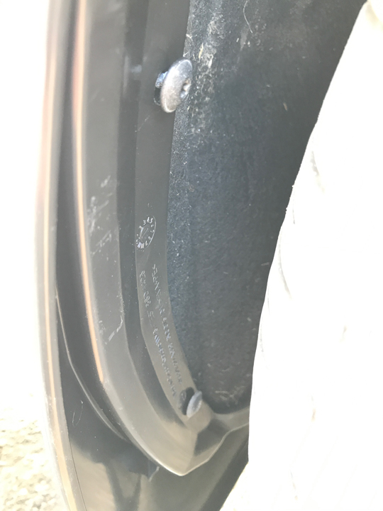

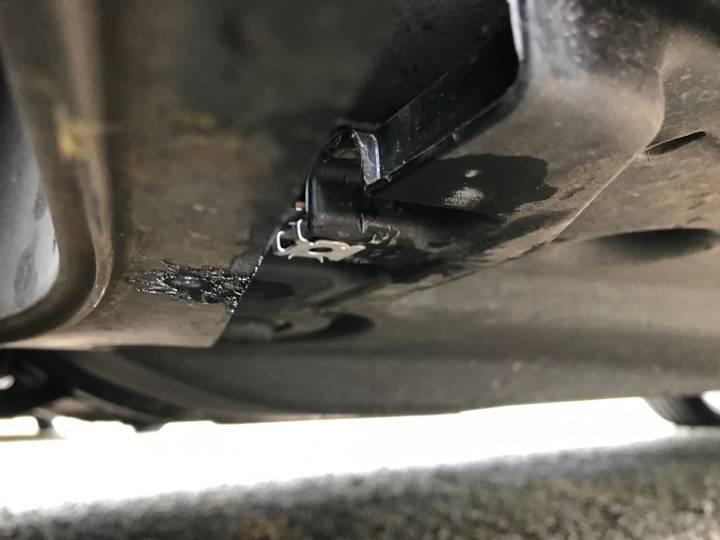

Thanks very much for this guide, found it extremely helpful. Hooks on the rear ones were a bit tricky but I bent them a little open which solved it. Look great!

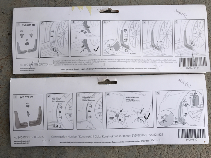

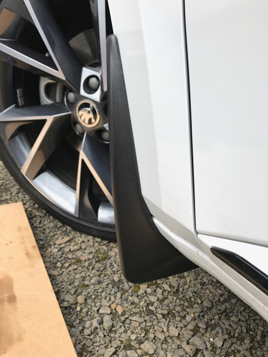

Thanks for the guide. It was a useful reference, although I did mine slightly differently, bolting the flaps in place before drilling the holes. This made sure the plug would fit in the right place.

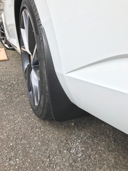

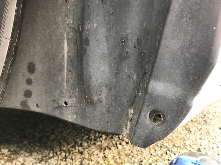

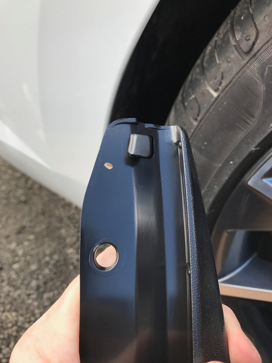

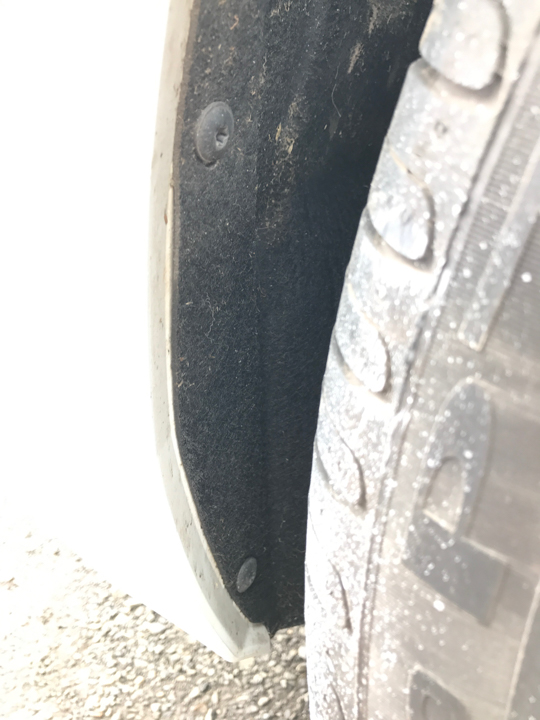

Good tutorial, I used it as a reference today to fit both front and rears on mine.
I had to help myself with the jack to gain space, just sufficient to lift the body, without removing the wheels.
Right-angle for drilling was necessary.
I also used a 6mm bit instead of the 7mm in the instructions, to have the plastic "plug" fit tighter.
I recommend to press well the flap to the body to make it as flush as possible.
And by seeing all the crud that came out while wrestling with the wheel arch liner, I suggest taking them out and give a good clean behind them ...
