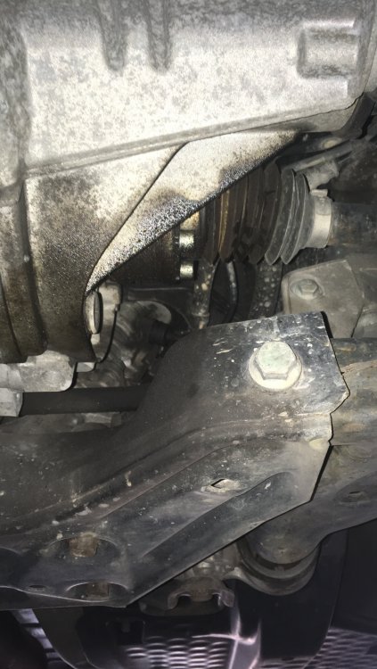

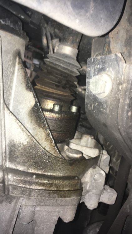

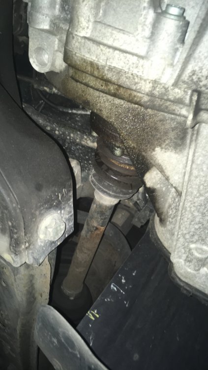

I'm having some trouble, I noticed my power steering seemed odd lately and the fluid was lower, went under the car and noticed the leak now... to me it seems the leak is coming from the drivers side near the diff/gearbox if I'm not mistaken LHD model, did a seal go or what do you guys think? Sorry if this has been asked before :/
That looks more like gearbox oil leaking from the diff seals. If the rack seals are leaking it will be going into the rack bellows and possibly coming out of them

Oh damn is there a seal between the diff and gearbox that might have gone?
Sorry I'm dumb so it might just be the seal on the left of the diff?
There are oil seals where the inner CV joints go into the gearbox. A little coating of oil around there isn't unusual though.

I wouldn't worry too much about the diff seals unless it's actually dripping. Just check gearbox oil level.

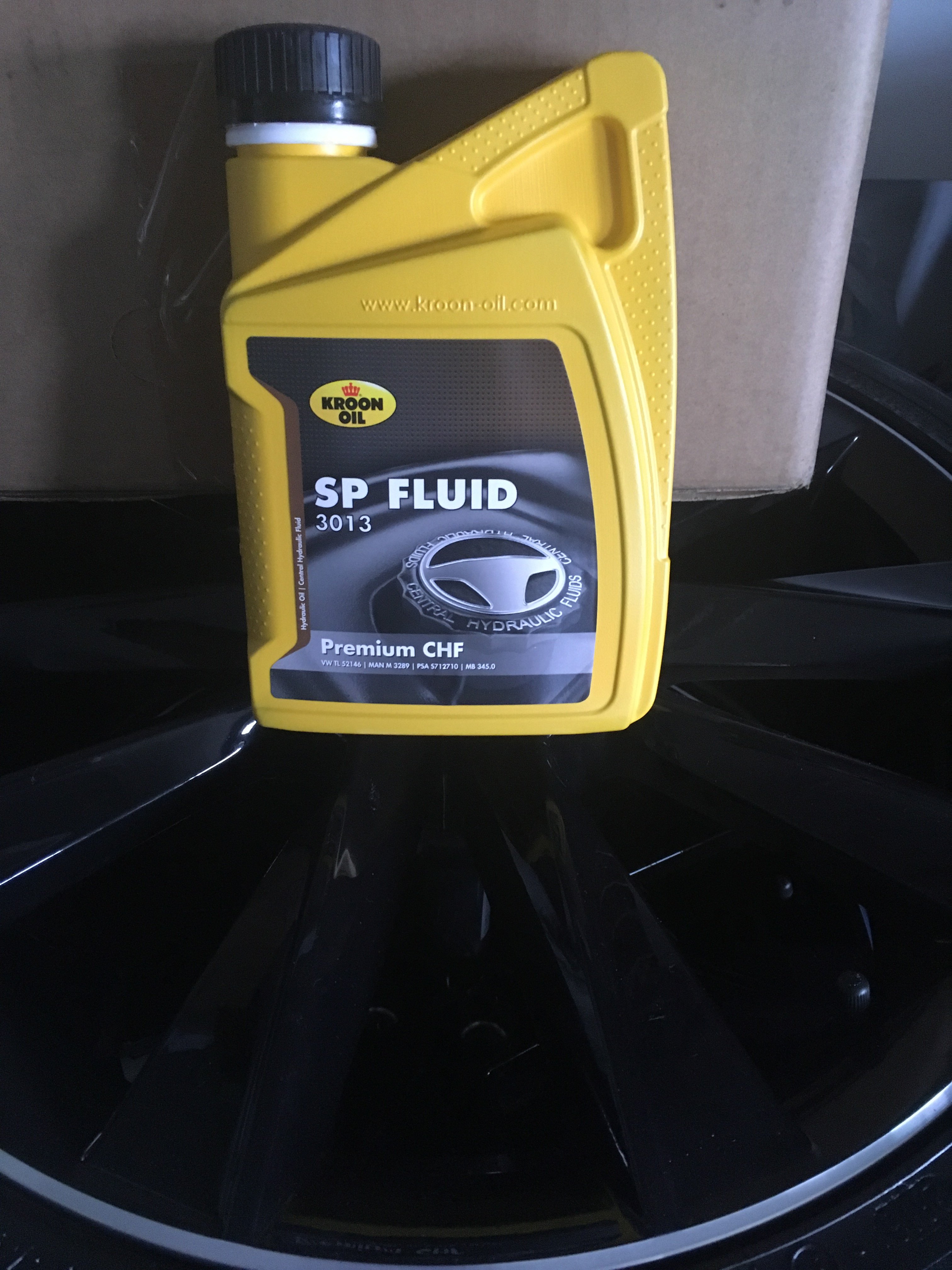

I got this bottle last week 25 euros lol VW TL774 compliant.
Maybe okay, but from what I can find out about VW TL774, is, it is an engine coolant additive coloured purple and sold typically as G13 etc etc, so maybe check which VW spec that power steering fluid is?
Edit;- being bored I've checked further, and what that is, is compliant to VW TL 52146, which is indeed a green power steering fluid sold by VW Group as G00 400 00 M2 which is good!
