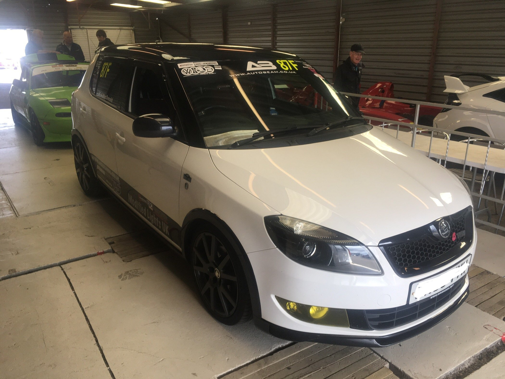

Tech all passed
The little diesel Skoda that could :)

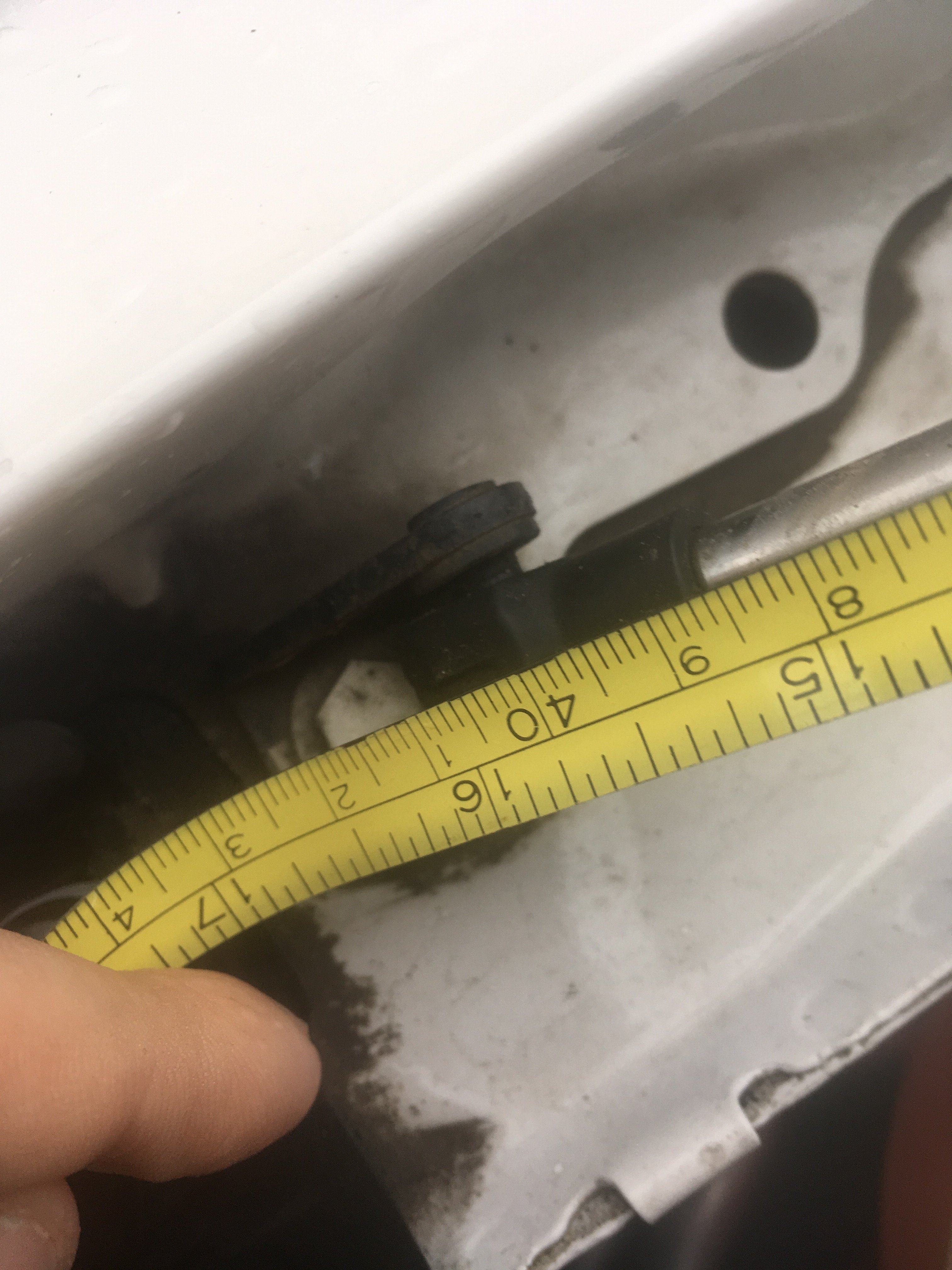

Sorry to be a pain, but could you please measure the length of the strut when the bonnet is open?  When you get a chance  👍
Much appreciated,
Much appreciated,
Thank you.
