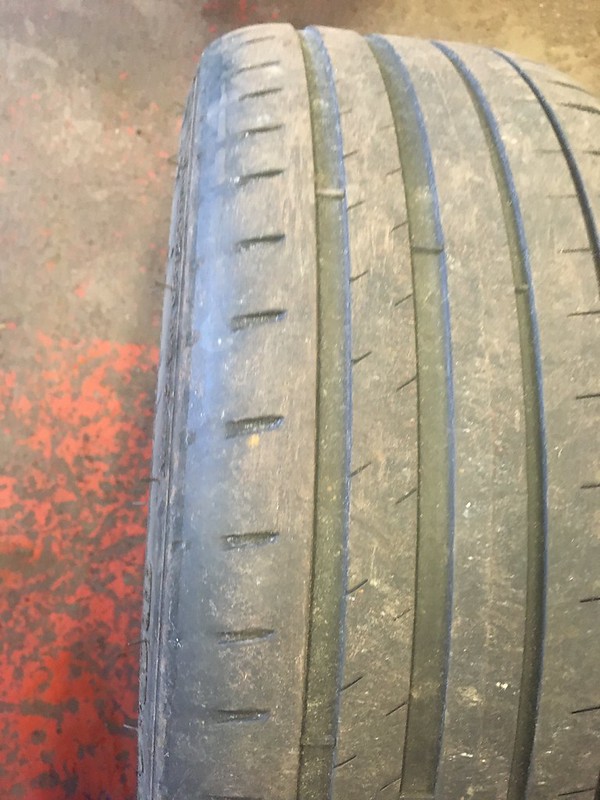

New pair of Pilot Sport 4 tyres for the front. These only last 11.5k insides were gone then going from the inside to the outside there was a spread of 3mm,3.5mm to 4mm on the outside. Thankfully i get them for £77 a tyre 🥴

Curse of lowered Fabias!
Is it common? it never did this on the contis?
My last pair of tyres did the same thing. Just ate through the inner edge. I’ve raised the front now though which has helped
