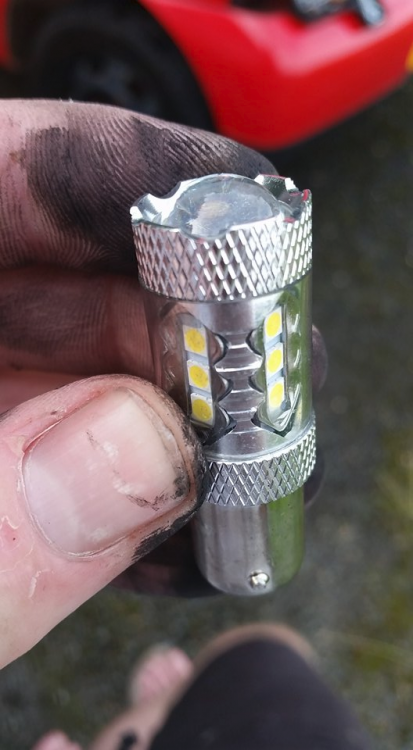

For reversing lights I used these (in a Superb and Yeti, but they also fit a Fabia):
http://www.ebay.co.uk/itm/2x80w-1156-BA15S-382-BRIGHTEST-OSRAM-CREE-LED-WHITE-CANBUS-REVERSE-BRAKE-DRL-/162630366357?hash=item25dd867495:g:Ww4AAOSwDk5T94q8
$_57.JPG&key=066723c7acdda8e472d15f30dc4
VERY bright!
Nice!  I'm now considering popping some in the old Octavia, depending on fitment.  Will research later.
Those are the same that i run. They are insanely bright!! Dont look at them while they aren't in the light unit, they blind you.
