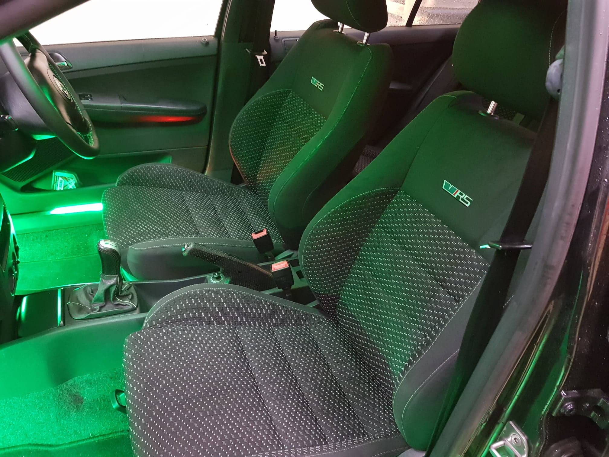

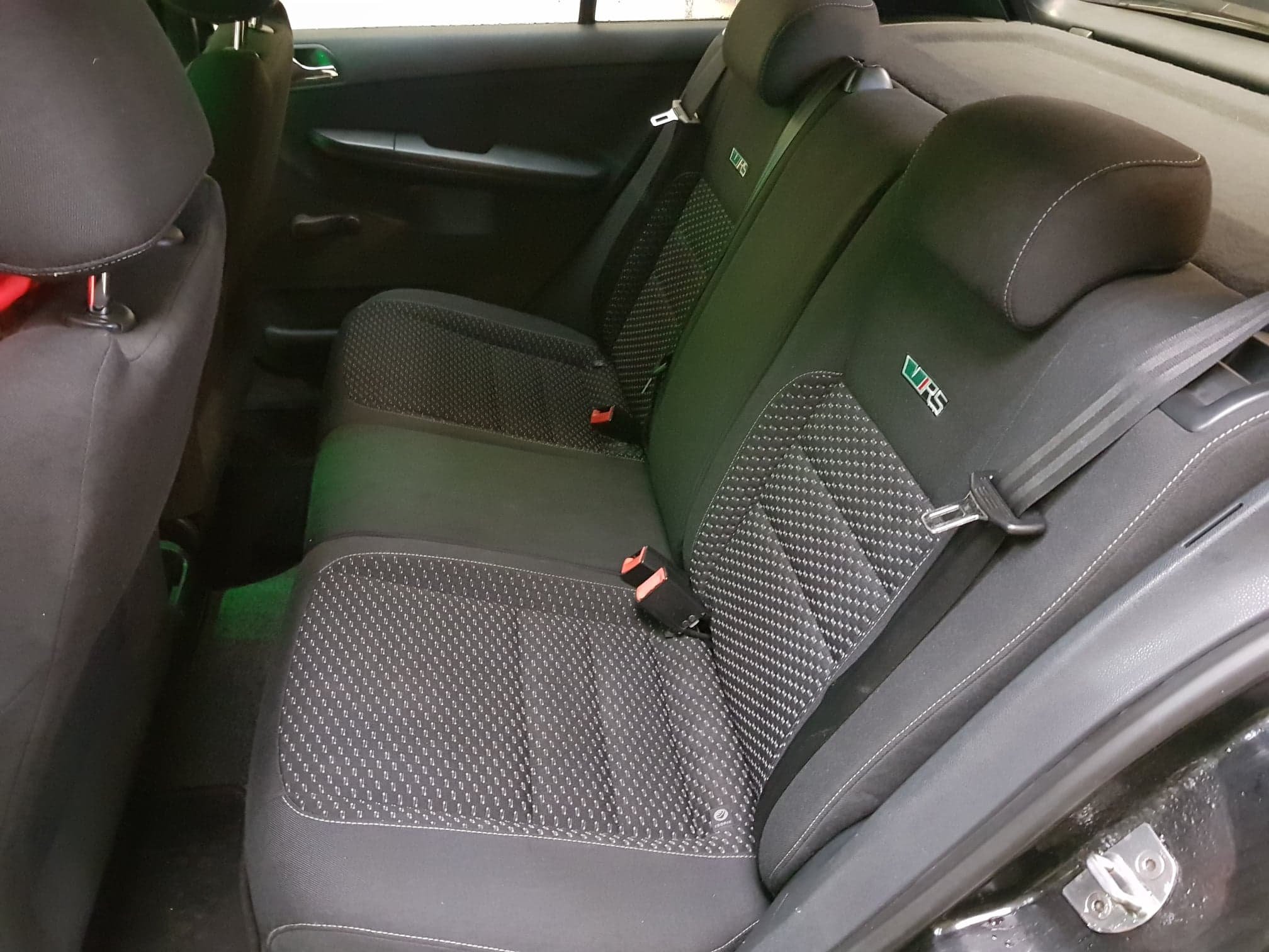

Now have a lovely new interior fitted from a MK2 vRS, what a difference it has made, its changed the whole feel of the cabin, the old ones are actually scrap they were in such a poor condition, fitted a new carpet off a breaker as well while we were at it as the old one was badly worn through in the drivers footwell, also complete with some lovely green lighting in the interior roof lights and front footwells! :D

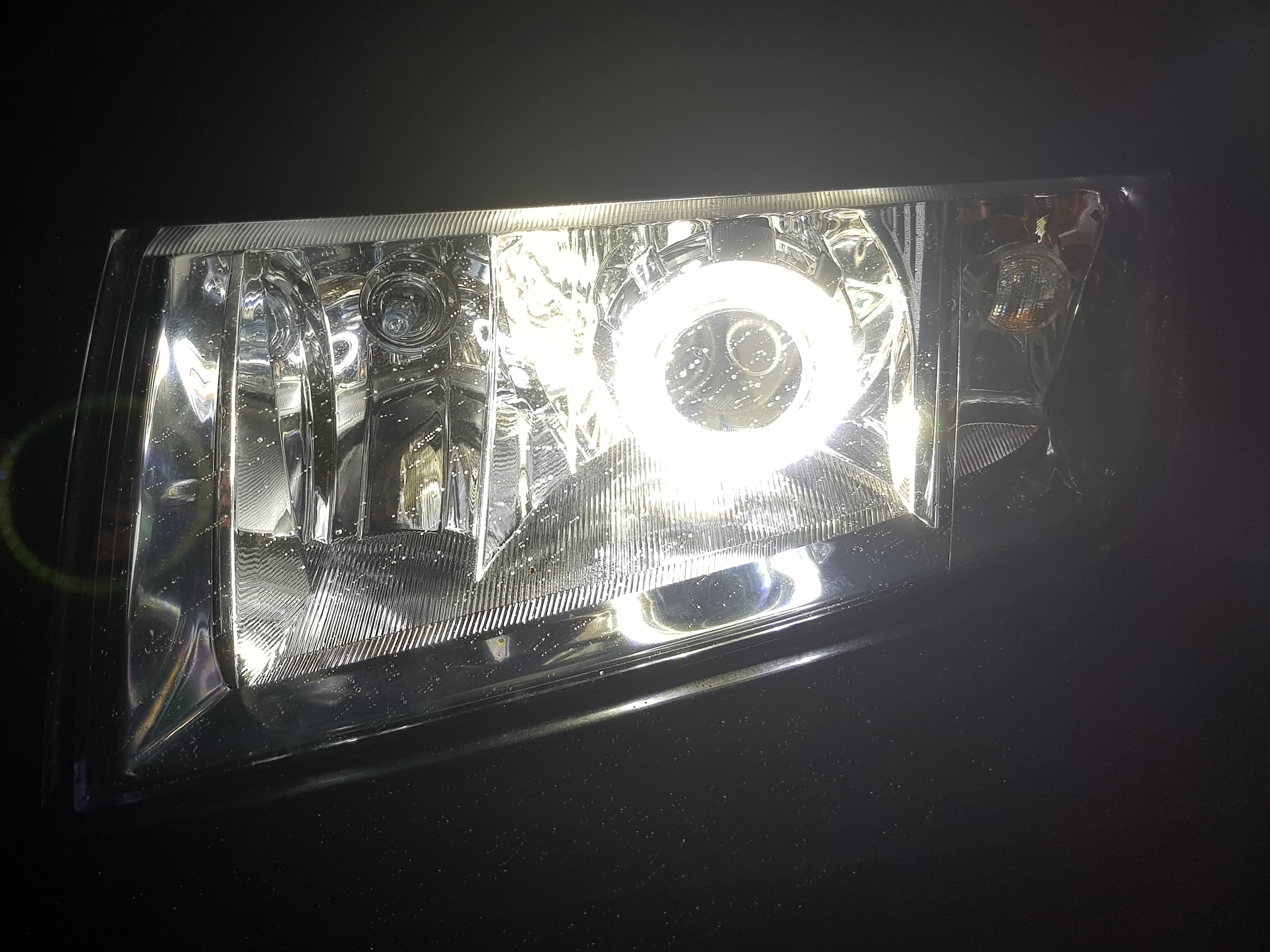

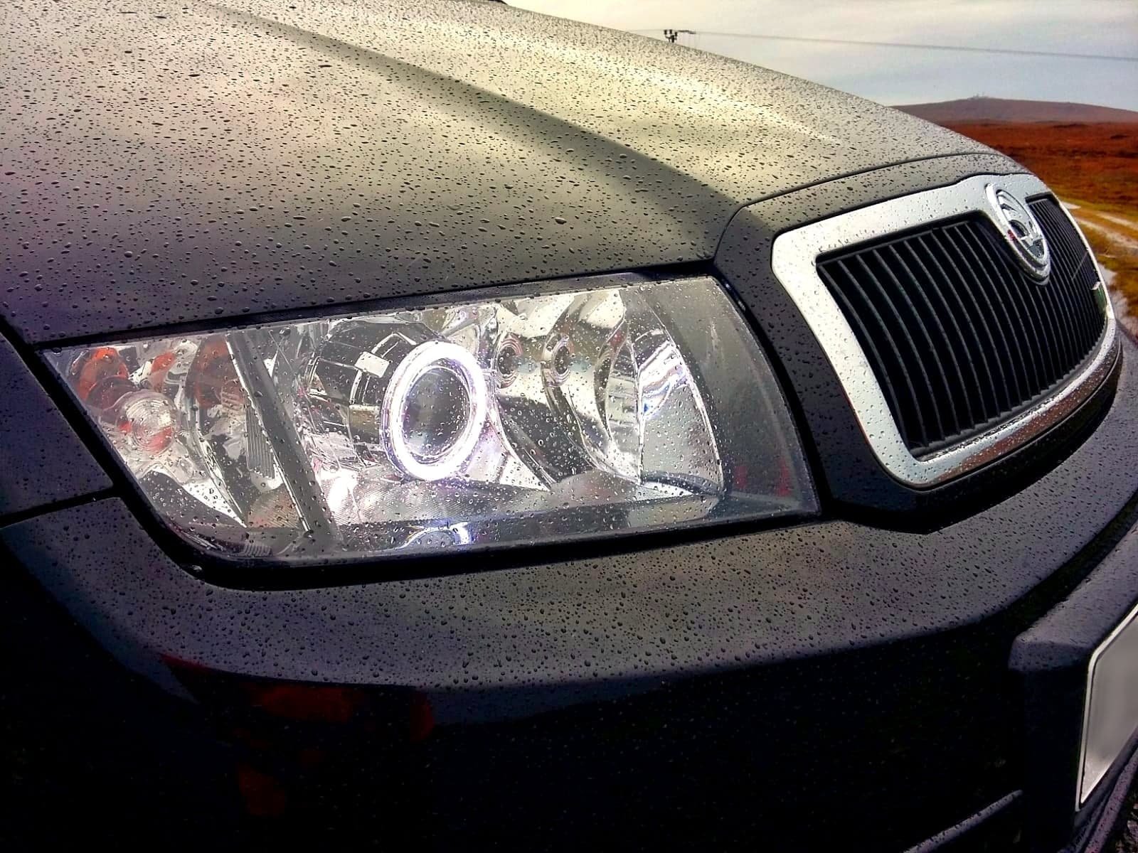

Also now have our custom made headlights fitted from Modified Lights UK, can't recommend them enough, they are absulutely fantastic and change the whole look of the car, it looks new, clean and fresh.. compared to the horribly misted up old original headlights, that had broken clips on them, and I absolutely love the look of the angel eyes in the dark.
