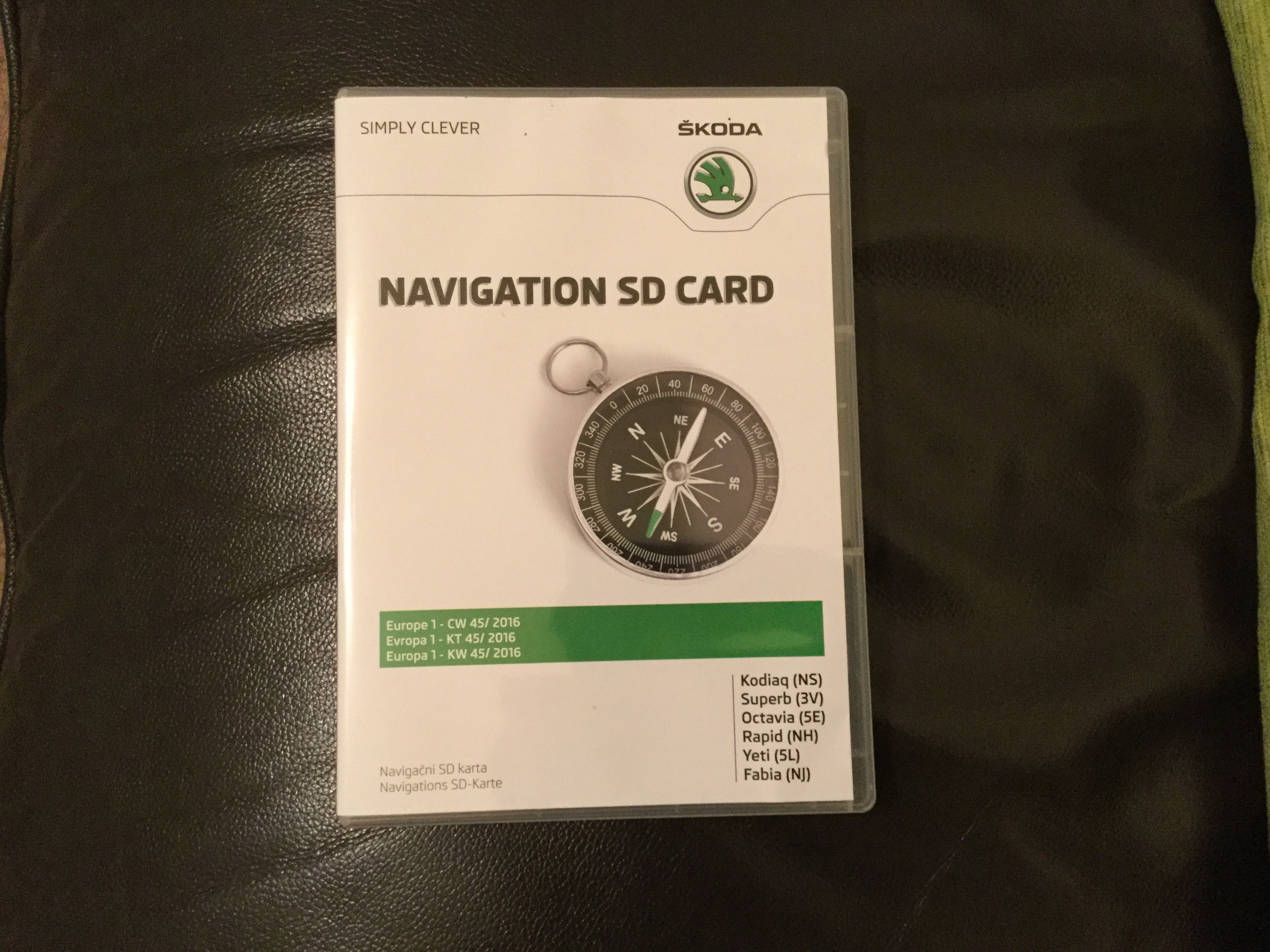

Here's mine...

7 hours ago, daveo138 said:
Here's mine...
Where do you get that? And why?
I do get an annoying sound skip with my 64 gb card. It sounds like a record jumping not sure if it's the card or codec.
It came with the car. AFAIK it's standard for the Amundsen.
I didn't get any :| Oh well. What size does it have anyway?
It is standard on the Amundsen infotainment system, the Columbus has a Hard Drive where the maps are stored, the Amundsen does not so the maps are on the SD Card.
Not sure what size the supplied card is but doesn't really matter because afaik once used for Nav it can't be used as media for music.
SOOOOO Lucky to get the navigation SD card.
