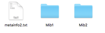

  • Downloaded update to my Apple Mac which created the following folder
which contains:
and in each of these many more subfolders and maps.
  • Loaded the 'High12' folder unto a formatted and clean Lexar 32Gb SDHC 1 10
  • Tried in car. Data not found'
  • Deleted files from SD card and loaded the three files only above. Tried again - 'data not found'

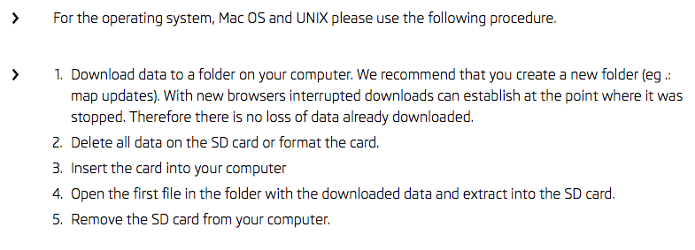

I've read about others (Windows users?) downloading zipped files. The above files were not zipped.
re-read the instructions and don't see what I'm not doing based on what they say on autoupdate.

  • Open the root folder and copy across the root file and the two MIBN files (I'm referring to the 2017/18 maps - it may have been different for others) you should now have 3 files on your SD card, plus any pesky hidden Mac files

Skoda - please update your instructions.
