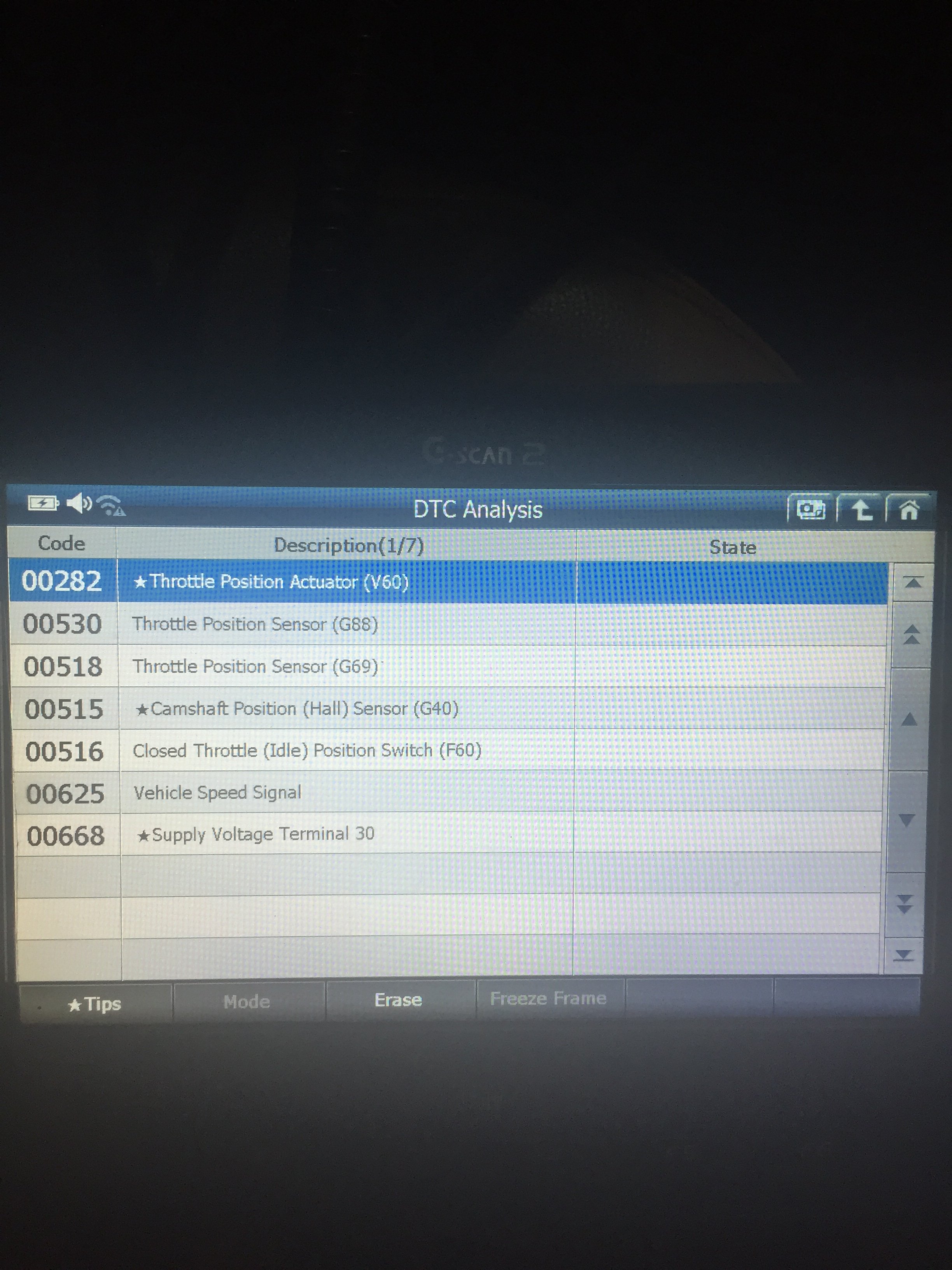

I need help pls my car is skoda Octavia 1 2006
i have strange problem my car do not start if I let it the all night when I try to turn it on the rpm oscillates between .5 and .6 and then still in .8 but when put in pedal in D mode it stops while in N mode shows it moves on
then when I disconnect the battery and connect them again the car works fine
and when I stop it for short time it run with no problems
i went to different work shop and it showed those errors In attached pic
i changed the throttle MAF camshaft sensor and temperature sensor and all the problems come again
change motor wiring and the same happened
try another ECU and nothing changed
pls pls could anyone tell me the solution
@Amm3 - "Step for a hint" - Which engine does it have, and am I reading between the lines correctly that it's an automatic?
