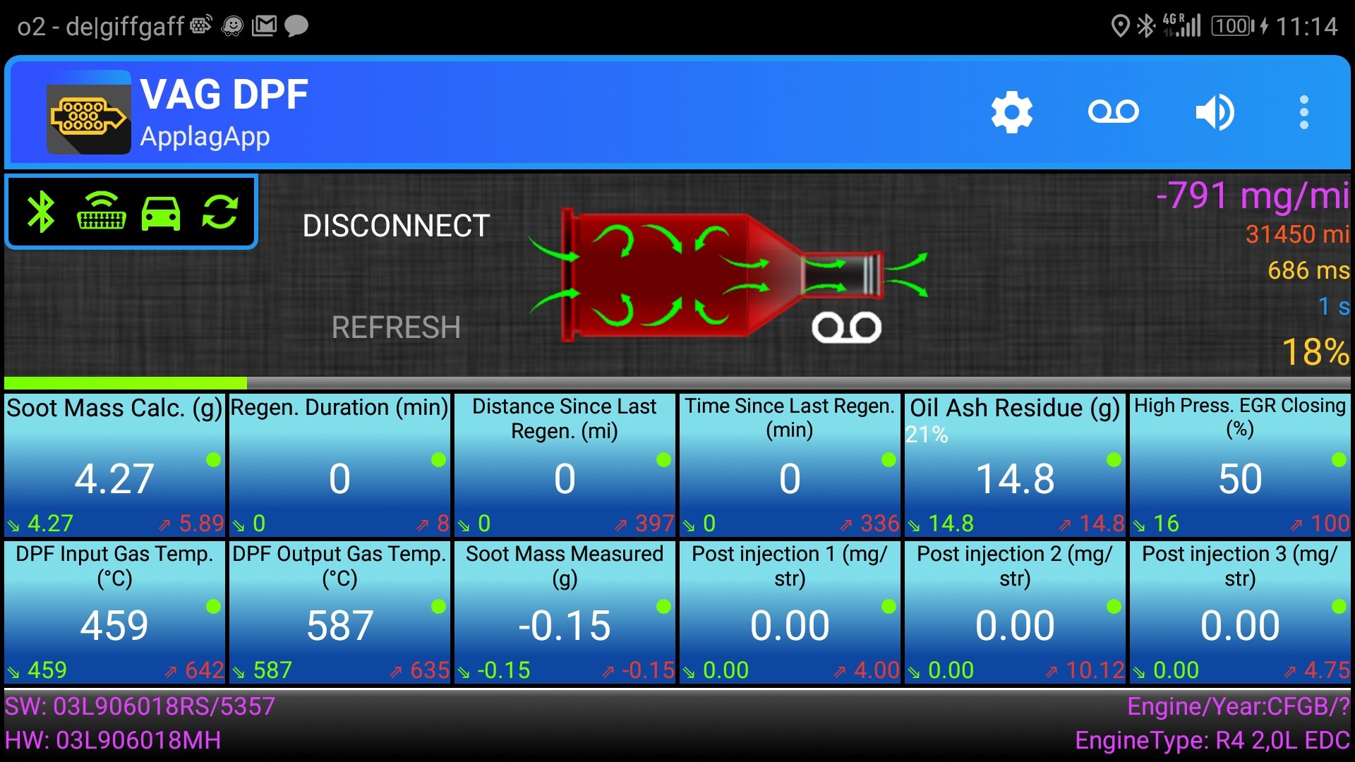

One of the key bits of info on the app are the output of soot in g/km. This is what is driving the soot fill rate and therefore regen frequency. Steady state motorway at 80 ish mine is between 18-25. Stop start traffic and it shoots up as you'd expect.
My oil Ash is high at 16.9g for a car with 40k miles. I suspect that non long life oil and a tuning box have caused that.....
I thought the only 'correct' oil spec for DPF based cars was a low SAPS long life oil? If it's not low SAPS it's going to cause you DPF issues.
It's normally where you drive and driving style that'll have most effect on DPF life although I doubt a tuning box will improve it.
What makes you think ~17g in 40k miles is high? That certainly seems to match what other users have posted previously. I'm not sure what engine you have or what it's max oil ash is but that's probably a DPF lifespan of 160-180k miles which seems reasonable.
To put the 'probably' in to context, my car is on ~153k miles so it's done 100's of regens including a good number of interrupted ones. If there was an issue with dilution from normal regens or occasionally interrupting them, I'd expected to have some kind of issue by now. Even more so as the car has only ever been on long life servicing so the oil is swapped every 18k miles.
If you're really concerned about it, you could change the oil every 10k or even 5k to keep it fresh. You can even send oil samples off to get tested which will confirm if your engine does have a issue.
edit:
Just to add to the oil ash vs mileage point, another member just posted a screenshot showing 20g in 46k miles which is almost identical to 17g in 40k miles:
