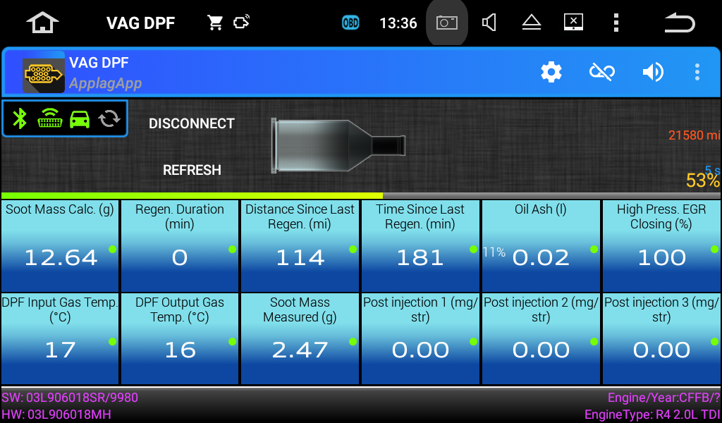

What software version does the VagDPF app say you're having? Can you post a screenshot?
yurgh, the 650km was when I first got it up so it probably had longer journeys before |I picked it up. Now it is about 300miles (480-500km)
I will try and take a screen shot . I have entered the VIN number on the Skoda website and it states that the car has already been been 'fixed'
Here is the screenshot
Also, any idea why after regeneration the measured soot mass is negative any it never matches the calculated soot mass?
As you can see on the screen shot, the car has done around 22k miles. When it does a regeneration , it shows about 22% clogged (at 100% it performs a regeneration).
My question is what happens at 100% i.e at approx. 100k miles. Will it regenerate permanently?
