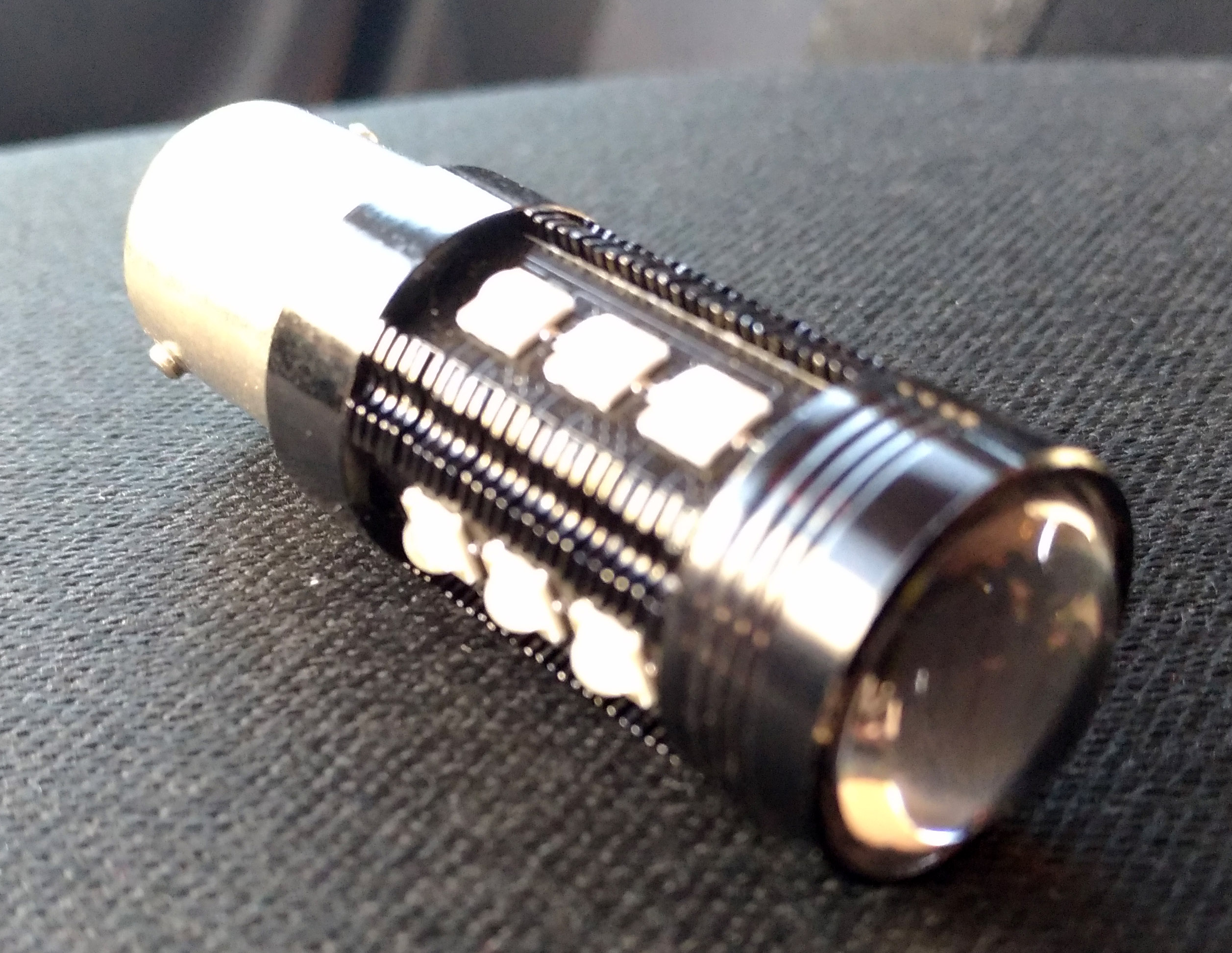

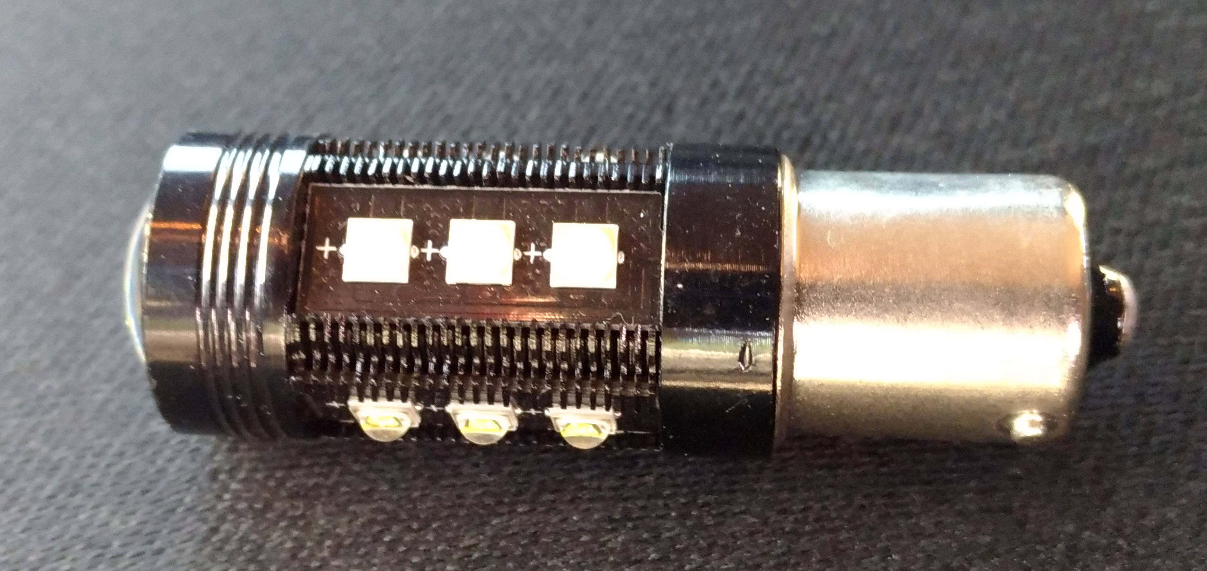

On 22/12/2017 at 14:32, WaveyDavey said:
I've had these on the car since April 2015 and they are still going strong. Still very bright too.
http://www.ebay.co.uk/itm/321517034780?_trksid=p2060353.m1438.l2649&ssPageName=STRK%3AMEBIDX%3AIT&clk_rvr_id=1398853096398&afsrc=1&rmvSB=trueimageproxy.php?img=&key=66c1d7df650950da
Cheers for the link, i put these into my 2011 elegance the other day, no dash warnings and much nicer look

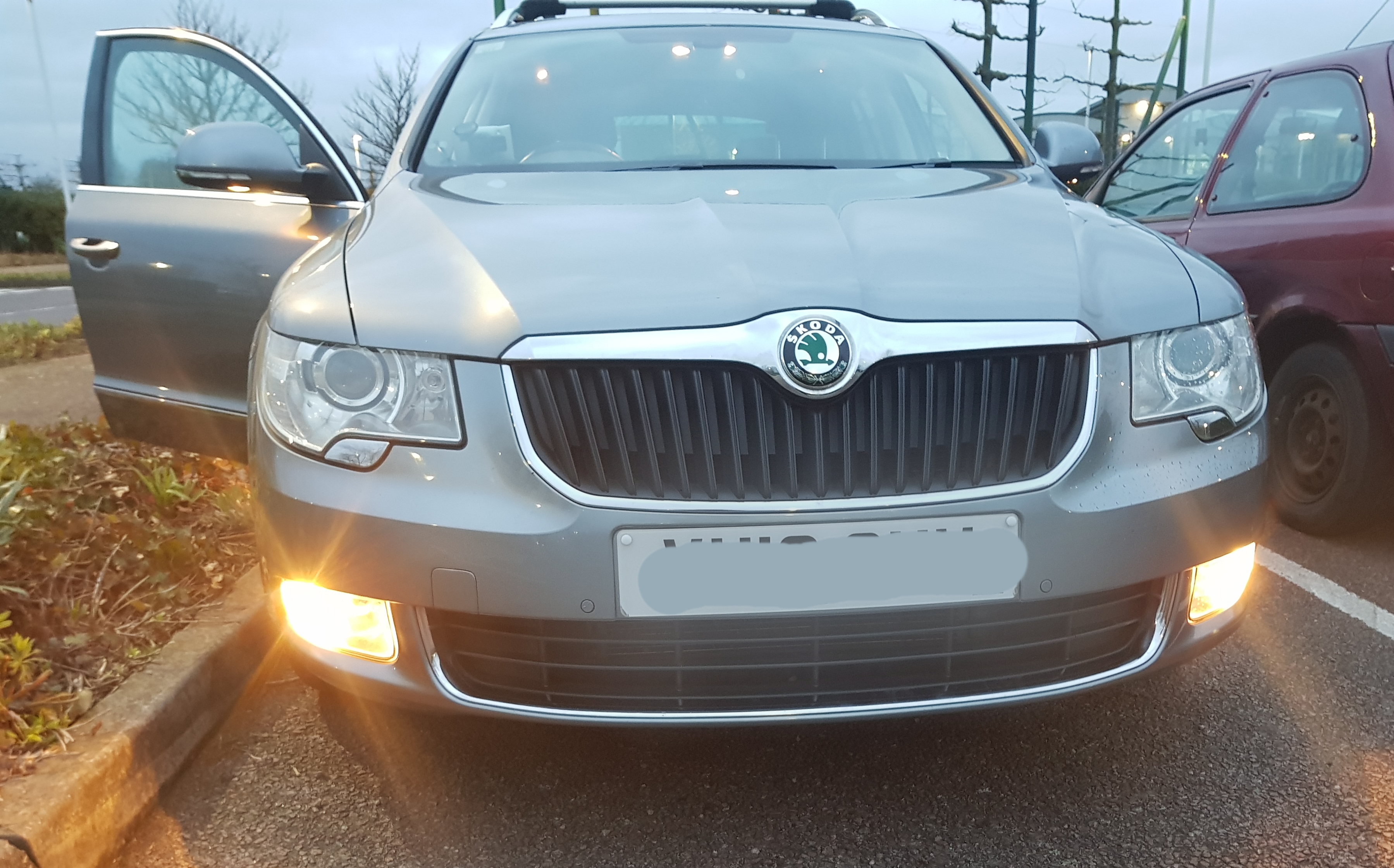

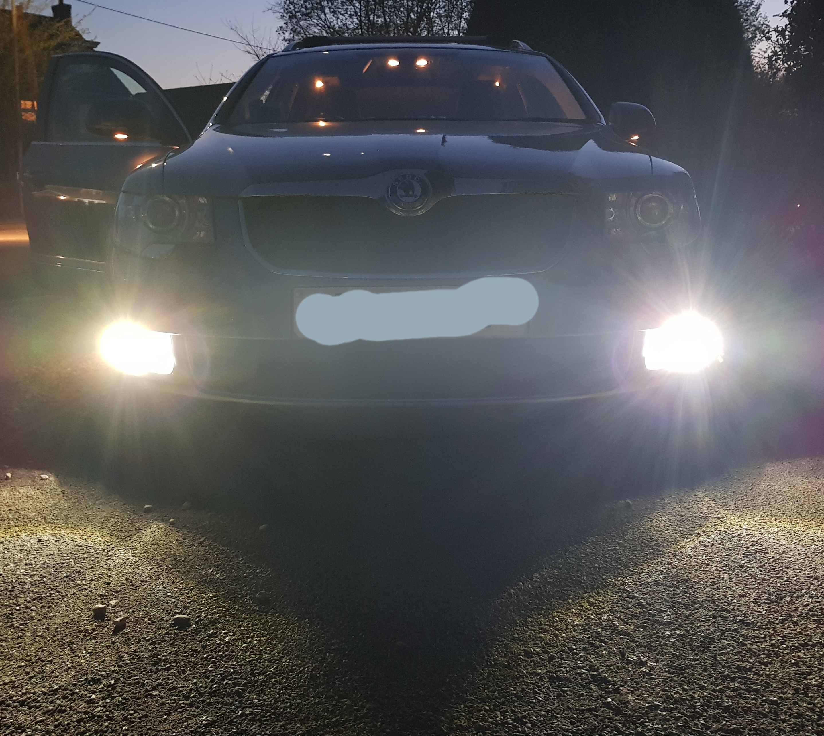

On 4/16/2018 at 21:20, Lucchese said:
Just ordered a pair....

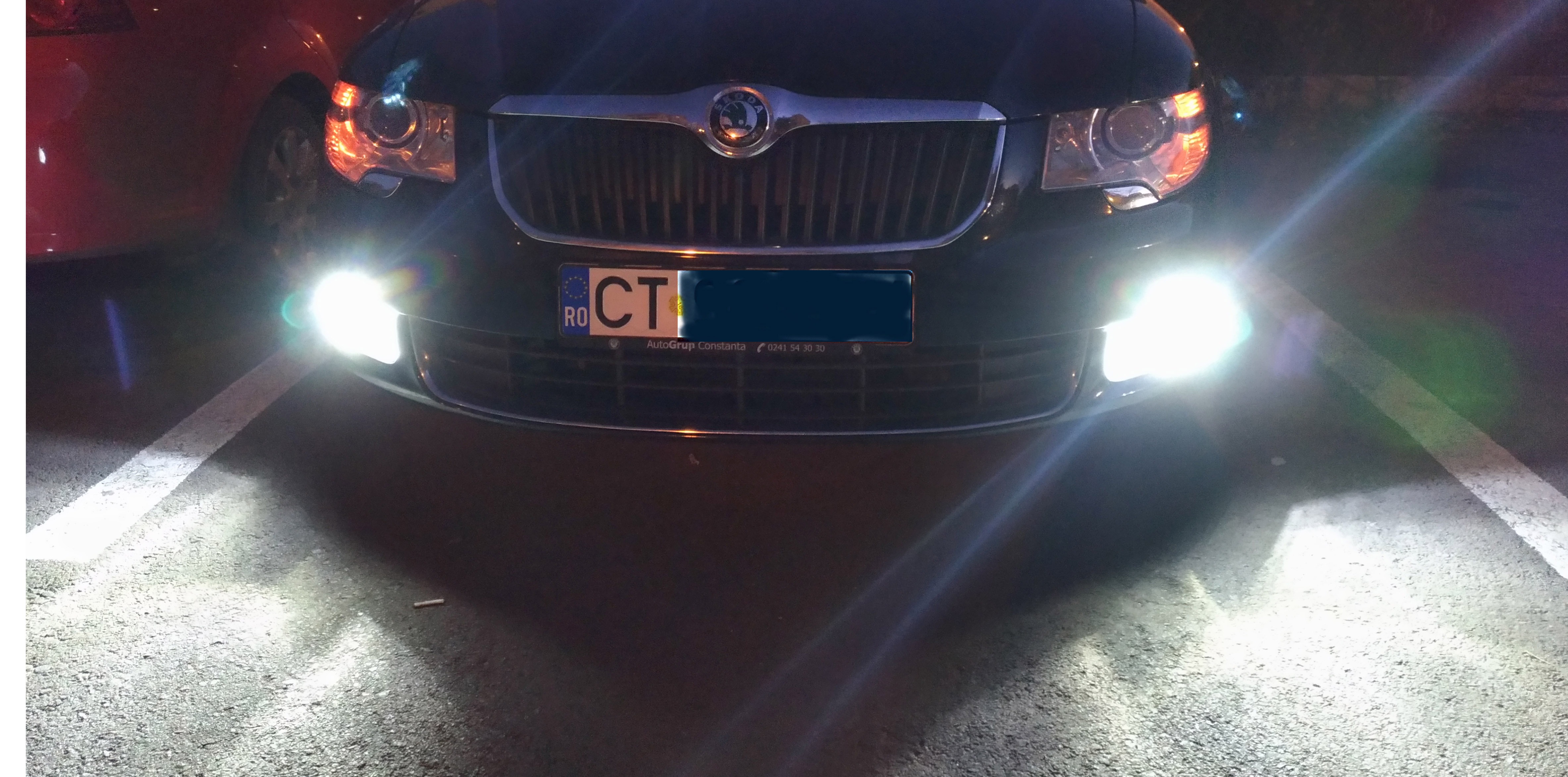

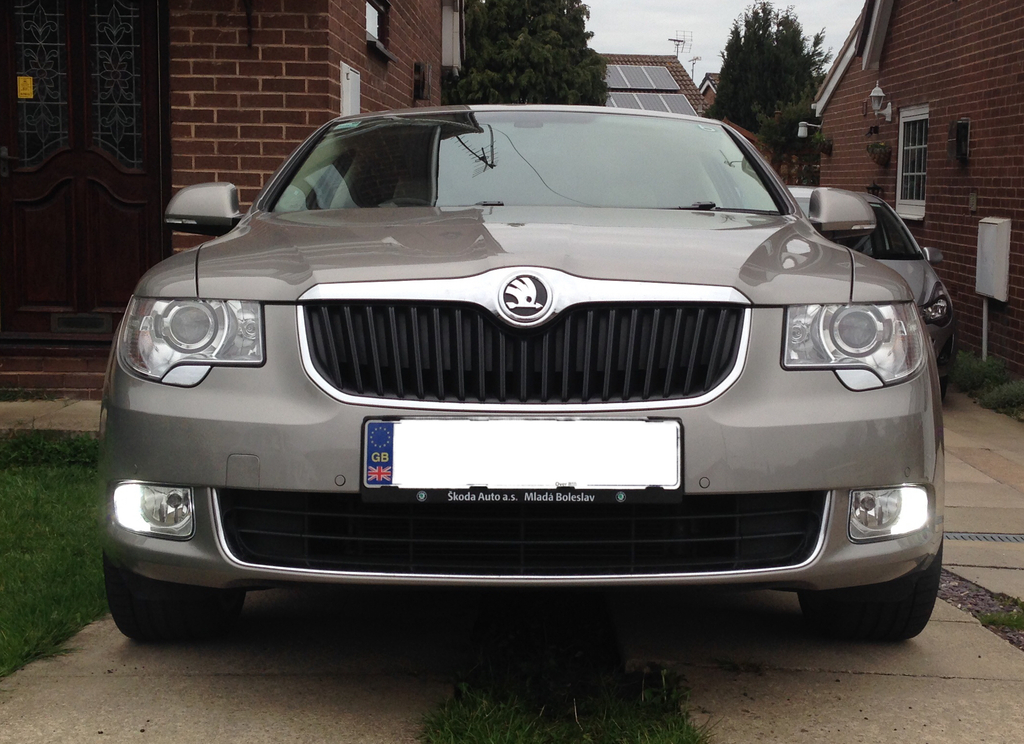

Arrived today here is a before.....
And after
Just now, Lucchese said:
And after
They look better in the flesh. No lights on the dash all is looking well. I used the link from WaveyDavey, thank you.

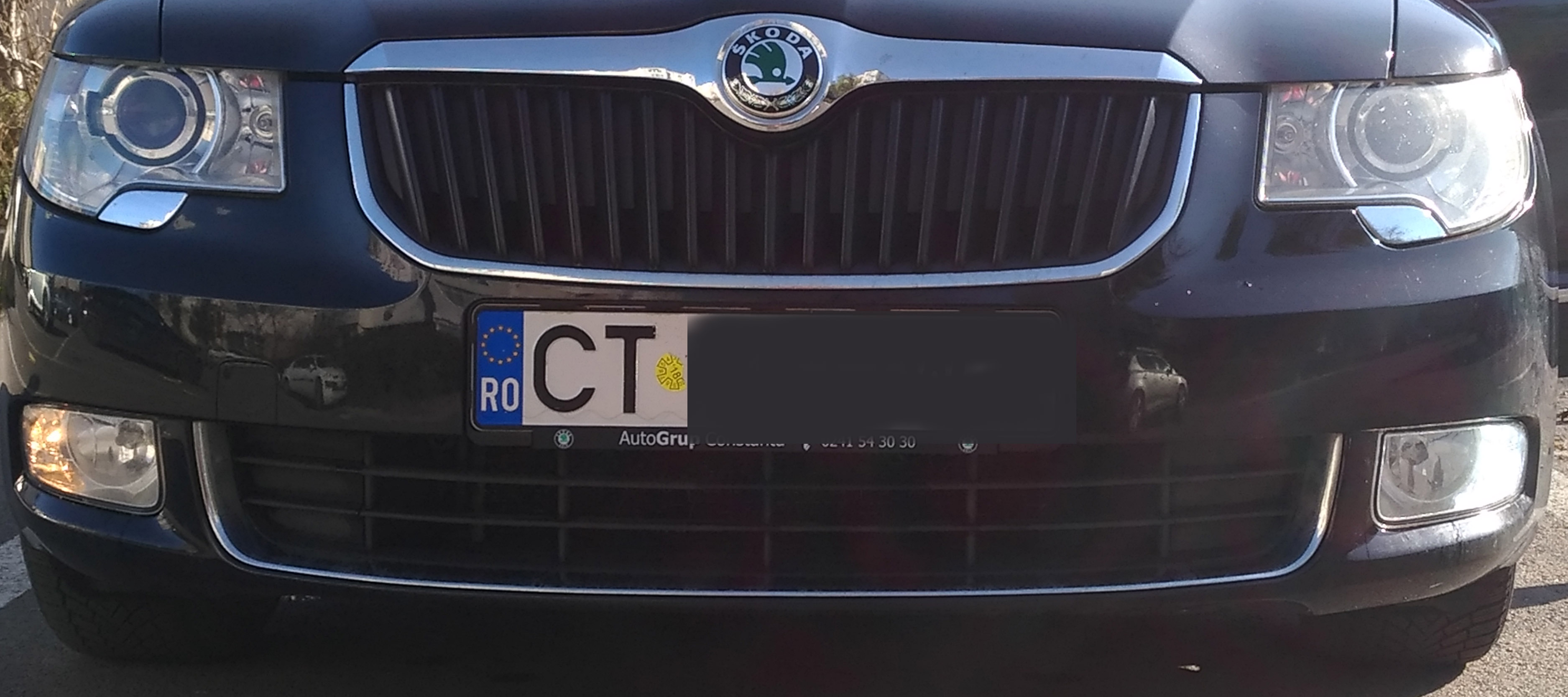

My car has only the fog lamps below, in case I decide on the retrofit (either the version you're talking about here or the version with the DRL LED strip built-in), I'm guessing I would need a new wiring loom for the DRL part of the light, right?
I don’t know I’m afraid but I’m sure some one more technically minded may know.
