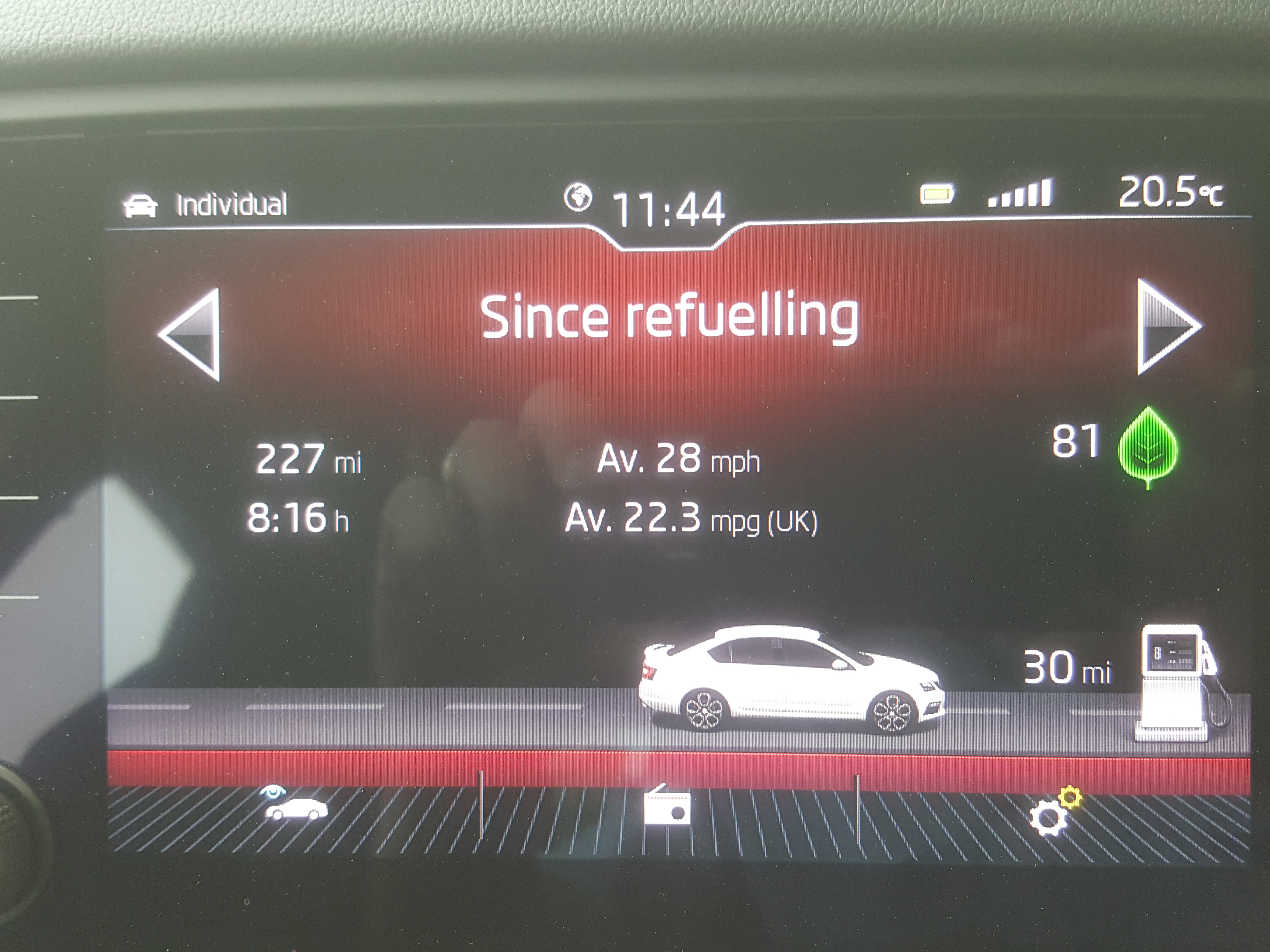

Did you notice that TMWNA's average speed was 28mph for his 22mpg?
Probably doesn't get out of first gear, just loves the sound :)

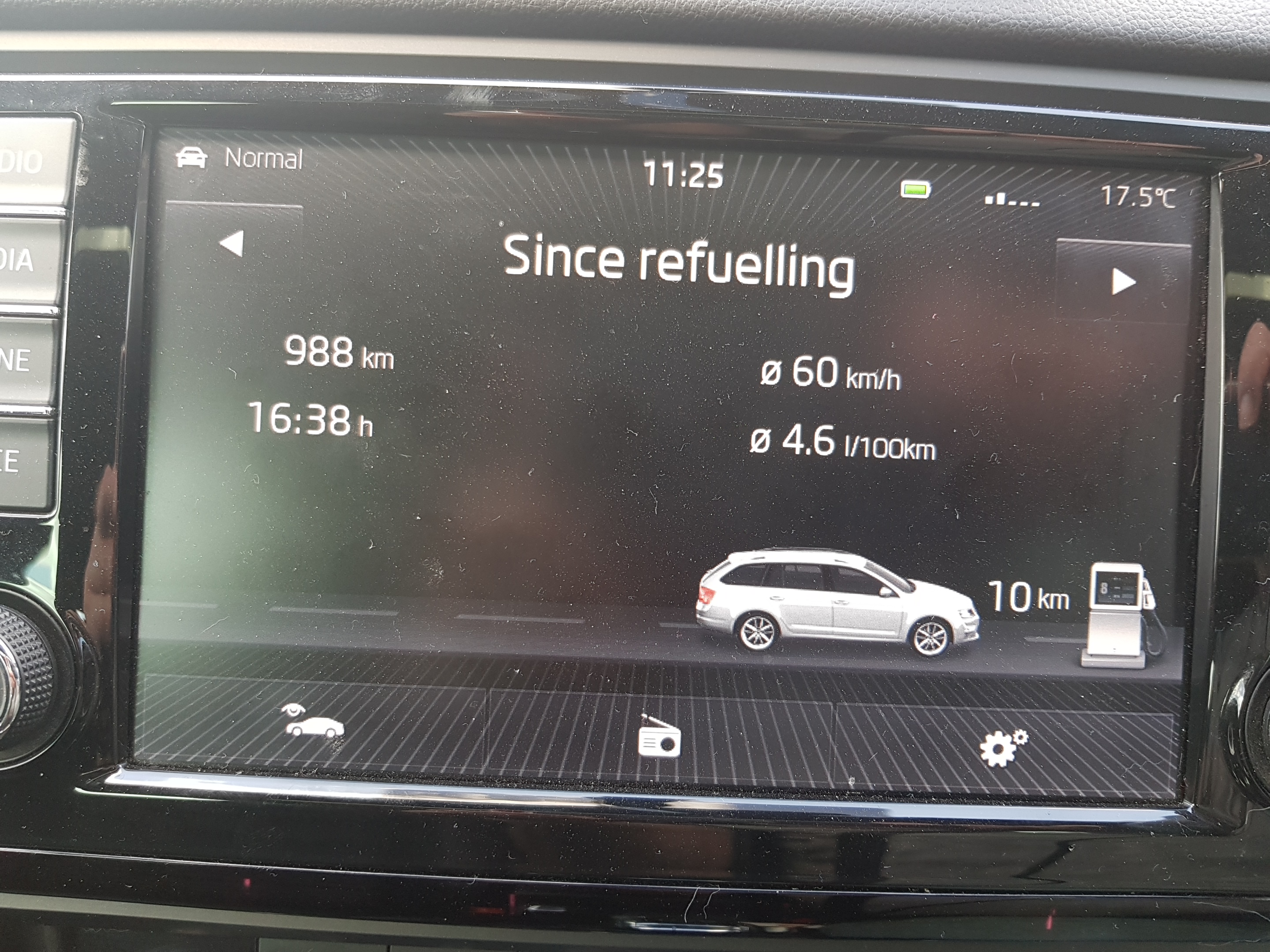

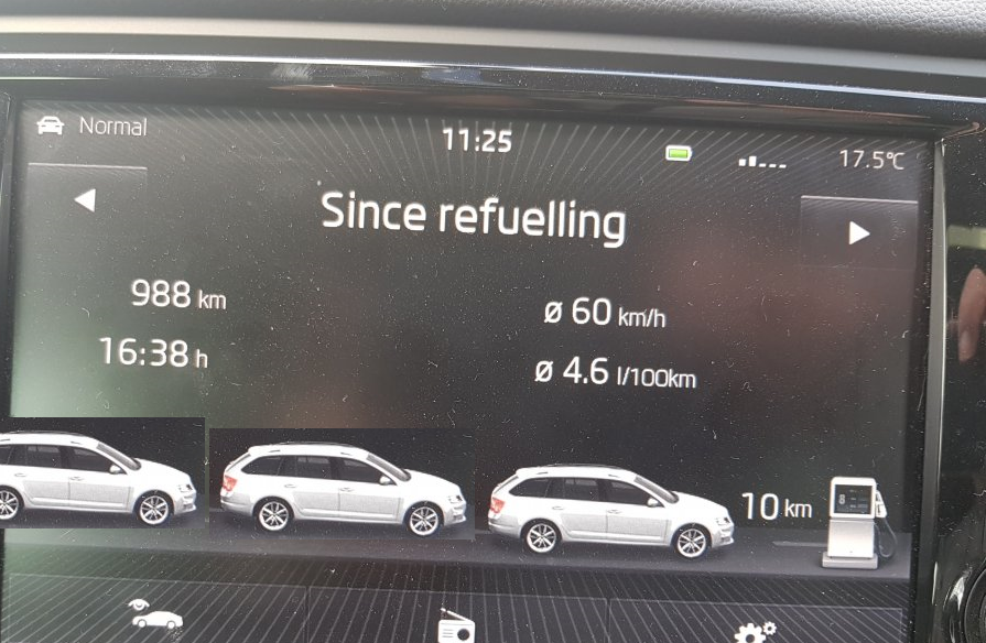

this was a recent tank full with my normal commute to work with some trailer towing / short runs to the shops etc. (note average speed of only 60km/hr)  brim to brim consumption was 52.4l,
this is not a 4x4, just fwd RS.
I did, and wondered if the car had spent lot of time idling? Warming up
before, and cooling down after being given death...if not, you need to put some effort in @themanwithnoaim
:biggrin:

614 miles since it was filled up, so how many litres required to refill?
2 hours ago, themanwithnoaim said:
South east of england traffic I'm afraid & I don't do any motorway driving hence, the low average speeds.
I don't let the revs exceed 3k till I get to 80 on the oil temp but, *******s to letting it cool down !!!!
Nah, does it ever exceed 3k revs with an average speed like that? :tongueout:
I managed an indicated 40mpg in my 245 on the way home from work today without really trying (normal mode, cc, 60mph). The numbers just kept climbing and climbing! Would have been mid 40's if I hadn't hit traffic :tongueout:. And yes it does still get driven properly when I'm not commuting lol
988km or 614miles  took 52.4l, and if you do the maths there is a discrepancy between indicated consumption and actual consumption
