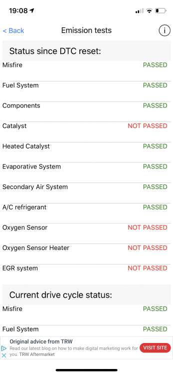

Hi - anyone able to help a novice here... looks like I have a similar problem on my 2015 1.4Tsi Octavia.
I get the same error code and noticed it’s telling me the oxygen sensor heater is not passing (see image).
Does this indicate it’s a different problem?
im pretty broke after purchasing this and am nervous of rocking up to a local garage with all my ignorance and being told I need to spend a lot of money.
