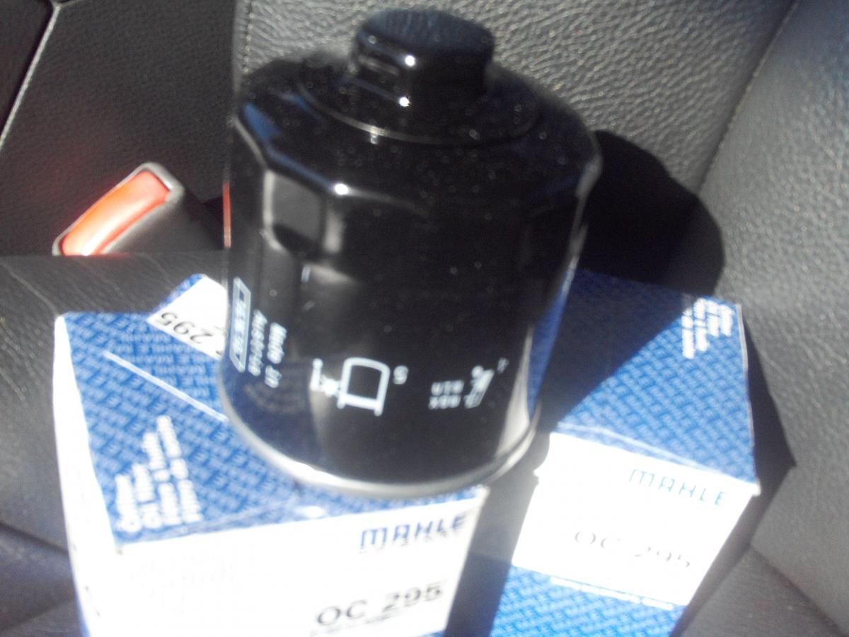

I believed those Silver non drip Oil Filters that VW had to replace the Black ones originally fitted are crap and i never used them,
i put on a cheaper filter, not because of the saving on money, but because it was an efficient filter.

For me the topic of black or silver/grey filters is a bit worrying, I did not make the effort to check what filter was fitted to my wife's August 2015 Polo 1.2TSI 110PS at the engine plant, but it now has a grey/silver VW Group filter.  What I have found out is, the engine plant seemed to still be using Mahle (black) filters while the dealer workshops via VW Group parts supply line, will only ever receive Mann (silver/grey) filters - that might just mean a change of supplier for many reasons like cost, or cost at maybe even cost.
I'm keeping my fingers crossed that the Mann filters now being supplied as a VW Group genuine part are every bit as good in doing their job as the original Mahle filters were!
Edited by rum4mo
No idea if there is Gel Technology or any such with the Silver Ones, all i know is for fitting on the top of engines you can remove them and they trap the oil and save messy people spilling oil.
Personally i think for the likes of a Twincharger that needs the oil up into the filter quick there might have been Silver ones over tightened.
Anyway, Mahle filter less than £4 at the motor factors, does the job so job done.
Suck or drain oil before filter removal and a cloth / rag/ paper towel to catch any oil sorted.
My interest is for the filter fitted to the 2015 1.2TSI 110PS engine and after checking both Mahle and Mann sites they are the same in as much as both have "anti drain back" valves so maybe not too sinister a reason for VW Group to drop Mahle in favour of Mann, well until proven by others, maybe just retaining Mahle for engine plant supply and only Mann for genuine VW Group dealer sourced parts.
