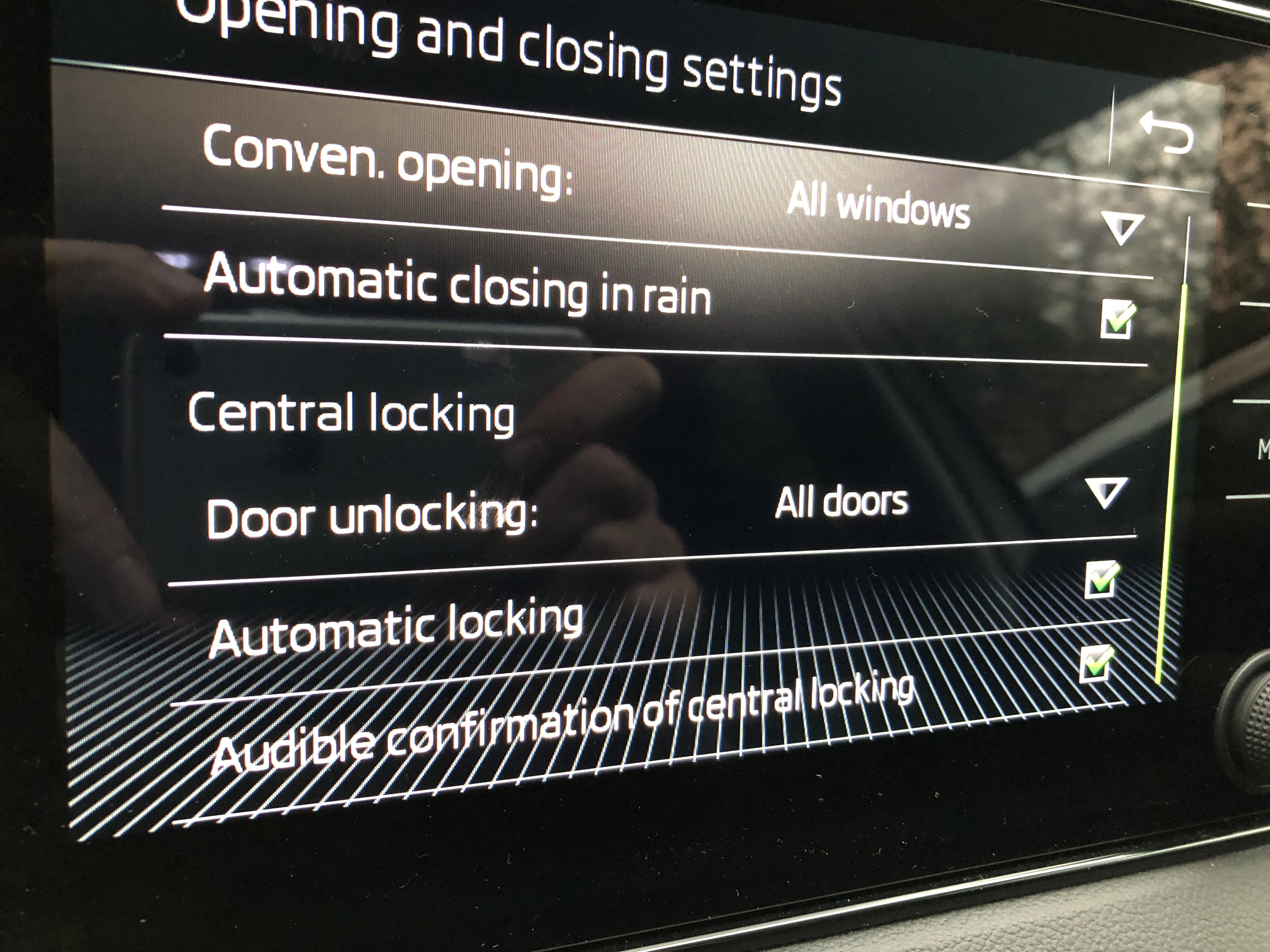

On the Yeti (2013) the beep turned on and off on the Beep using the multifunction display. Karoq does not do but haven't seen need to try and turn on. Turned Yeti off as often left home very early in morning and the beep was quite intrusive.
After tweaking, I can manage the beeps over infotainment system. But I dont know how it is done by software. I let them activated to a car electronic shop worker via VCDS.

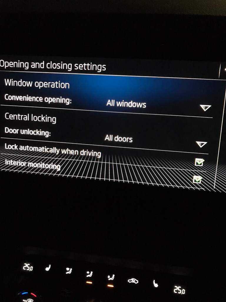

irfant - how can you activate the lock/unlock beeps on the Karoq's multifunction display? My UK model doesn't have this option I don't think.
At first, you need to activate this option by tweaking with VCDS / OBDII software. Then it appears on the MFD.

No, not here, not even the option to close windows in the rain, and it has been known to rain at bit in the UK...
Before tweaking by VCDS my screen was the same as above. Rain closing is also coded, car does not have sunroof, but it is working for door windows

Did you lose anything from standard when you did the coding, or is the Interior Monitoring further up the menu, as it looks like you have a side bar now?
Nothing get lost. My car does not have alarm, that's why interior monitoring is absent in the menu
