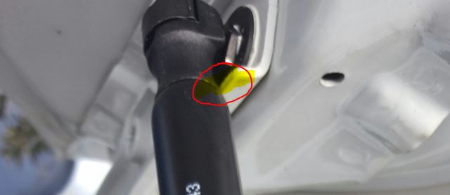

Installed, but with some modifications with my pocket knife. I forgot to take a shot, but the bilstein shape is a little bit different. I highlithed it at the pic below. This one (on the pic) is "concave", bilstein it is not, so I made it with my knife :)
All is functioning now :)
Hi Hitmn, it looks as if the 'stand-off' (or lack of ) was your problem with the top mounting ball-pin. The pins I got had a thicker hexagon section to them - but it took a lot of searching on the web to get them. The longer hex also gives a little more contact surface for tightening them. Other than that, are you happy with the struts?
yes. in my opinion 350N is perfect force!
