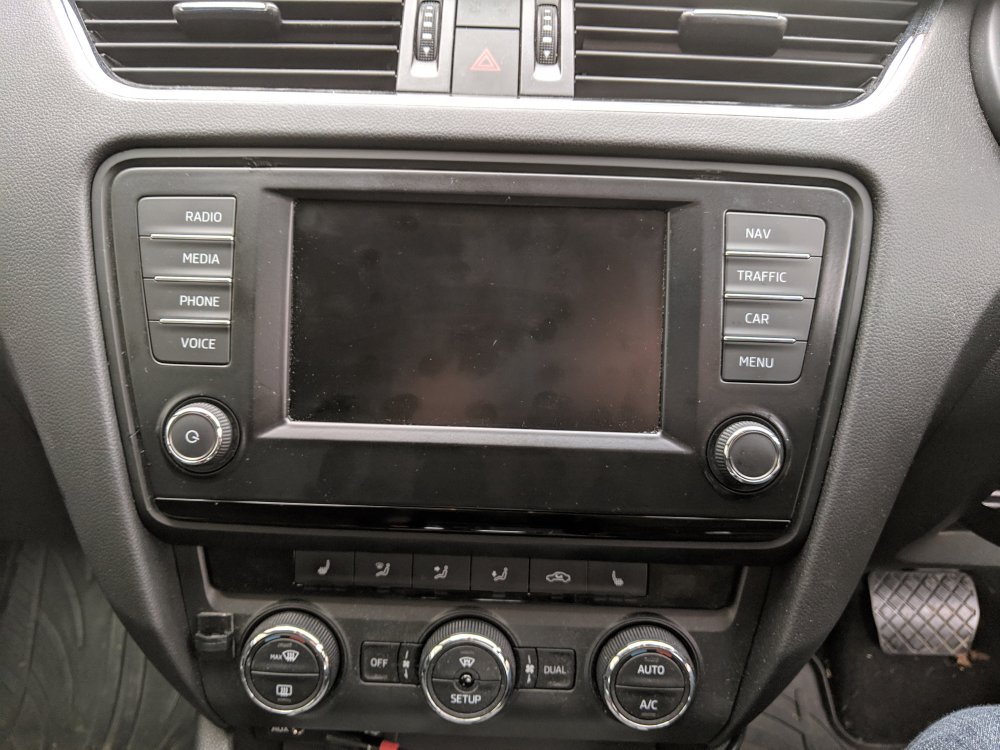

I have a mib1 Amundsen unit and hate it with a passion. Tried getting an android powered unit but that went back for various reasons.
Now, before I go getting another android unit that actually fits, what is the easiest/most cost effective way to get android auto in a mk 3? Happy to spend £3-400 on a head unit (I like the look of the new Sony one coming out soon) but spending £7-800 on a mib2 plus coding is far too much (unless someone knows a better source?).

It'll have nav when it comes back. Car is 2014 with factory MIB1 Bolero. The unit I have installed (which is the 6.5 inch screen and the glovebox unit) is a 2016 MIB2 Amundsen which will come back from Poland with all its features working. All you need to buy for a car that didn't have nav is a GPS antenna. If you are converting a MIB1 Amundsen you'll need a screen and a radio unit. If you are converting a Columbus, you'll just need the radio unit as the screen didn't change (allegedly). You can use a Columbus screen with a MIB2 Amundsen if you like, or as I will be doing, the new FL 8 inch Amundsen screen. Screens are interchangeable across the MIB2 platform; you can have a MIB2 Bolero with a Columbus screen if you like, but the NAV and TRAFFIC buttons won't work, or you can install and Amundsen and leave the original Bolero screen, just access the Nav from the main menu. The radio unit is the complex bit :D

Yes I’ve swapped my original MIB1 Bolero for a MIB2 Amundsen and my swap was very simple and I have not faced the many issues that others seem to have faced when performing this swap. I used a Technisat unit, bought for £150 and I wouldn’t spend anymore than that. It doesn’t matter what car it comes out of, you can change the splash screens and car images to suit. On top of that you will need a screen, either the original screen (5E0 919 605 J) which is a 6.5 inch screen or you can use a Columbus screen as I have (5E0 919 606) which is an 8 inch screen or you can also use the new facelift Amundsen screen (5E0 919 605 M) and you’ll need the green tipped USB plug (5Q0 035 726 E) as the original one won’t work with SmartLink. These are about £22 but it’s worth finding a radio from a breaker that has a whole car; I phoned the yard I bought my unit from as they had a picture of the whole car in the advert and asked if they had the USB and they did, so offered to chuck it in with the radio and screen for free. Also you’ll need a GPS antenna. I used a generic FAKRA connection one from eBay and routed it behind the dash but I know that @JohnnyType2 has used a whole OEM shark fin antenna for the GPS so I imagine he won’t get the GPS signal fault in the radio module that I do because my non OEM one isn’t seen by the radio as working correctly even though the GPS works fine. I have a shark fin on my car for the Phonebox option so I could get another shark fin from a car with GPS and do a ‘proper’ install but mine works just fine so I probably won’t.
Once you have all that you’ll need to fit it in the car which is the easiest bit really. You’ll need to trim down a few connector locators as they are slightly different but they are still perfectly secure. The connections are as follows.
Black = DAB
Purple = GSM (phone prep)
Blue = GPS (sat nav)
White = AM/FM radio
Yellow = USB
Grey = Data to the screen
There is another plug which is the fibre optic plug for the CANTON sound system.
The next step is to have the Component Protection removed. I had this done by my local Skoda dealer and they had no issue doing it for me at all. I waited a few mins and the car was done before I finished downing my third free hot chocolate and scoffing all the biscuits. Others are not so lucky with this, but it’s worth getting this done at Skoda as they code the unit to the car and it means no CP errors appear in any of the modules as well as all the features like TPMS etc work as they should.
The final piece of the puzzle is to enlist the help of someone to code it. The brains behind my radio swap and the man I’d always recommend is Pawel (Pab567) as the quality of his work is excellent and his knowledge of these stereos is far greater than Skoda themselves! He activated the Sport Menu on my unit and enabled video in motion etc etc. And his prices are extremely reasonable. If you can’t get lucky with the CP removal at Skoda, Pawel usually has some CP free units knocking around but he might need an auto scan of your car taken with VCDS to get the option boxes correctly ticked, or you’ll have to send him both radio units.
Once the magic has been worked and the unit coded you are ready to go! The total cost of my swap including buying two screens and selling one and selling my old Bolero was £440. Not bad for the features that are enabled and the extra 2.2 inches of screen
Hope that is of some use to you. Please let me know if there’s anything else I can help with.
