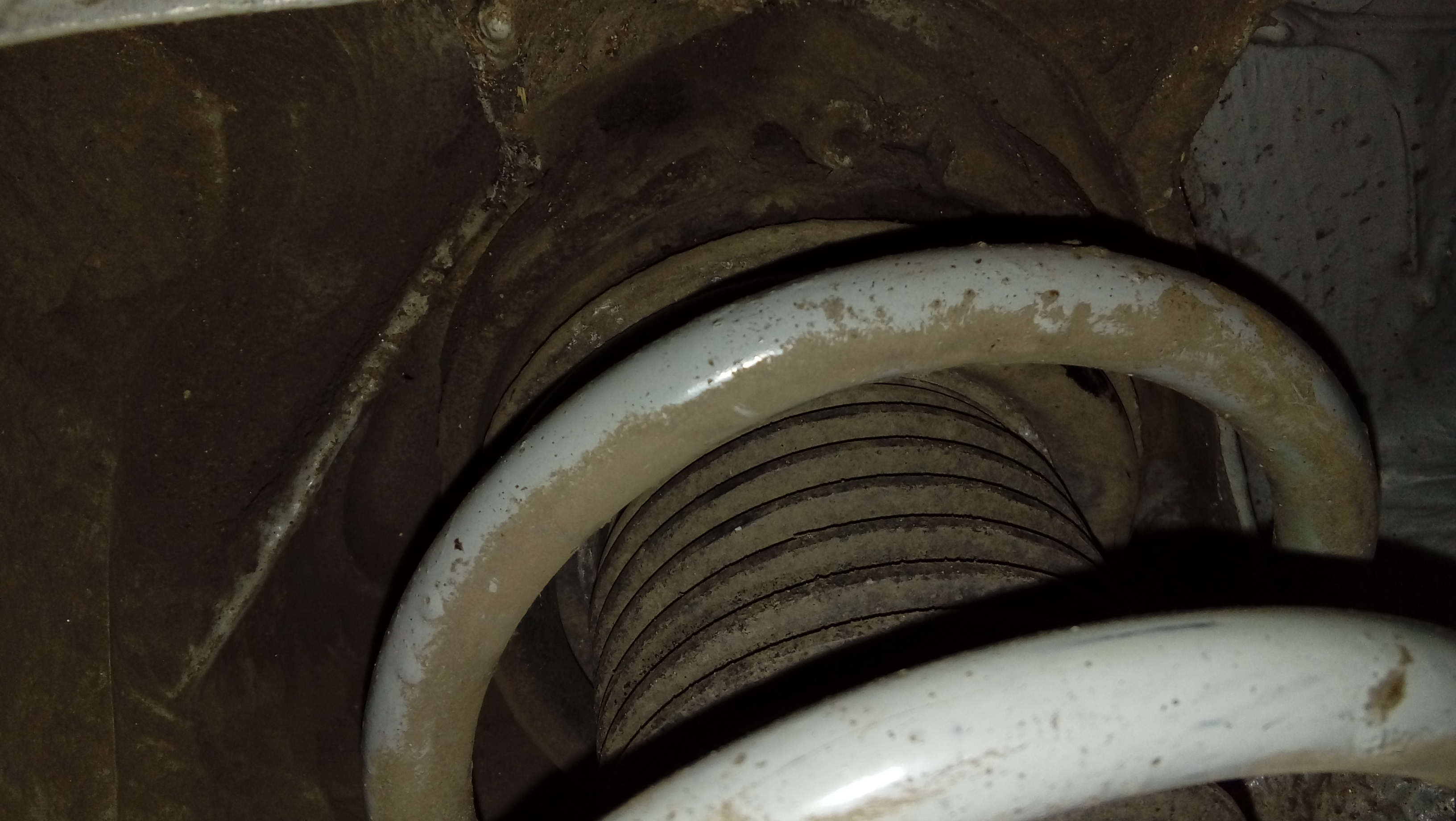

Were there any noises or other symptoms and did this occur on cornering or braking? The photo shows a fair bit if crud up there and I only power washed a few days ago.

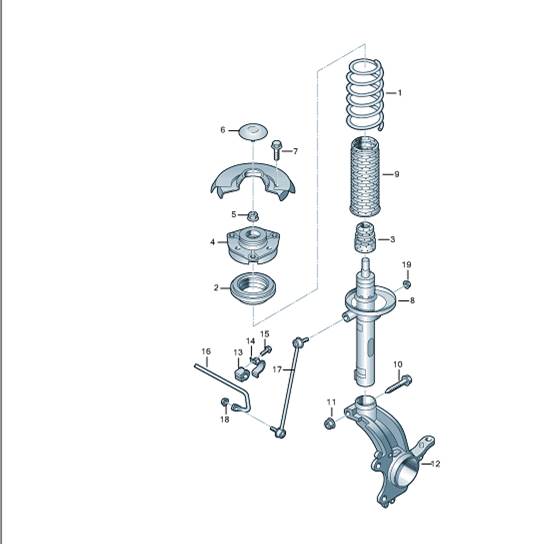

See image of parts please.
Part 2 looks like rubber end.
Part 4 looks like top mount bearing.
Having had a 2nd opinion from someone who breaks cars for living , he thinks it might be the bearings disintegrating in top mount. He and I could not find any break in spring. Painted Grey few years ago but the last spiral was unpainted but I can feel end which is facing opposite direction to lower part of spring end of coil.

You've got the parts mixed up. Part 4 is the rubber top mount and part 2 is the bearing. The parts look like this...
The bearings look like this inside...
Edited by TMB

I spent this morning having another look around and cleaning up the springs. There is definitely no breaks. I checked both front springs and could feel the top end of the spring.
