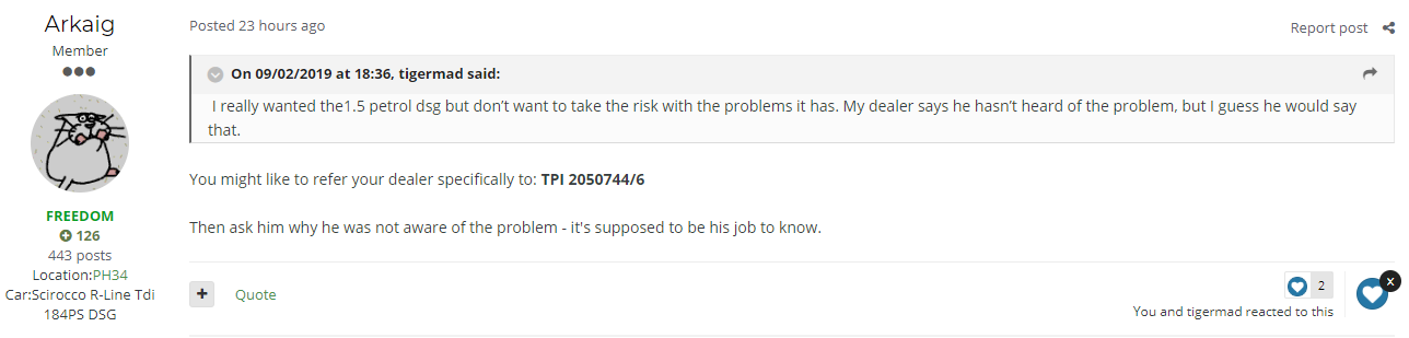

Hi, they do seem to be the same fault.
I think the German threads and tpi may be cars with a Gpf/ opf (Faults Oct 2018, no indication of car age).
The Italian one probably not (2017 golf).

So, for any dealers trying to flog you a 1.5 TSI, assuring you there are no issues, and they've certainly not heard of any, all you have to do is quote a few numbers and letters, and that should wipe the smile off their faces...

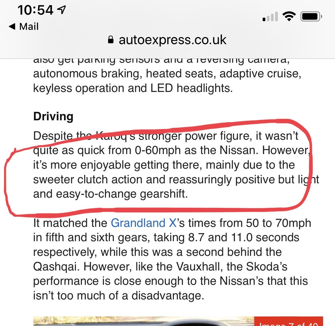

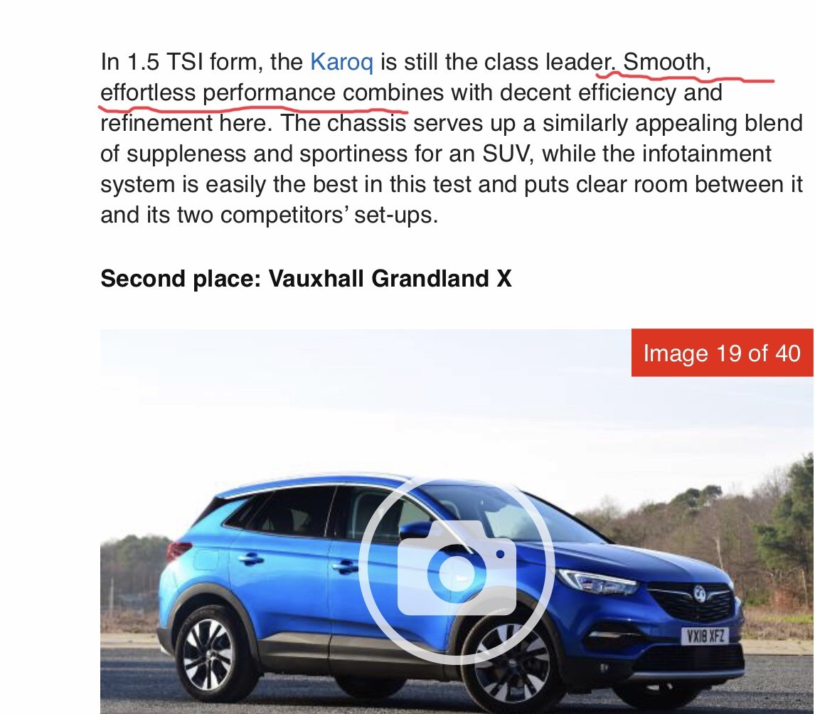

You can rely on AE for an unbiased review ?B9AD738C-95E4-4F5A-B79D-29A1FDD88D41.thumb.jpeg.f921b99f5729d6a1db316b7cc859bf38.jpeg I
Nope and they ignore all correspondence.
To be fair to AE our car is smooth for 99% of the time. Just now and then it has a little hiccup.:tongueout:
Smooth so long as you don't drive around town or at less than 50 mph :dance:
They clearly didn’t test the manual.
this IS a revue of the manual;
They will have tested pre- emissions 'tuned' models which have no 'characteristic'
The Telegraph review picked up on it's unique ability to lurch out in front of an oncoming Scania truck
