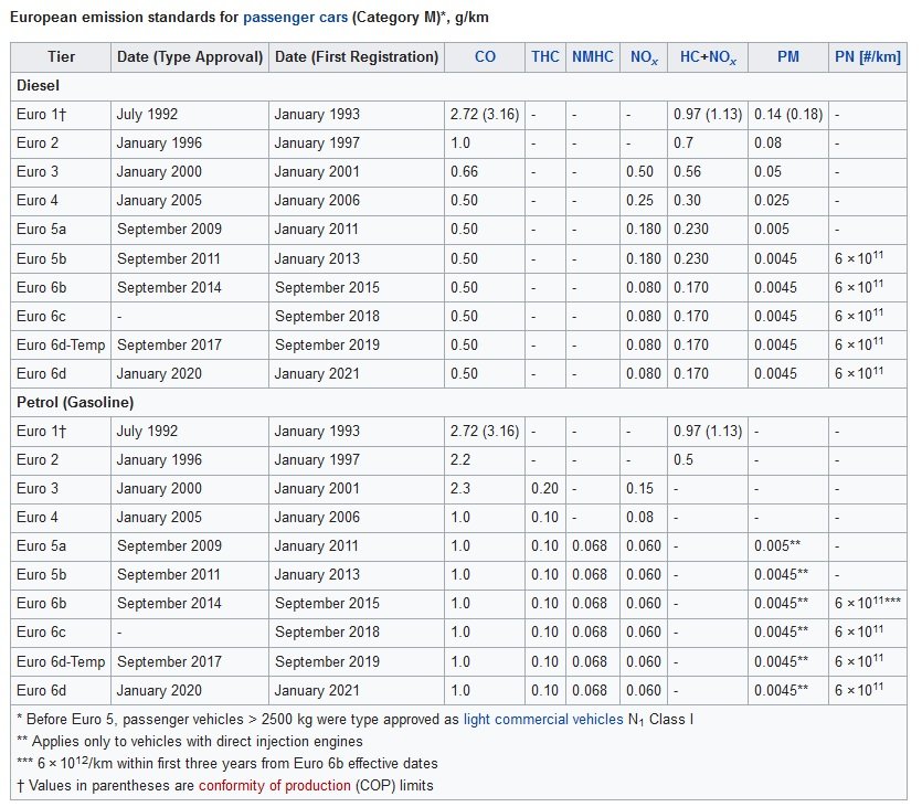

The problem is, when NOx are lowered by EGR system, this leads to increased PM particles and PN standard values. So diesels had to be fitted with DPF, but DI petrols had not that strict limits, so nobody cared until recent few years ... Now DI petrols must have GPF / OPF filters mounted on exhausts as diesels have their DPF.
https://en.wikipedia.org/wiki/European_emission_standards#Emission_standards_for_passenger_cars
So I can imagine, that latest EA211 EVO 1.5 TSI engines push their NOx values to the lowest limits as all DI petrols must do, which means high valve overlap (internal EGR) must be applied when possible. So this could be the root cause for the jerking engine, especially when cold, but same can happen when warm. I am sure that WLTP test plays here the role too, NEDC test could hide something as did on EA189 diesels ...

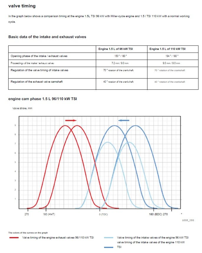

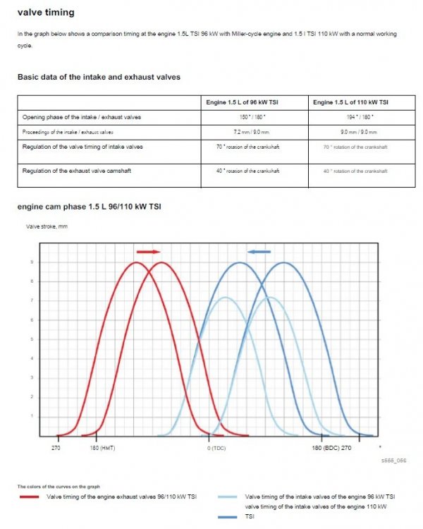

There is an interesting idea posted by someone on the T-Roc forum, I am not sure whether he is present on this one as well. I find this post has a strong logic behind it and, if proven to be true, not very encouraging for all sufferes out here.
https://www.trocforums.co.uk/viewtopic.php?f=8&t=266&start=390#p7018
Quote:
"The 1.5 TSi uses a miller cycle motor, the engine was designed to provide the economy and torque of a Diesel engine from a petrol engine. Simply put, on the combustion stroke, the inlet valve is opened to increase capacity, but opening the inlet value would cause loss of compression and car would stall. They get around this by spinning up the turbo to create back pressure to keep the compression during combustion. Problem with the manual is when you pull away the revs drop, the drop in revs causes the turbo to stop spooling, the car tries to stall, but the anti stall prevents this and the result “kangarooing” this problem is across the VAG group, Audi, Skod, Seat and VW. The challenge is that this is not an easy fix, when I rejected my car, VW Germany eventually acknowledged that there is a known problem with the manual 1.5. The only logical fix would be to electrically spool the turbo to keep it spinning at low rpm. "

The thing is that 1.5tsi 150hp version doesn't use miller cycle. Only 130hp version does.  We are here as well as in mentioned troc forum talking about 150hp version.
Uninformed tripe.
The 150ps version of the 1.5tsi runs exclusively in "Otto cycle". Trawl back through this thread to find the official vw designer statements.
absolute nonsense ... 96kW DACA engine code Miller, 110kW DADA engine code Otto, variable valve timing is not variable valve lift ...
