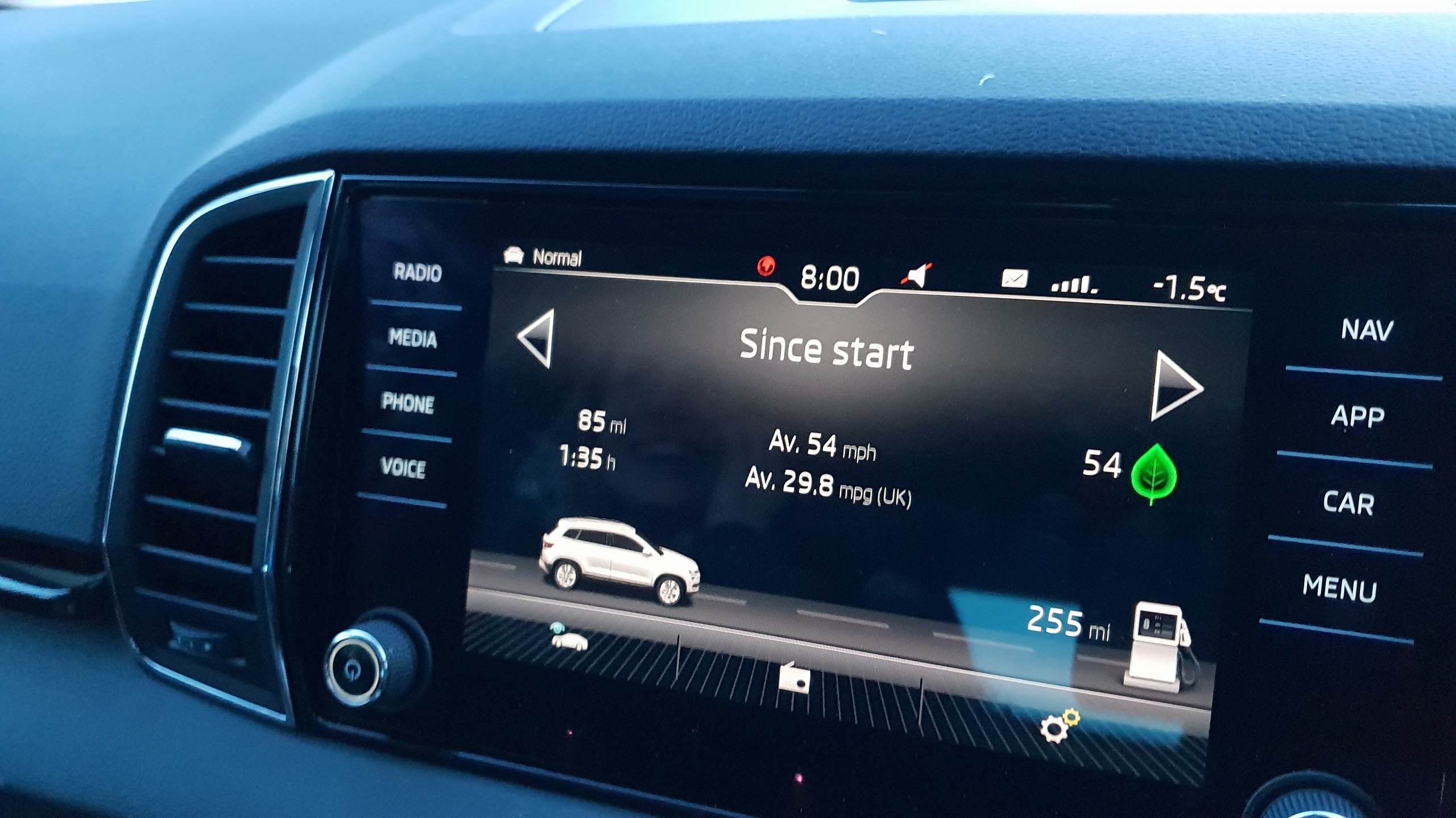

Perhaps you should have bought the more economical manual photo from yesterday after filling the wife's Karoq.
Mine was showing 40.5 mpg on the screen. I think the screen lies!

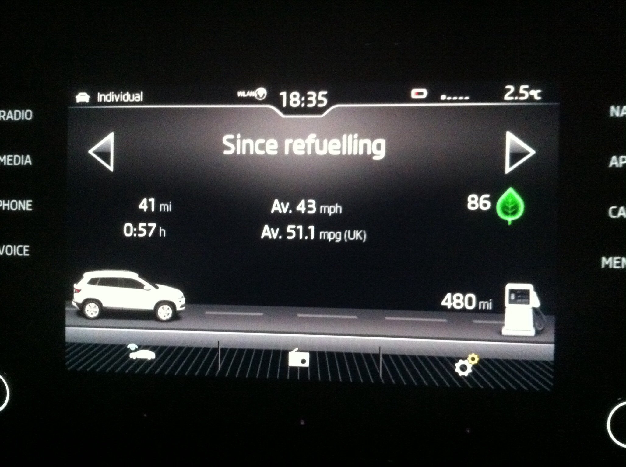

Last two fills in the wife's Karoq 375 miles 40.00 litres (8.8 gallons) at 42.61mpg and 306 miles 33.18 litres (7.30 gallons) at 41.92mpg.:thumbup:

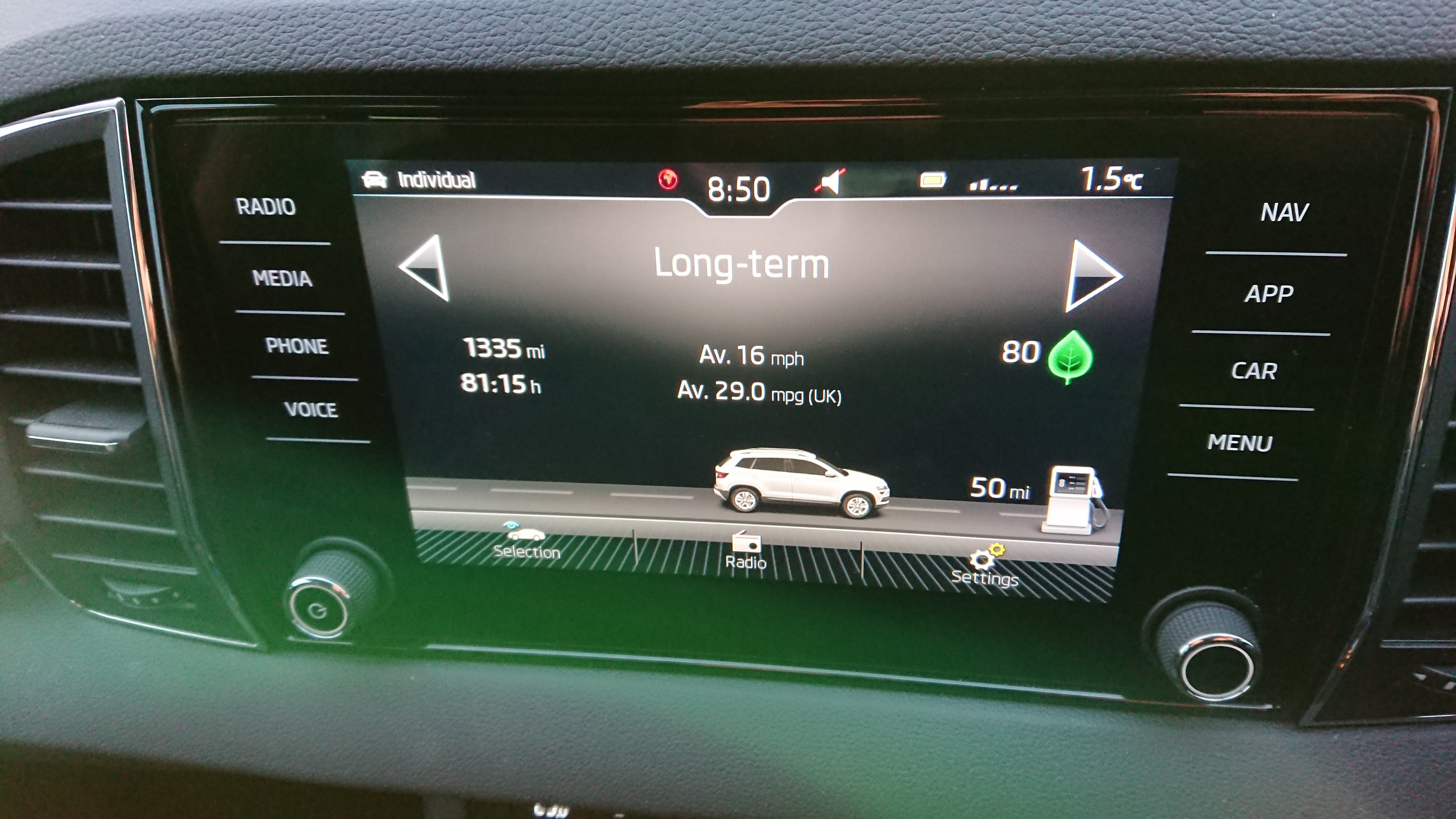

Mine not good either. Just town driving since new but only 29mpg!

Wife's commute cross country between 2 towns takes 1 hour each way to cover 26 miles each way, hence her 41-42mpg.:notme:

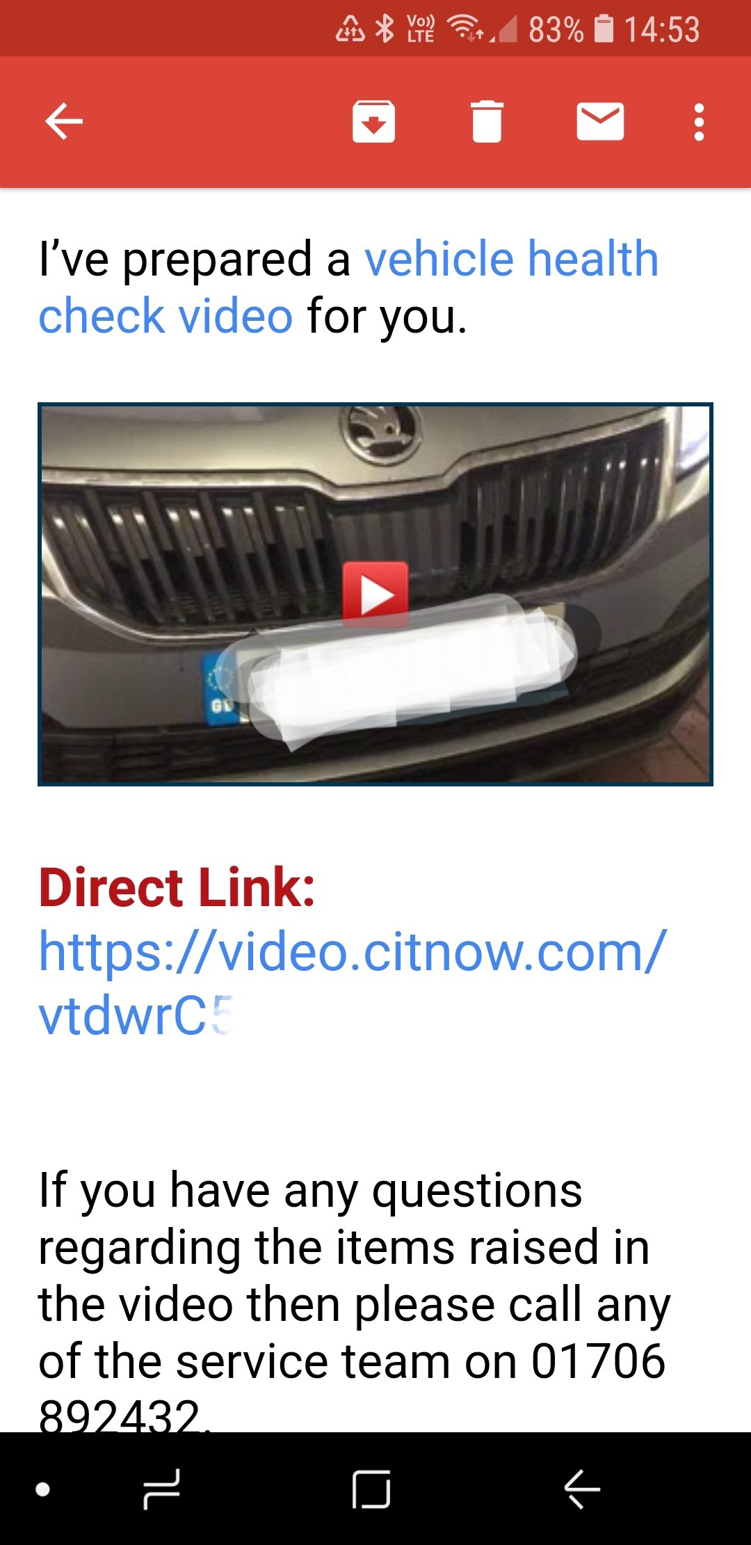

They said pretty much the same to me. Did they email you a YouTube link talking about your car?
What link is that exactly? What do you mean?
Yes, quite cool really..... mine showing the streak my faulty wiper was leaving!

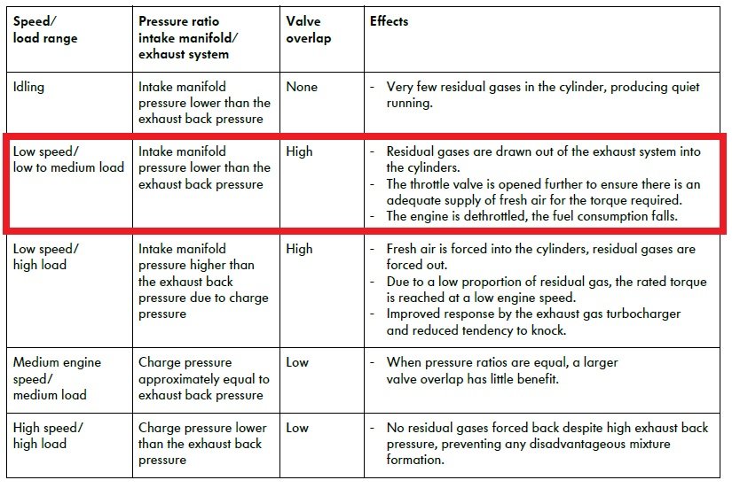

On 12/01/2019 at 10:30, rayx said:
I guess it has to do something with Camshaft Adjustment of both shafts (intake and exhaust), which is used for internal EGR too :cool: As petrol direct injection engine it surely produces a lot of NOx, to fight it, manufacturer use internal EGR in way of valves overlap.
This might explain bit more what could be the root cause of this kangaroo mystery :cool:
Used to lower NOx values as major task of valve overlap, increased production of PM particles is now managed by the GPF/OPF filter ...
taken from pre EVO engines same EA211 family
