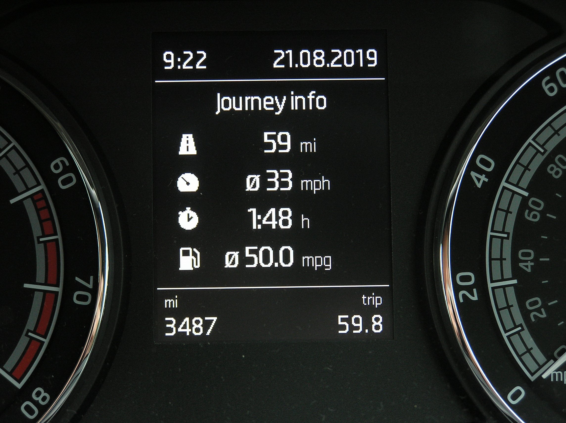

Having driven 1700+ miles since the update for "hesitation"/lack of throttle power at low revs in 2nd gear in my MY19 Karoq it hasn't occured since thank goodness.
The Karoq didn't have the cold start K'roo problem although briefly had some Joey hops post update for a few days then no more, ECU learning process?
Yesterday's return trip to a hospital appointment gave good mpg which I have found can drop to 43mpg on heavier use of the right foot and delayed upchanges of gear.
