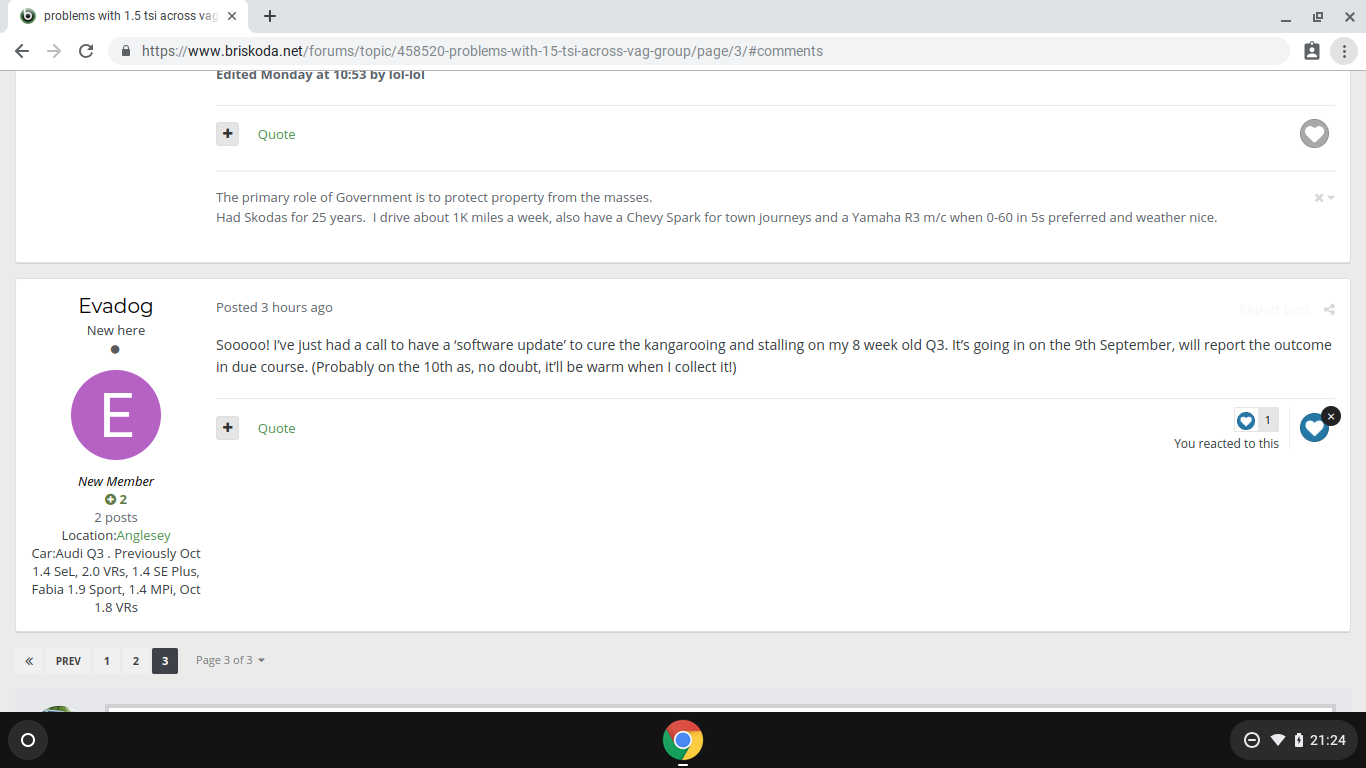

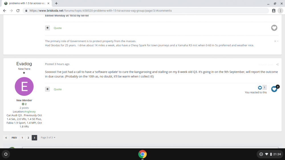

What IS going on??? 😧 Oh for some investigative journalism.
Today in the General Automotive Section.
An 8 week old Audi Q3.
Vorsprung Durch Technik. No chance.

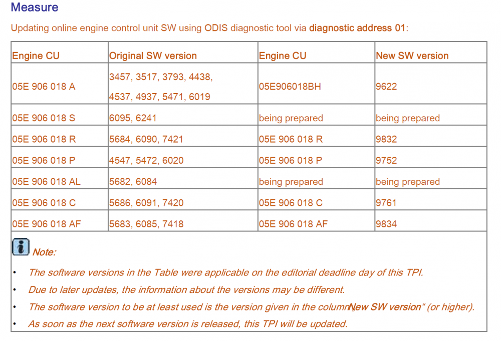

just had a call from my lease company saying the 2nd update is available to sort the kangaroo effect......I'll keep you updated,  considering the last update sorted my power loss I have high hopes
From what date was your last update?
It was update for this table or earlier?
